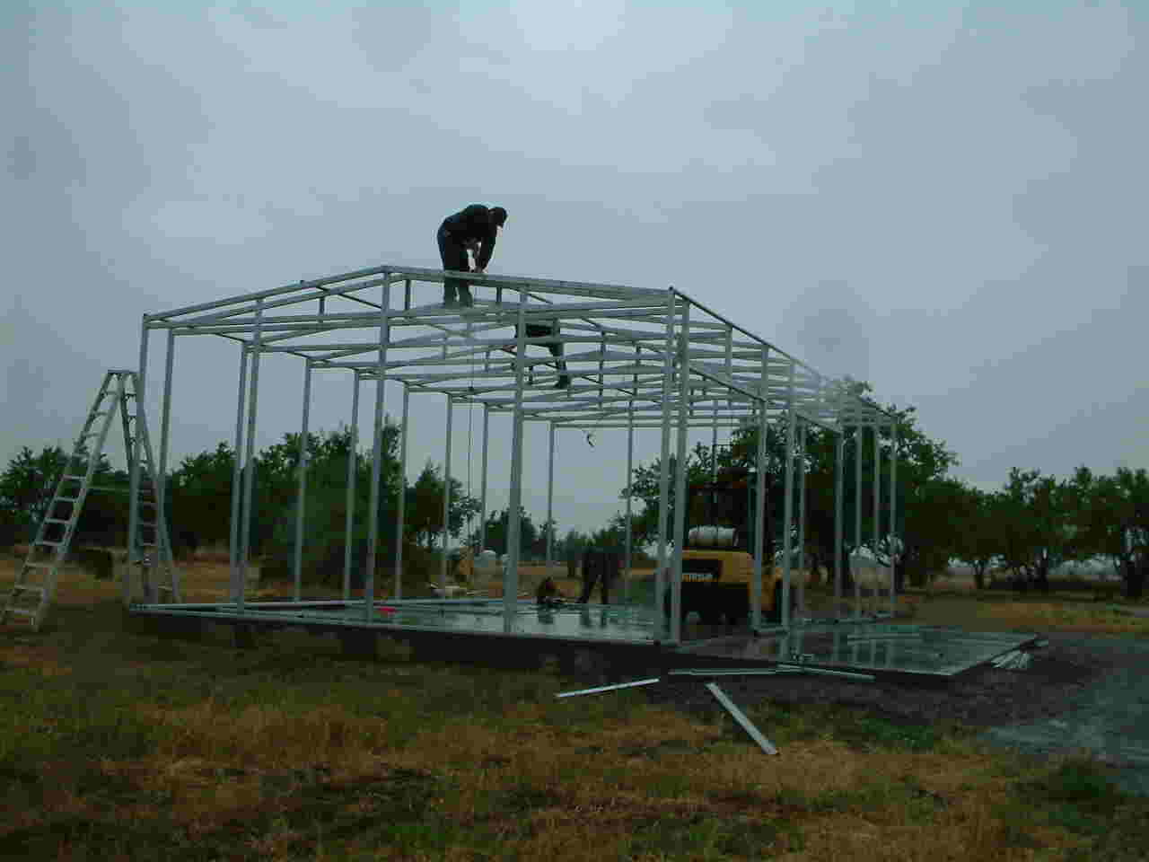

schmism said:
ruhroh... safty police are going to ALL over your butt for that last one :D
Something like that happened when I had my garage/shop built in Jun05.
It was raining pretty hard when those guys were on the trusses.
Thought one of them would take a header for sure, but nobody got hurt.

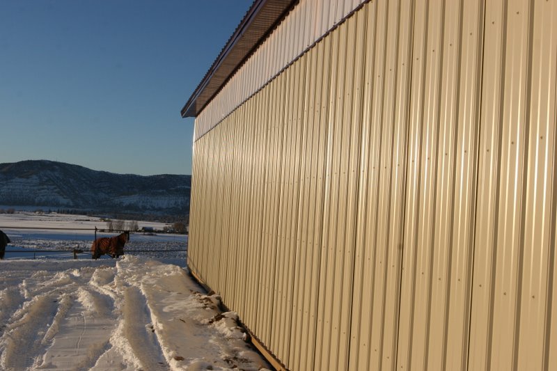

Well, the barn is officially finished. There are two skylights that weren't in the original delivery and they should be installed next week. The holes for them are located in the lean-to overhang so the actual barn is sealed tight. And just in time as this morning we are getting the first part of a three day storm that is bringing lots of the white stuff.
I still have to do a lot of exterior and interior finish grading before I can get the horses in the barn area. The automatic waterer and the inside frost-free also still need to be installed. I will be able to work in the inside cleanup during the storm, but the outside will have to wait for next week.
This really isn't the time of year to build a barn!

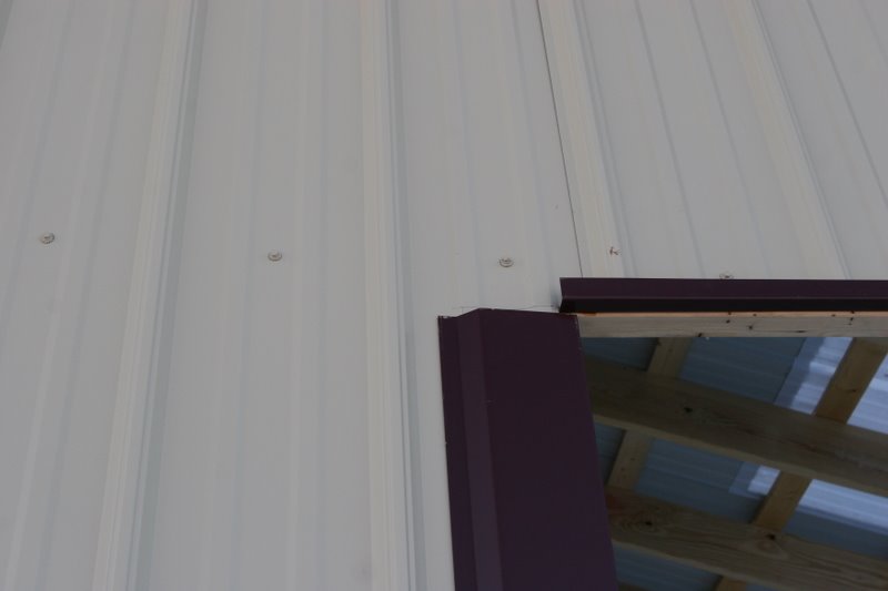

What a nightmare!

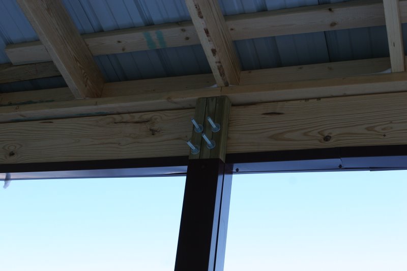

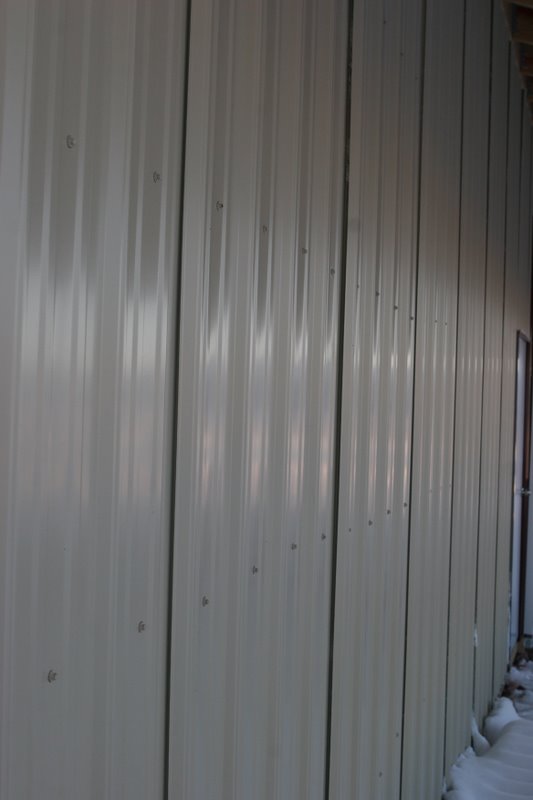

Late last week I got home and immediately went to inspect the work the contractors did on the barn. Seems the crew finished up and went home. I called the company that provided the materials, who is also the general on the job, and the owner drove the 275 miles for an inspection. When he walked around the barn, all he said was "..this is total s*it!..."

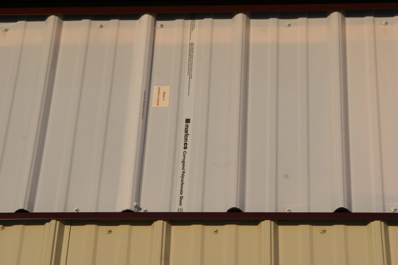

There were some major issues, the biggest of which is that the metal panels are all overlapped backwards; apparently there is only one side that is designed to overlap an adjacent panel correctly to make a solid seal and keep out wind and water. Here are some pics of the panel overlap. You can see the seams are not sitting flat against the other panels.
Issues continued in next message...

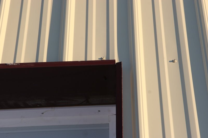

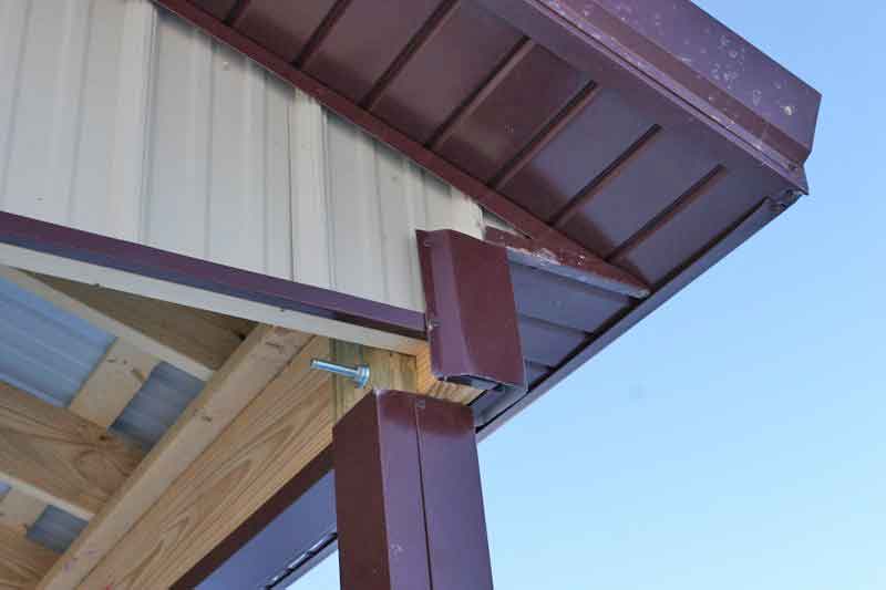

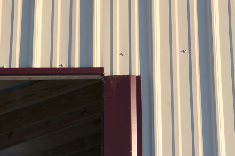

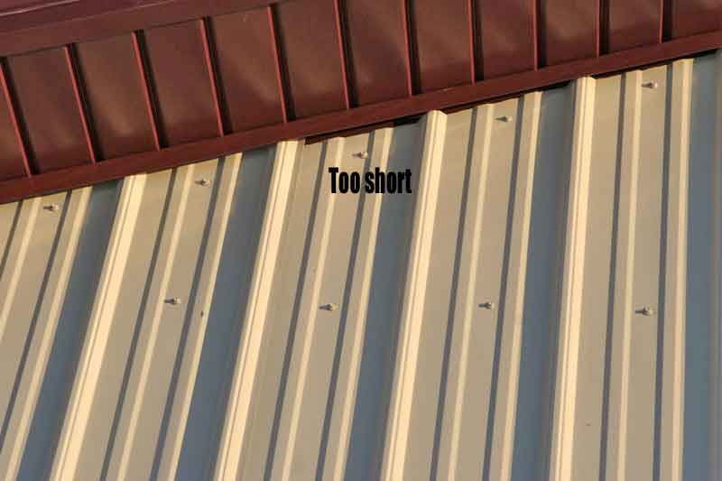

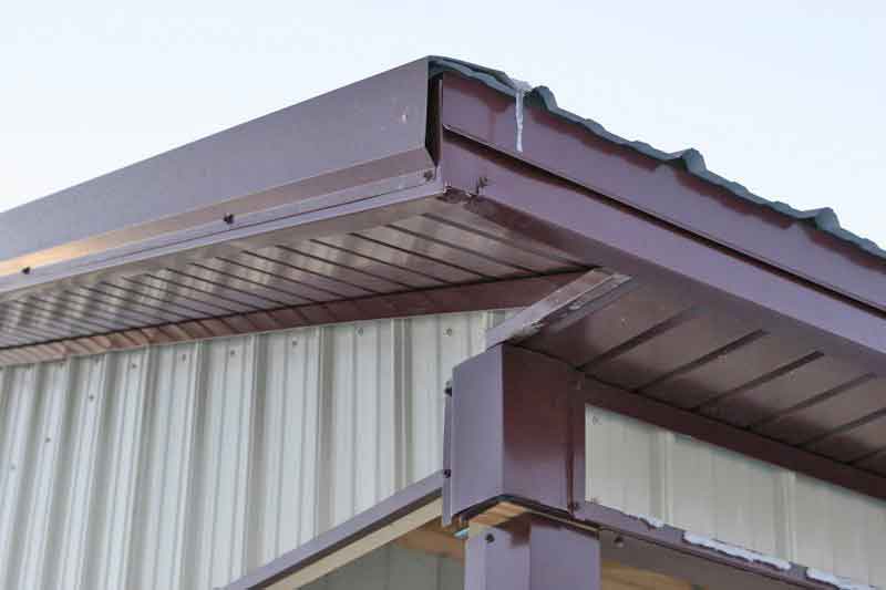

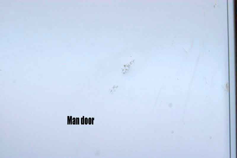

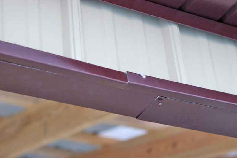

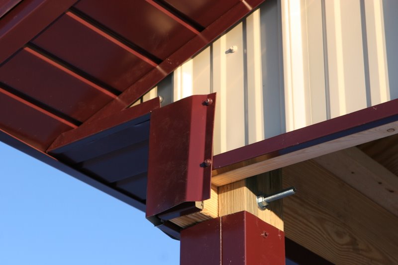

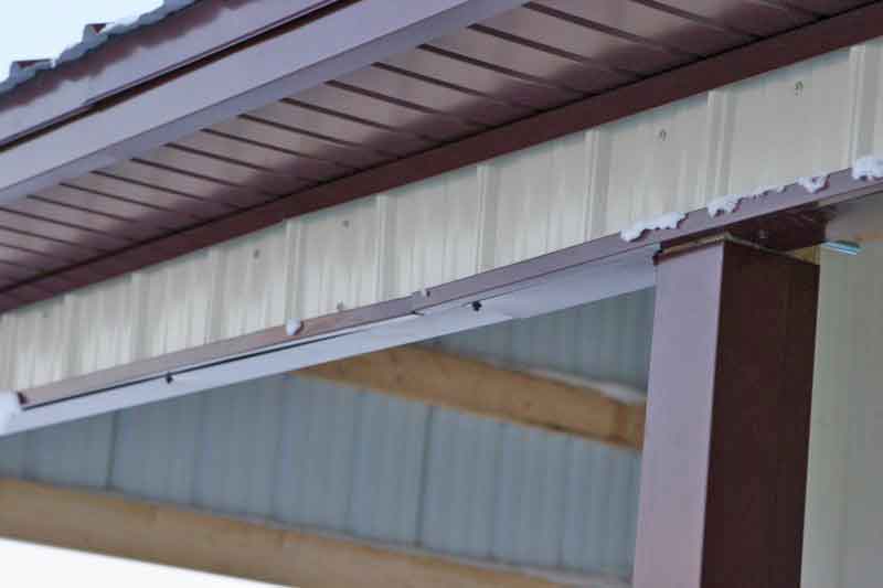

The trim job is terrible. At every opening, the top trim doesn't extend over the side trim and leaves an opening at the top of the side trim for water, etc. The corner trim is just not wrapped well, and the ridge cap is crooked and doesn't cover correctly. Some trim areas don't even have any screws!
One entire side of the barn doesn't have the foam/rubber seal where the wall top plate meets the roof, leaving an opening. At least three roof panels have cuts in them, the man-door has a dent, beam bolts were not cut back, and they left the plastic protection covering on the wall skylight panels.
The gable end panels don't go all the way to the top in three places and the bottom of the panels doesn't line up with the side wall bottom at the corners.
The owner of the company I purchased from and who hired the sub who did the construction is very, very upset. Fortunately, he is also a very upstanding guy that has said he is going to make it right.
Next week he is coming personally with a crew to remove ALL the wall metal panels and replace them with new material. He will also remove the roof that is above the lean-to section which is where the damaged sections are located. A new door, and all new trim are also part of the repair process.
This is the first project for the sub that did the work, and now its the last.
