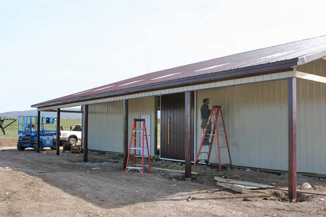

Eddie, I did get a call from the sub a few days after the GC came and saw the problems. Apparently the GC sent a letter to the sub that upset him, probably suggesting he wasn't getting paid. It was a short conversation during which he asked if I was unhappy with the work. I cut the conversation short and told him he would have to take it up with the GC. I did take the time to tell him that the GC and I inspected the work together, and that the GC pointed out and made a long written list of problems with his work. That reminds me, I want to ask the GC for a photocopy of his handwritten list!:cool: I intentionally didn't discuss specifics because I wanted to avoid anything that would suggest that he had any relationship with me or that I supervised or controlled his work.
The same guy did the entire project. Before being hired by the GC for this (his first) barn project, he was a framing contractor for another company.
Today I'll really push for getting the written documentation form the GC. The items I'll ask for are:
  • Copy of the punch list made at the site
  • His written commitment to make it right, with details of the work to be done
  • His written commitment to bond the lien
  • A time frame for completion
Is there anything else I need to document at this point? I'll add my photos and detailed comments about the issue to the file as well.

Wow, I am so sorry for what they did. Even an amatuer like me knows the proper way to overlap the metal. It's shown in all the documentation. Also, I normally don't see screws in the middle of the sections, normally you stick to the 9" pattern.

Rox, the draws were set up with a small initial payment, a large payment on delivery of materials to the site, another payment upon completion of the framing and a final payment. I made the framing payment shortly after the GC visited and and looked at the job. I know he paid the sub at that time because they both thanked me for my prompt payment. Rox, Tomorrow I'm going to check to see if there is anything I can file in response to the Notice of Intent. Thanks for the comments.
The GC has responded to my request for written confirmation of the details of the issue involved and the specific fixes he intends to make, and says he will have them to me tomorrow. In the meantime, I spent today with Sandi cleaning up all the trash and construction mess from inside the barn. I have photos, but I had to clean it up in order to do some floor re-grading and fill the trench for the power and water. We found even more minor stuff like lack of screws and poorly trimmed areas. Hopefully he will get here to begin the fixes before we get any more significant snow. It's been really comfortabe recently, hi 21-31, lows 0-9.
