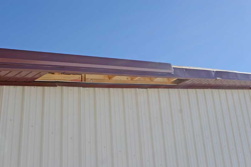

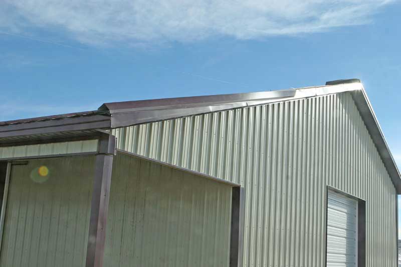

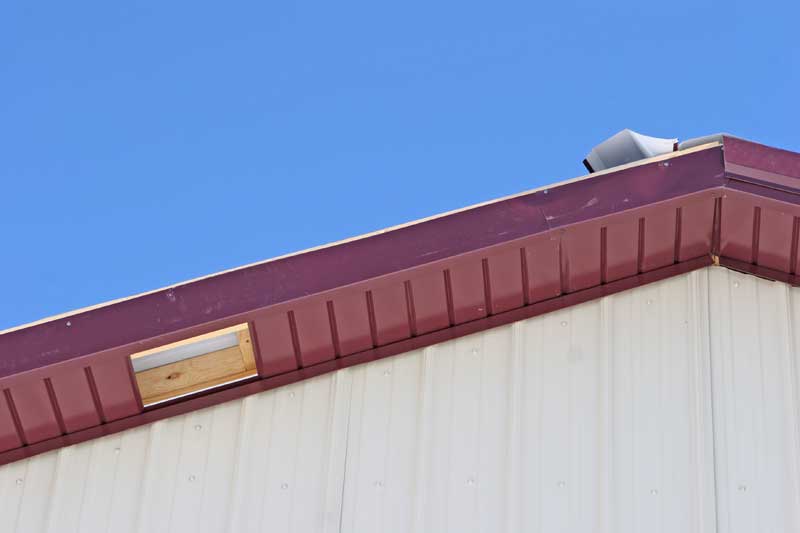

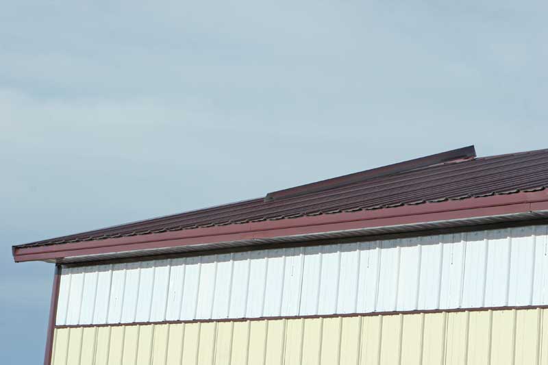

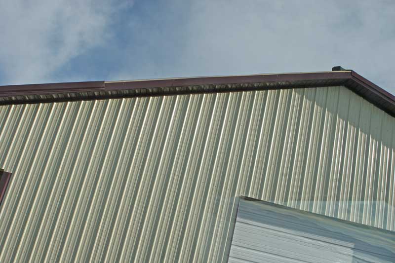

Update. Still no firm date for the repairs, and the weather is causing damage to the poorly installed metal. I sent these pics to the GC today and asked him when the new metal would be ready and the repairs completed. We'll see what he says.
As you can see, the trim is folded bacl due to the 35mph winds we had the other day.

   / It's too cold to build a barn, but we're doing it anyway! #52
This is terrible and NO kudos to your GC. I think he sucks, too. If he is so concern about this, he should roll up HIS sleeves and fix what he screwed up. ...... He hired those idiots, so from my perspective, he screwed up.

Repairs are now set for mid-March, a timeframe that should avoid the worst of the winter weather here, except for the occasional snowfall. I'm OK with the date.

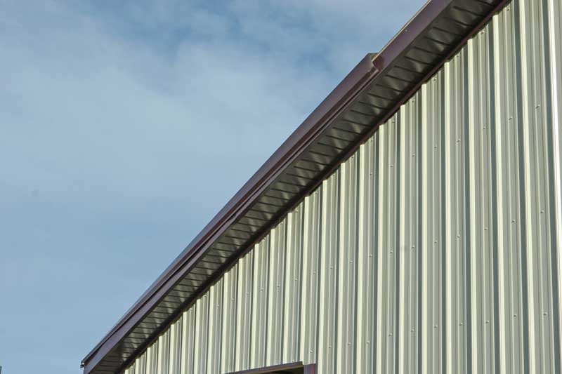

The wind is taking a toll on the poor barn. The other day we had a lot of wind and some of the soffit panels came out and were blown into the horse pen; Sandi wasn't a very happy camper. We've moved the horses far enough away from the barn that they should be safe from flying debris.

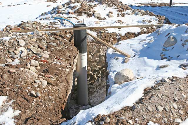

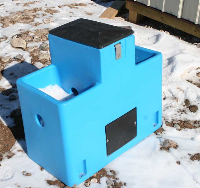

I've also attached a few photos of the horse waterer project. The waterer itself will be just outside the barn, bisected by a fence so the mares can use one side and the geldings and colt can use the other. It is a geo-thermal heated waterer with an additional bowl heater on electric from the barn. I still have to backfill, build the pad for the waterer and set it in place.

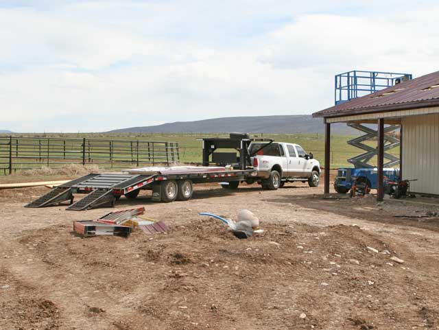

Guess what showed up yesterday? My general contractor arrived with a scissor lift, various lumber, compressor, generator, huge toolbox and a complete package of replacement metal skin for the barn! :D He brought his partner in the business and the two of them began doing the work themselves :eek:.
After the first day they had already removed the roof, reinstalled the metal over the trusses correctly and were working on correcting the 'bump' created by incorrect joining of the 10' overhang to the truss section. They expect to be completely finished before Easter Sunday.

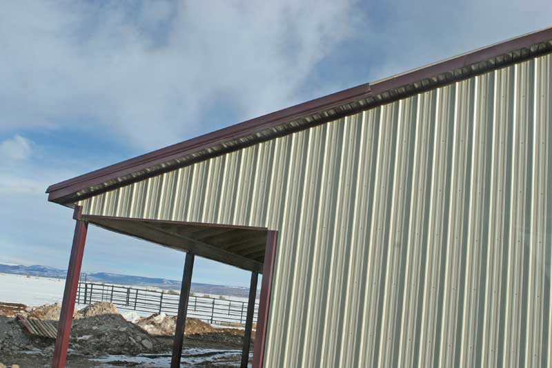

In the first pic you can see the base for the automatic horse waterer, which is just about ready to be installed. In the second pic you can see the 'bump' :eek:. Either the ledger board at the truss seat is too high or (more likely) the post wall at the end of the overhang is too low. Raising the wall height shouldn't be too much of a problem.
I get to keep the existing metal skin to use on other projects :cool:. I'll post additional pics as the work progresses.
