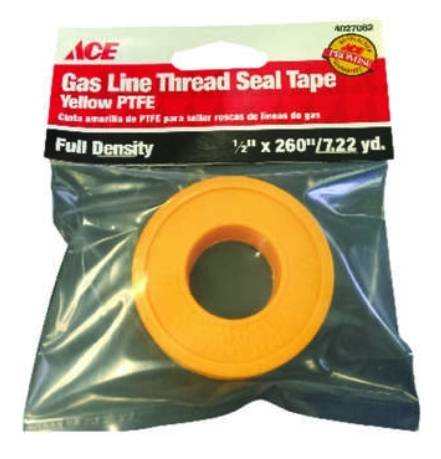

Turn it off take it apart tape it and dope it. These guys are making a huge project out of this. I have done industrial hvac for 25 years I would send a first year kid to fix that leak in a heartbeat unless it’s a thousand foot line your going to lose at most a few bucks of gas

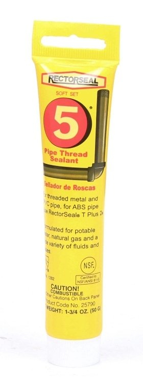

To me, a close up of the union looks boogered anyway where arrow points to. Thread sealant mentioned is a good idea.

I think I need some of that Rectumseal for my gas leak!

As a master gas fitter of 40 yrs. I would take it apart and make the proper repairs with a thread lube listed for propane / nat gas. I have never used tape. Just never personally liked the stuff.
