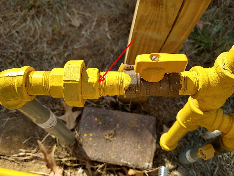

I have a very minor leak at the point of the red arrow. Just barely bubbles with leak liquid. Odor is very faint. Supply line/tank is to the right of the picture. This is the high pressure side before the second stage regulator feeding the house.
Obviously, the best way is to tighten that coupling, but that means breaking the union which means shutting the gas off and letting air in the line which will need to be purged. If JB Quick, Steel Stick or some similar fast setting epoxy type product will seal it, I could avoid all of that. Fittings are 3/4" Black Iron Pipe ( once I wire brush the pain off ). But even if they seal initially, will they hold up to LP over time?
I count 5 visible threads at the red arrow where you say it is leaking vs 4 on the other side. Was this cross threaded when it was first installed or do you think it is isn't cross theaded, but it didn't get tightened enough for some reason? Did you use pipe sealant rated for propane on all the fittings for the entire line?

Prrsonally, id just crack the union and try to tighten the union fitting to nipple first, then retighten union. Wouldnt even need to bleed it off. would not hurt to try.

Fix it right and get the whole system inspected and certified.

There's "no"s and there's "no )&$)*&%)@*(&^ way". JB weld is the latter in this particular instance.
As others have said, the cost and time involved in doing this correctly are nothing compared to the potential damage from doing it the wrong way.
