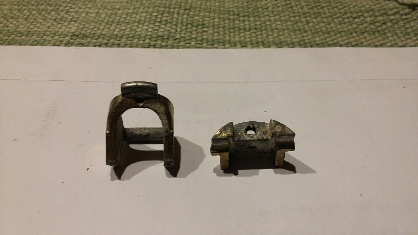

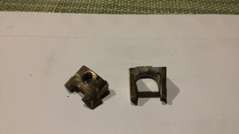

#26
If the pictures come through, this is the culprit

Well guys, first time it's a failure. Came apart when trying to test faucet. Back to the shop, mixed another batch paying more attention to portions and tried again. This time I spread some on the sides of part to get more contact area. I'll wait a couple hours and try again..

Just curious...did the epoxy itself separate in the fail or did it separate from one or the other surfaces?
Also, any chance you can show pictures of the handle and the bond you were trying to make?

The two pieces I posted in #26 just separated. No strength at all.
It wasn't the handle that broke, it was a separate piece that made the connection between the handle and cartridge stem
/ JB Weld #40
They do make a few different versions I think for different repairs but remember it is really just a modified epoxy and as such if epoxy wasn't going to work then this wouldn't be much better. Looking at the piece that broke (which looks to be subject to stress) I had serious doubts it was going to work. Not a lot of glue surface there.
