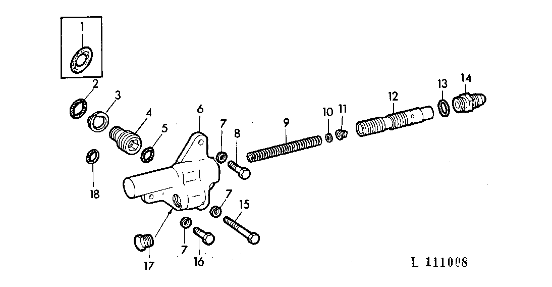

Hi,
I got the O-rings for the oil flow control valve.... So if I remove the three screews (8,15 and 16 from the photo), and I change the O-rings, replace the screews and the job is made with it_?! Is there any possibility to fall of any other pieces as the 3,4 from the photo?!
   / JD 1020 power steering #123
Any place there's an o-ring there's a n opportunity for an oil leak.
   / JD 1020 power steering #124
Hi,
If you are asking if 3 & 4 could FALL during removal of the valve, no, they are screwed into the transmission case.
#125
Thanks for your advice....
So I remove the three screws.......... I put the new O-rings to their places, screw in the screewa and I hove the oil leaking will stop....
   / JD 1020 power steering #126
YES! New o rings should fix the leak. If not, look for something like a crack or pin hole in the valve body.

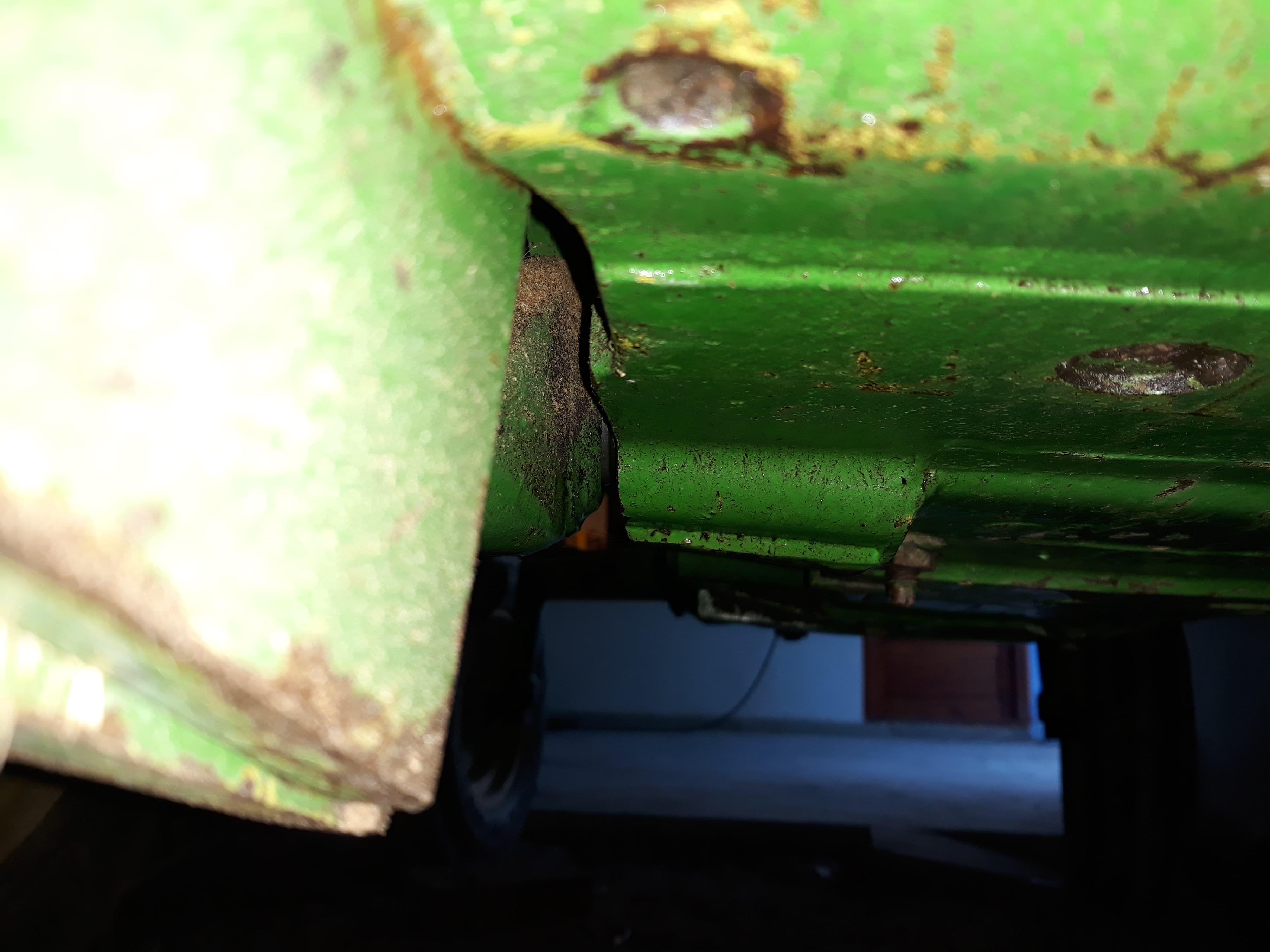

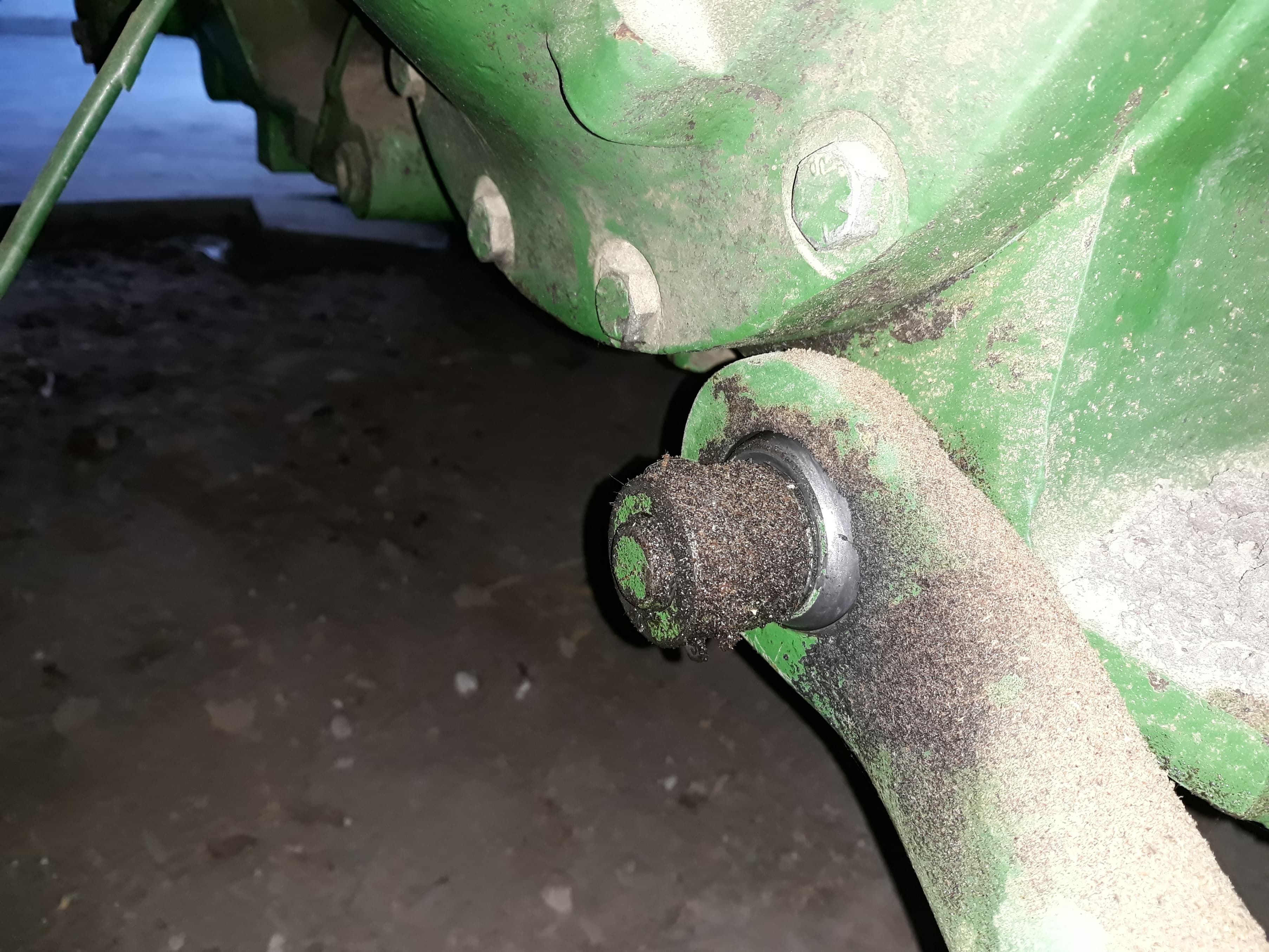

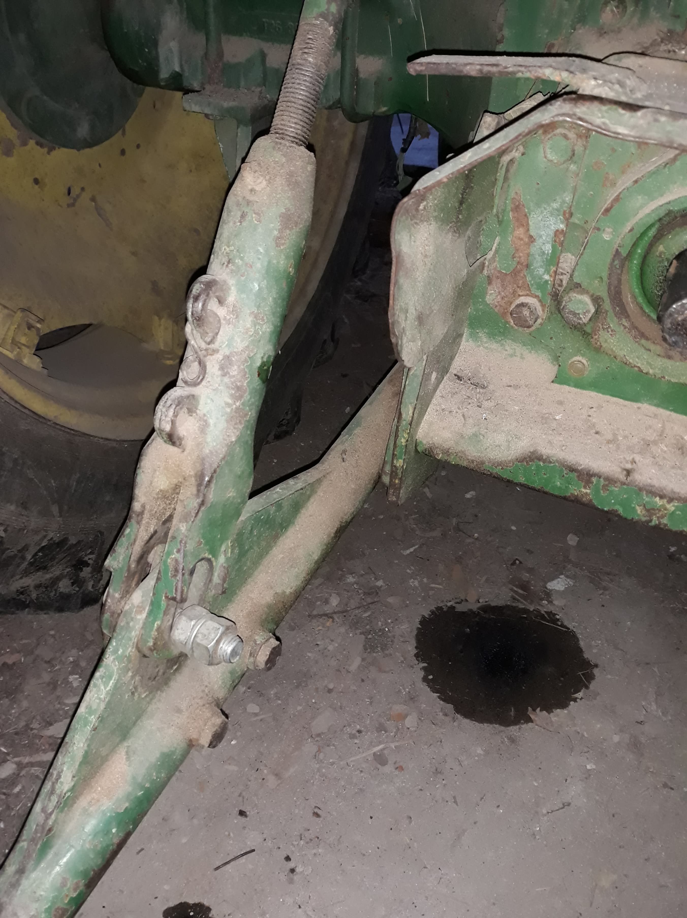

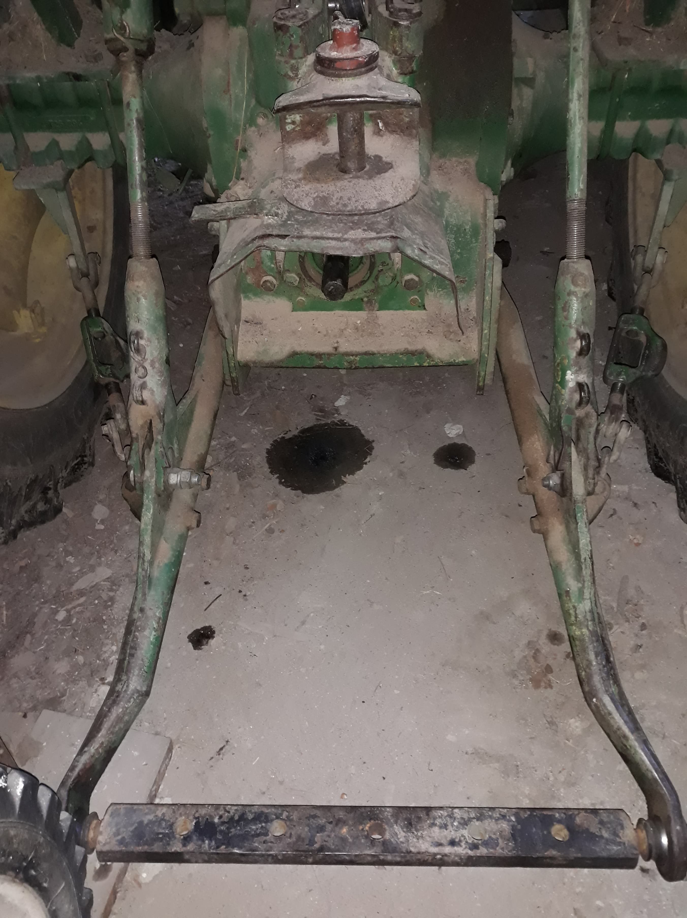

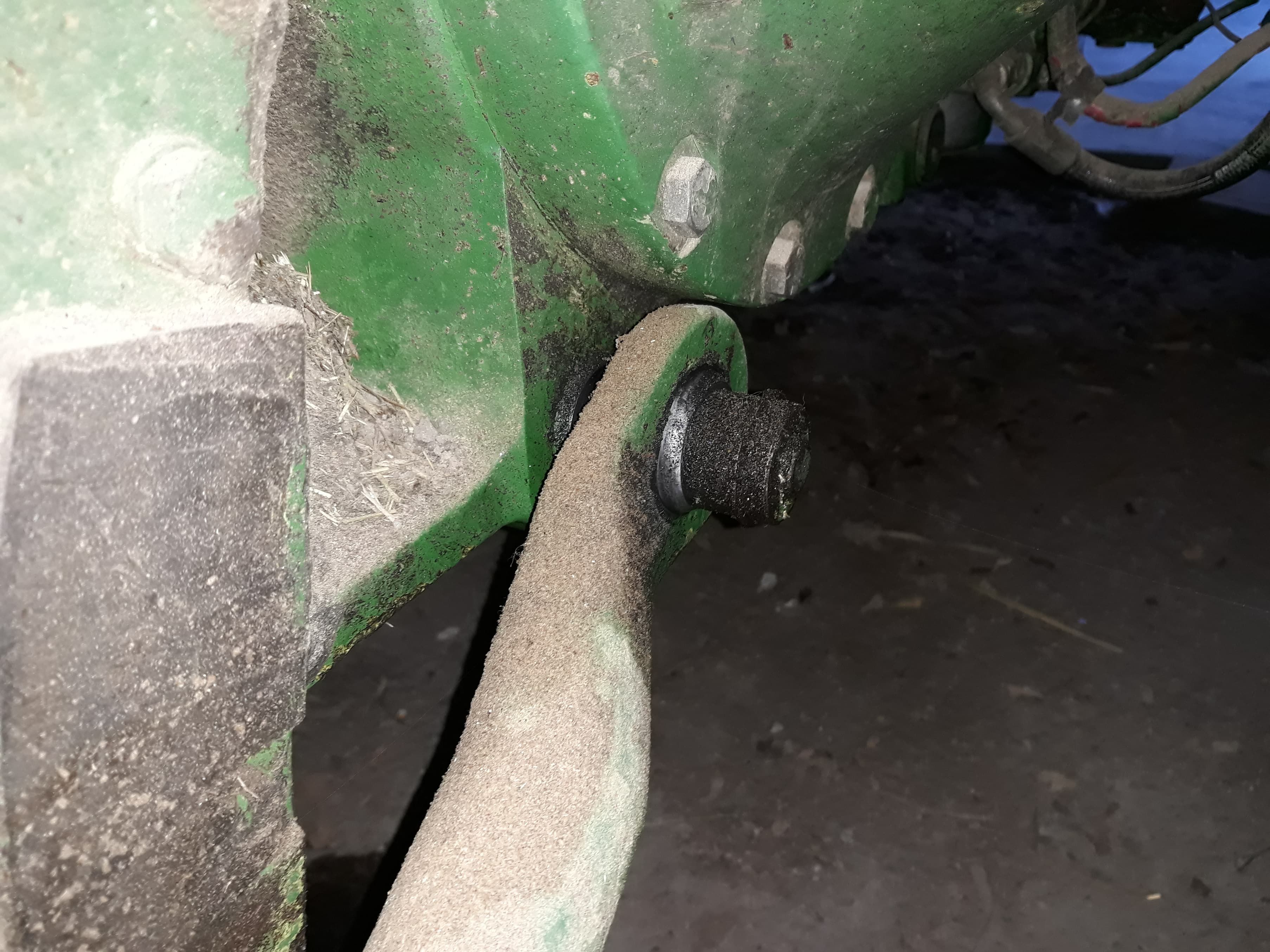

#130
Hello, Jim, thanks for your answer...
My problem is that there is a hydraulic oil leak... in the back downstairs at the suspension of the 3-point... as you can see on the attached photos...
More exactly - at the joint of the shafts.... One of the axle is to blab out...
What could be done? How could I sealed and stop the leaking of the oil? I dont really understand how the shafts are inserted in???!! I cant see nothing from outside / screws or others....
Lot of thanks, J. Benedek, JD 1020 owner
