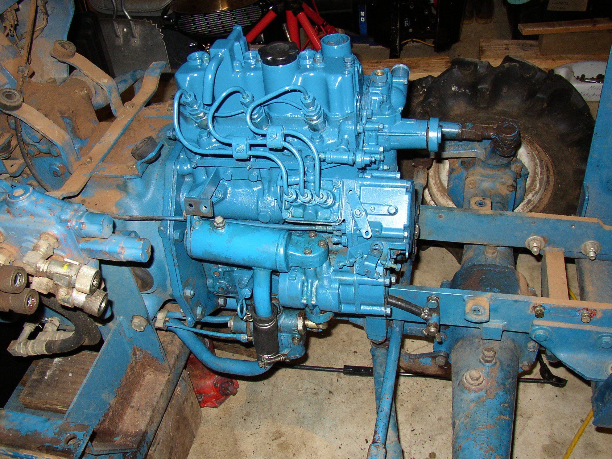

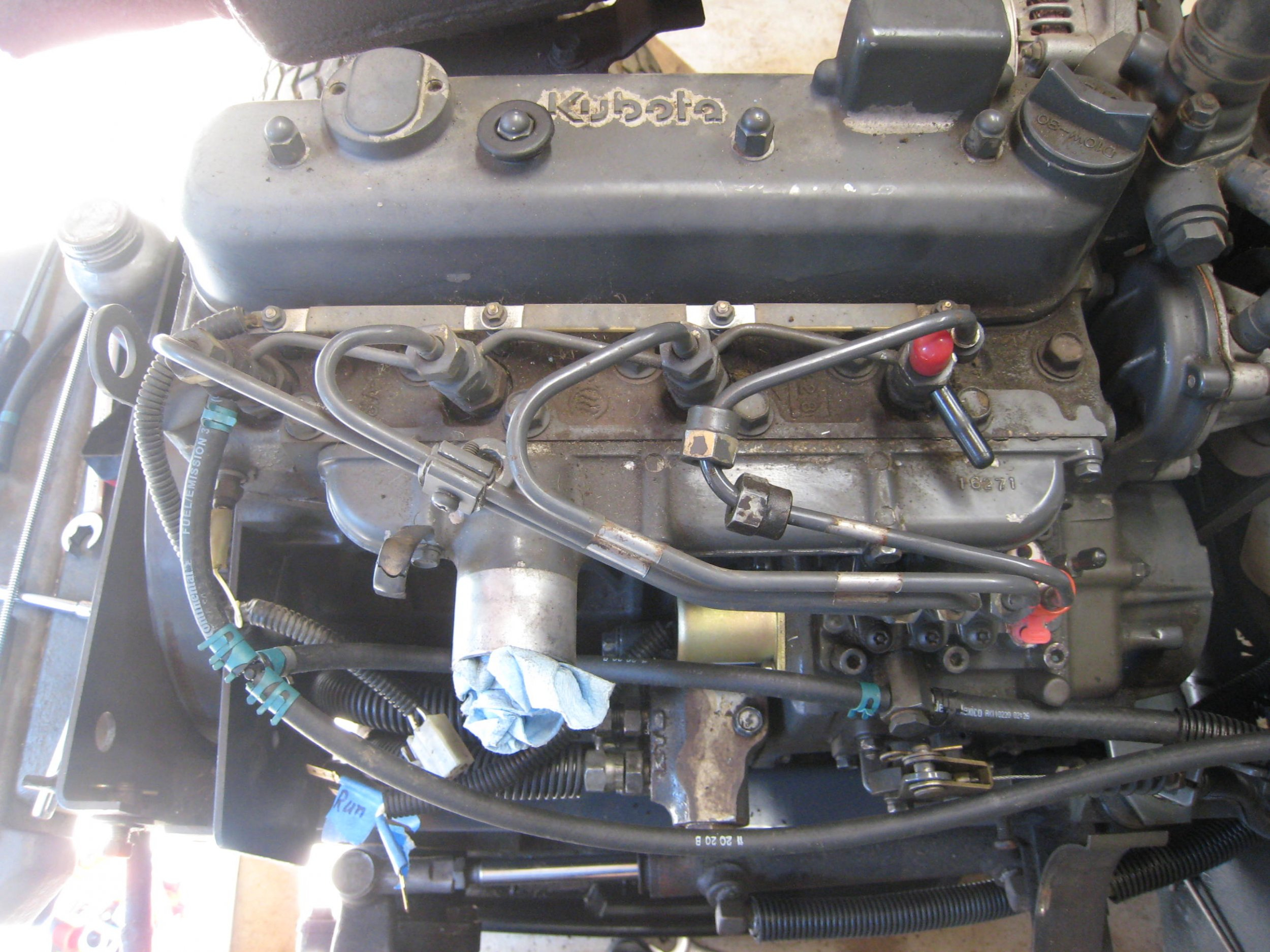

I am not familiar with 1980 - 1989 JD 1050 other than looked at the specs, but it's no big deal to remove & reinstall injectors, if the injection system is similar to my Ford & Kubota shown in photos below.
If you have the proper tools just follow the instructions in the "big" manual you already have and take them to local Diesel injection shop to be checked out & rebuilt if needed.
Depending who is doing the job, maybe up to 1 hour to remove all three of them, and up to 1.5 hrs. to reinstall?
Injection timing is not affected by injector removal & reinstall.
1986 Ford 1310
1996 Kubota F3060
Thank you. The injectors are right on top of the engine and it does look like an easy job in the tech/repair manual.
