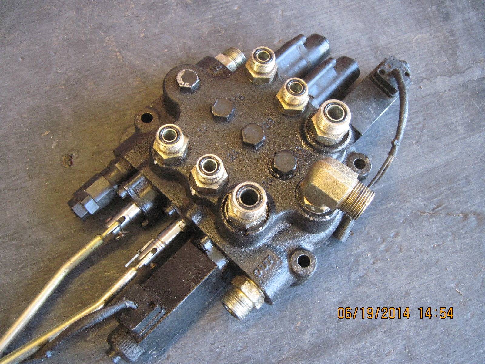

I need an illustration of the Bucket control handle linkage to the spool controller. Hand control mounting screws fell out and it was almost impossible to curl the bucket down, now that I have messed with it, it does not work at all. If someone has a manual could you send me an illustration of how the linkage connects. TY for your help. Gene
/ JD 110 TLB bucket control problems #2
110valve.jpg This is not what you are looking for is it?
Thanks Disney, do the two control rods cross over each other back to the spindle they connect too? Are there any springs on the control rod spindle?

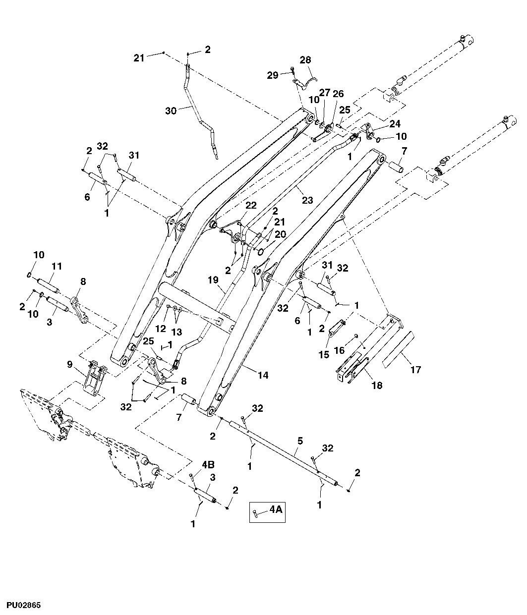

Thanks I was on JD Parts and looked at the control handle linkage for the SCV, it looks like the bell crank is 90 degrees out of where it should be, not sure how that would happen.

I set up the Bell crank as illustrated in JD parts section 70 page 139. It solved the problem. I do want to note I have never touched the linkage or bell crank since I bought it in 06. The only thing I have done is tighten the screws that hold it to the frame. The inner bell crank was installed 180 degrees out according to the drawing. I believe JD did this to get the control handle rods to connect to the bell crank, there was no way even with the mount screws out the bell crank could turn that far to the right. If you look at section 70 page 139 the left control rod connects to the single hole left of the bell crank mount pin, somehow they managed to connect it on the rt. hand side of the bell crank. Why it has worked this long without being an issue I can't say. What I can say it is now installed per the drawing and works much smoother with no binding. All functions are working as they should. Life is good today, I have my TLB back in service. Gene

After comparing parts diagrams and the machine, it looks like the bellcrank is 90 degrees out, see part # 24 in the diagram. This might explain why it would work in some positions and bind in others. It also appears that someone messed with the bracket (part #28 in diagram), I'm not sure of its exact purpose, but it looks to be a stop so that the bellcrank doesn't rotate past its stop and bind/get stuck.

I've noticed that too! I'm too embarrassed to post a photo of the bracket that was bent out of the way. I'm not sure if this was done because they didn't understand how this setup works, but it looks like it would prevent the bellcrank from spinning around and getting stuck and binding.
The loader arms on my machine need new bushings, and probably pins too, so I'm kind of wondering how the best way to do that is. The tech manual says use a gantry crane (to lift the loader arms) that I don't have, I'm thinking I might be able to use my engine cherry picker that's good for 2000 lbs to lift the arms up enough to press out the old bushes and press in new ones.
