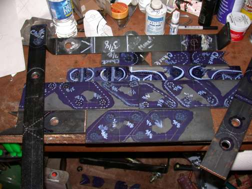

I designed the hinges and made them with 1/4" flat stock. I used 1/2" copper water pipe to get the exact spacing, so I could have the hinges made and ready to slip on. The pieces were all stack drilled to make sure they lined up after they were installed. Attached is a picture of the hinges and other project layout I have been working on.

Ron, I made the pivot center line, line up exactly with the split line of the ROPs and lowered the top of the lower brackets 1/8" to allow for a tight fit between the top and bottom sections and no interference when folding. I also added a plate and ground it off smooth to cap off the bottom fixed sections of the ROP's, it looks better and there is no chance of getting anything (like fingers) caught in the holes when it is folded down. By the way I used a 4-1/2" grinder and 3./32" cut off wheel to cut the ROPs in half this removed very little from the height of the bar.
