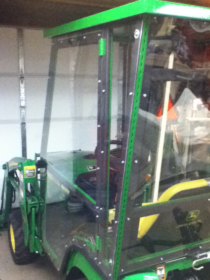

What did you use for the frame?
   / JD 2305 Homemade Cab Build
#12
I used 1"x2" box tubing from a large shelving unit. It worked out perfectly for the frame and although it has some slots in it, they don't hurt anything!
   / JD 2305 Homemade Cab Build #13
My estimated total cab cost was around $1,000-$1,200. Comparable aftermarket cab was roughly $4000. I am not a metal worker!!!! A woodworker and metal rarely mix, but I had a great time making this for my dad. As for the the attaching of the lexan, I used a 1/8 inch self adhesive foam padding in between the frame and the lexan to stop any vibration. As for fasteners I used 5/8 inch #10 Stainless Steel Self tapping screws. I pre drilled through the lexan and metal before using the self tappers. The foam padding worked perfect, however the screws have to be carefully put in to the right depth so that the lexan does not become wavy. I was concerned that screws may rip out, but that was before I had ever had any experience with lexan.
Thanks for your inquiry
God Bless,
Nathan
If it makes you feel any better, metal workers rarely do well with wood.
As for the waviness with lexan, I've found that a flat washer sized to be very close to the foam gasket thickness, give the screw something to tighten to, with out excessive warp.
