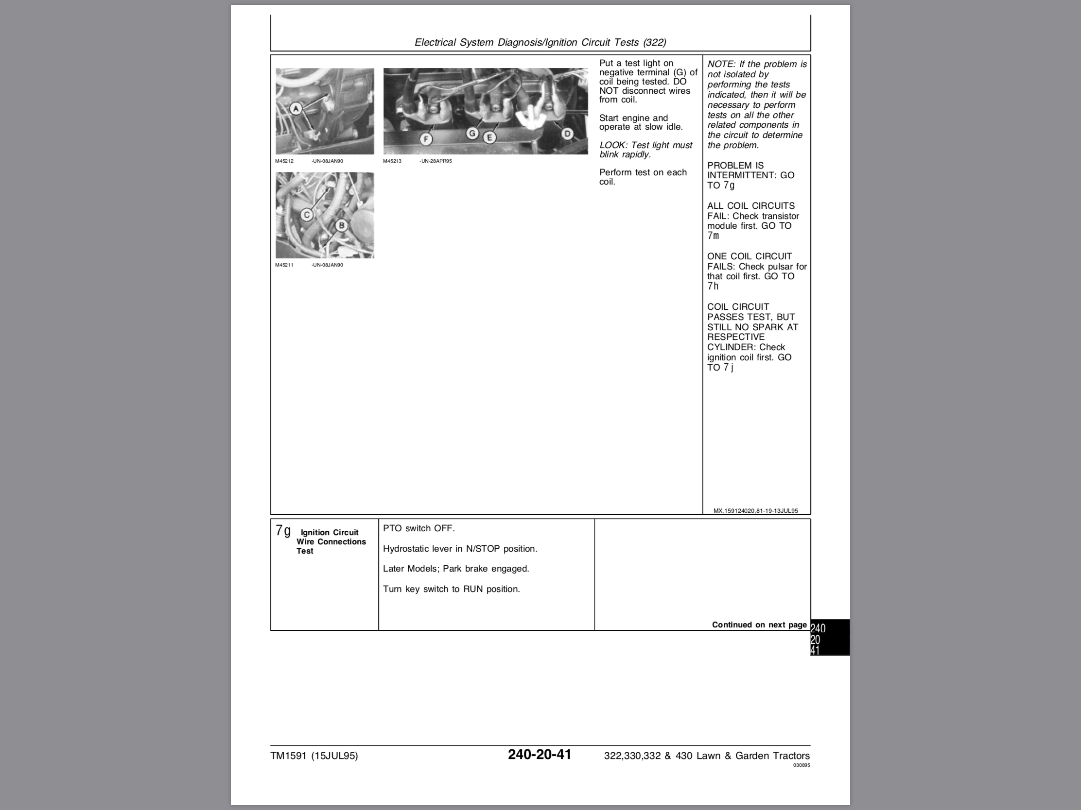

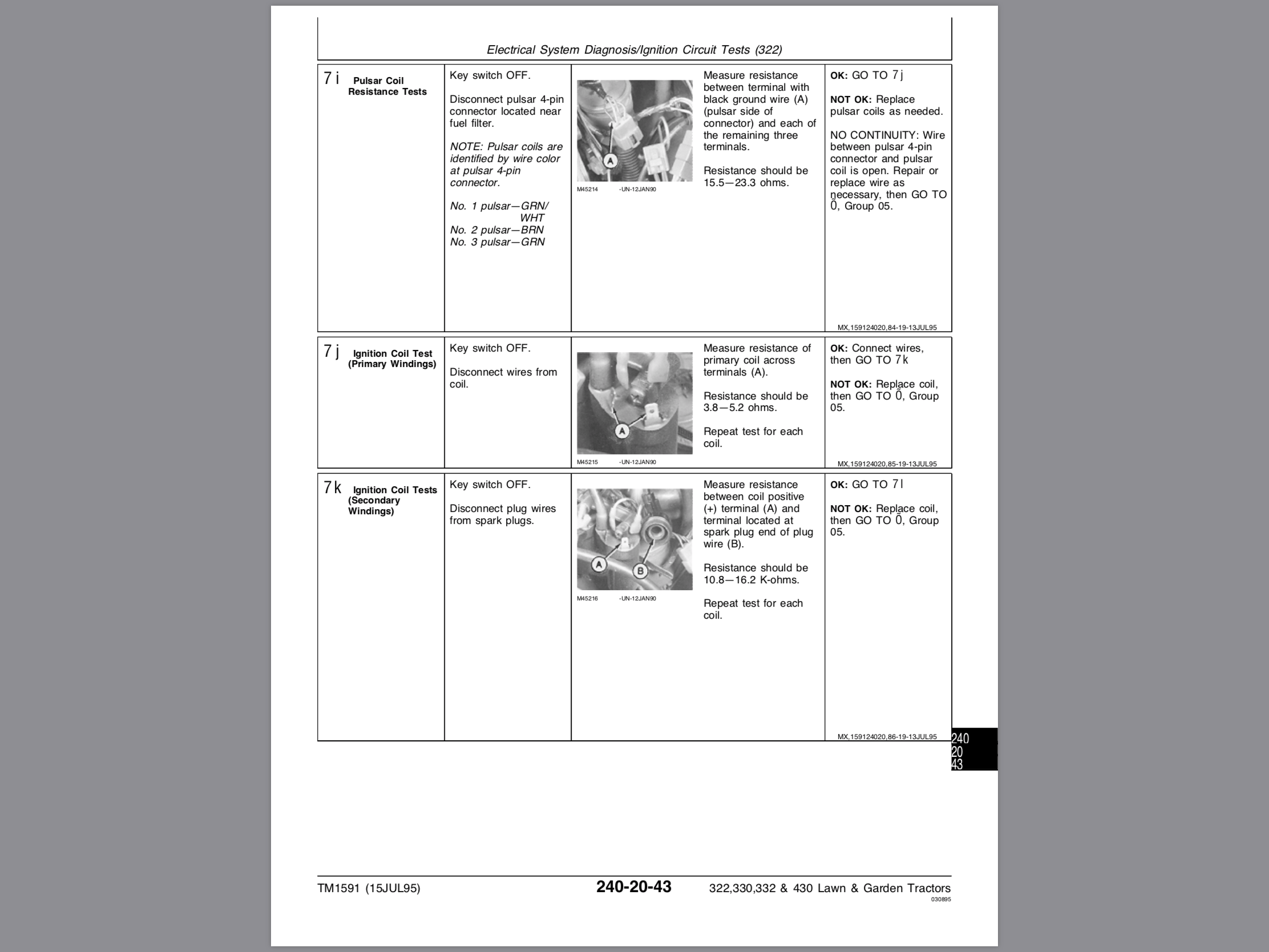

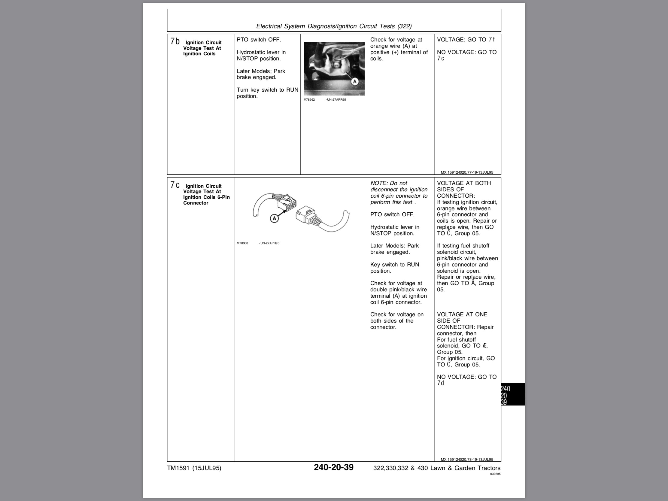

Do you have a copy of TM1591? Section 240-20-38 to 240-20-44 covers everything you need to diagnose your symptions. I’m not sure how to post pages from a pdf.
/ JD 322 ignition module testing #7
I’ll try
24D7C045-B7A2-4999-AE90-EE97BF888348.png123B21FF-B86E-49EA-8167-0C3E75411CC2.png5D55AE01-CCD3-4F5B-99CC-5EB704C32687.pngD87328DE-4782-4897-A802-84E669BDA6CF.png9F7392D2-BE16-4590-BDAF-0208F4B6DFD5.png2D61E4EB-51B0-453C-9FC7-CB7CCD9DCFBE.pngDC73CEEB-EE5C-4C85-88A9-E01693AAD1DA.png
They are not in order.

After fighting this problem for the better part of a month I finally figured it out. Turned out I had a bad ignition coil. What took me so long to fix it was the bad coil still checked out with the tech manual specs. every time I put a meter on it. After going through the entire troubleshooting procedures listed in the manual NUMEROUS times I finally decided I had to start replacing parts until I found the problem. Since I'd already purchased an ignition module and it wasn't the problem I decided to go with a new ignition coil next. I know a coil is more expensive than a pulsar but I wasn't looking forward to removing all the parts necessary to get to the pulsar so I went with the coil.
So in summary I'd say I learned one thing and was reminded of another: Don't believe EVERYTHING you read in a tech manual .... and when having to purchase parts to find the problem, don't start with the most expensive part.
I want to thank everyone who tried to help me get my 322 running smooth again.
