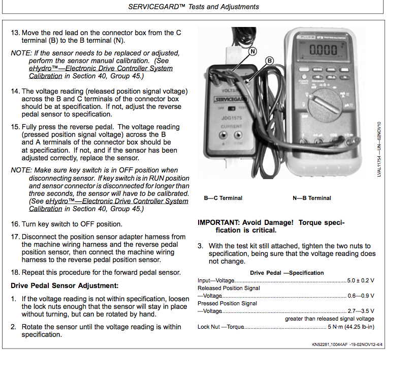

same problem here, the tractor starts but won't move. should I fix the error 08 before calibrating?
   / JD 3320 will not move after calibrating throttle sensor #22
It would seem to make most sense to fix the error code first, then calibrate based on everything stated to date in this thread.
   / JD 3320 will not move after calibrating throttle sensor #23
I adjusted the throttle sensor within specs, the front and rear pedals to specs. but the pedal high specs were higher than the book. So I put a deep socket between the pedal and the floor so the pedal would not bottom out. I went into the calibration mode and followed the procedure and DONE. It works now, moves forward and backwards. Giddy up!
   / JD 3320 will not move after calibrating throttle sensor #24
Would this be of any help? F&R pedal sensor adj 1.pngDrive pedal  adjustment 2.png
   / JD 3320 will not move after calibrating throttle sensor #25
sure. I used the onboard diagnostic mode #2 for e-hydro. my manual might be newer than yours, the writing and page #s are different.
   / JD 3320 will not move after calibrating throttle sensor #26
Great! For clarification, did you fix the error code 1st, or do the calibration/socket adjustment and in the process fix the error code at the same time?
   / JD 3320 will not move after calibrating throttle sensor #27
yes I did, if you don't the tractor won't calibrate.
