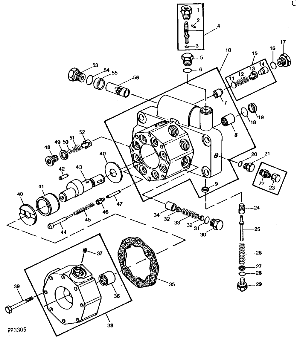

To check stand-by pressure one needs a 3000-5000 # gauge with the correct hyd fitting to attach to hyd pressure port. Here's the spec's for the pump plug(parts key 5) if your tractor has the smaller pump

This picture shows the left side of the front hydro pump. I if I remove that 1/2 bolt from the top is this where I will put my new hydro gauge? I was worried that this was some type of a adjustment bolt for the pump. I removed the 1 1/4" plug from the other side of this bolt but those threads were very coarse threads not npt
/ JD 401 hydraulic problem #19
Before attempting to check hyd pressure be sure to check fuel return line fitting that attaches to inj pump for blockage. Port to check pressure is plug(parts key 26). The following spec's should get you an adapter.
