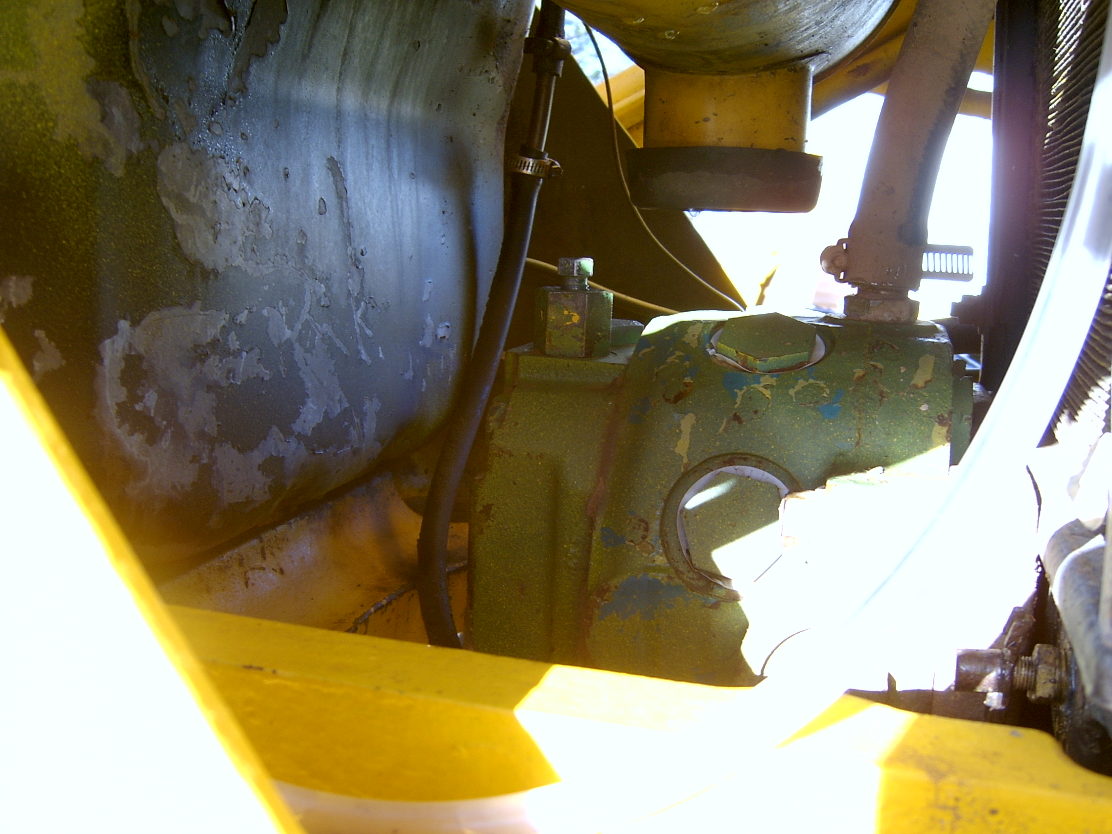

This picture shows the left side of the front hydro pump. I if I remove that 1/2 bolt from the top is this where I will put my new hydro gauge? I was worried that this was some type of a adjustment bolt for the pump. I removed the 1 1/4" plug from the other side of this bolt but those threads were very coarse threads not npt

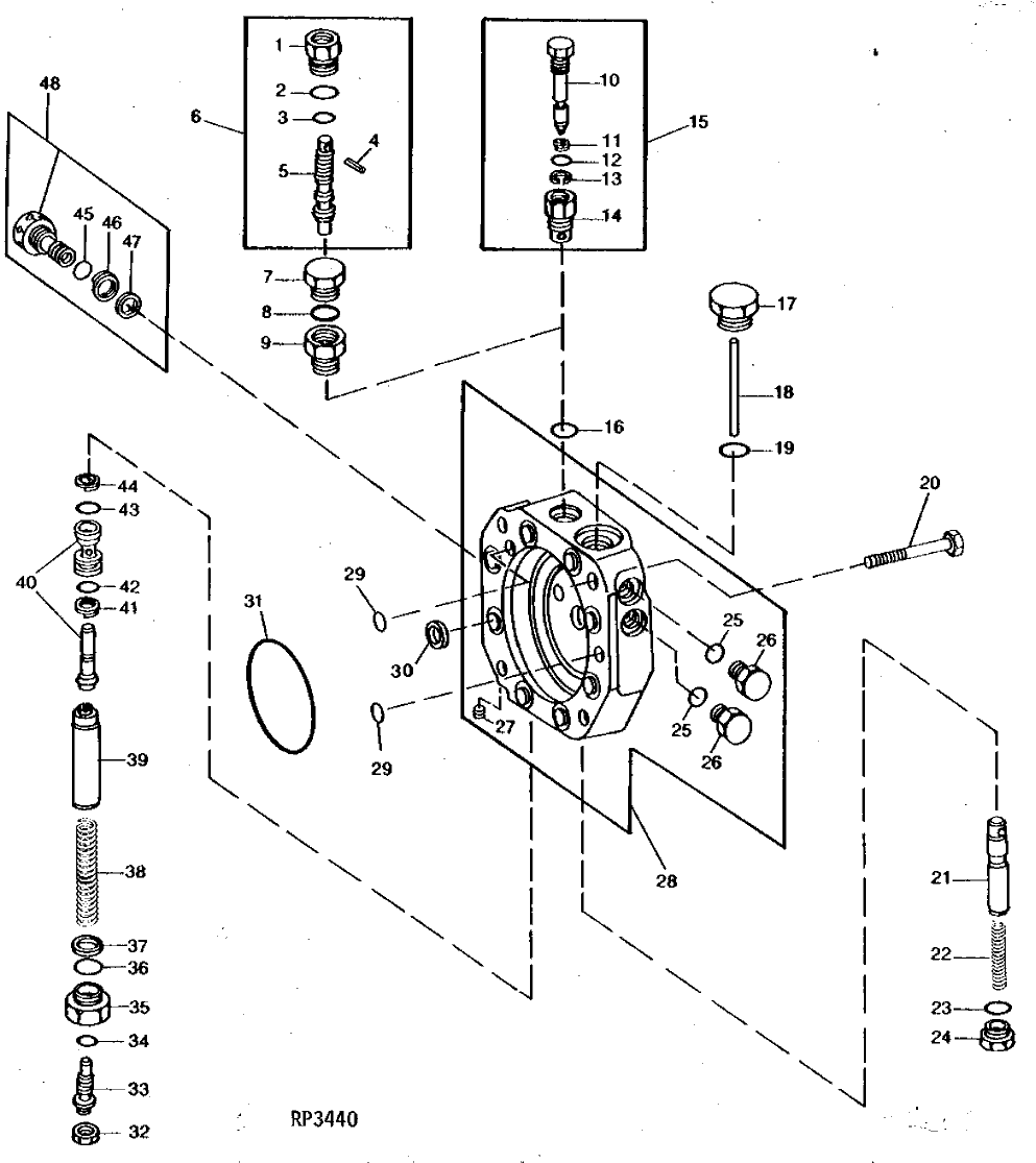

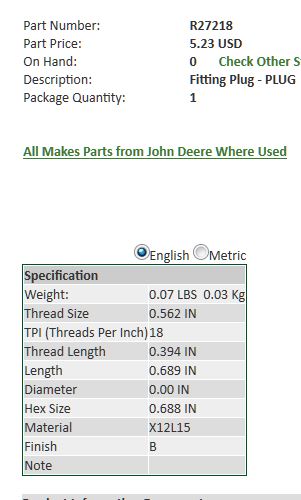

Before attempting to check hyd pressure be sure to check fuel return line fitting that attaches to inj pump for blockage. Port to check pressure is plug(parts key 26). The following spec's should get you an adapter.
