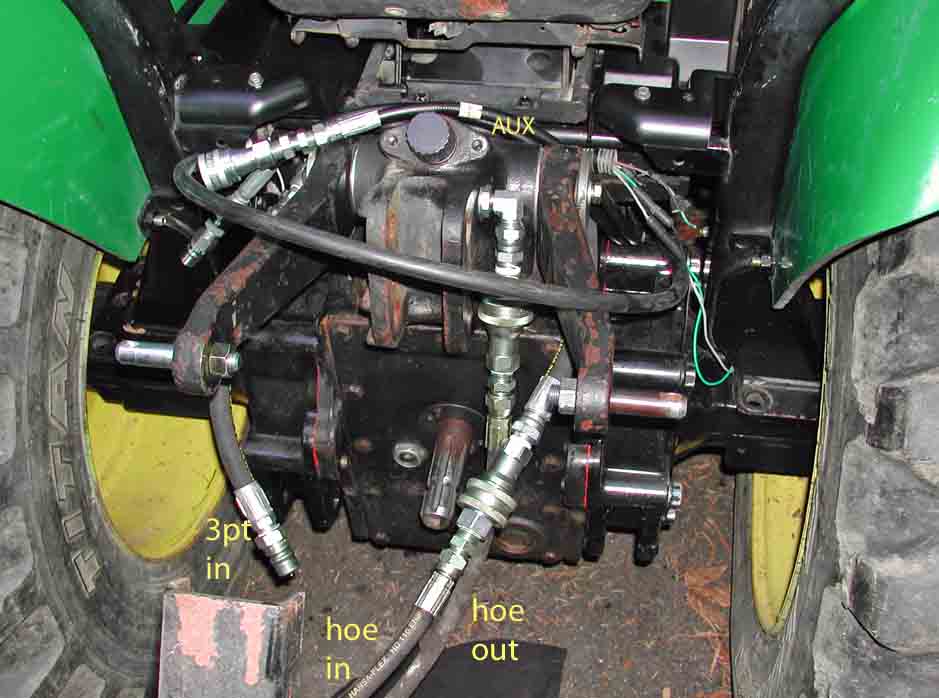

   / JD 4300 hydraulic screen clogged over and over #15
dfkrug, can that be retrofitted to the 42/43/4400?
Yes, if you order a replacement cap, they send you the new one.
You can see it in one of my 4300 thread pix here.
