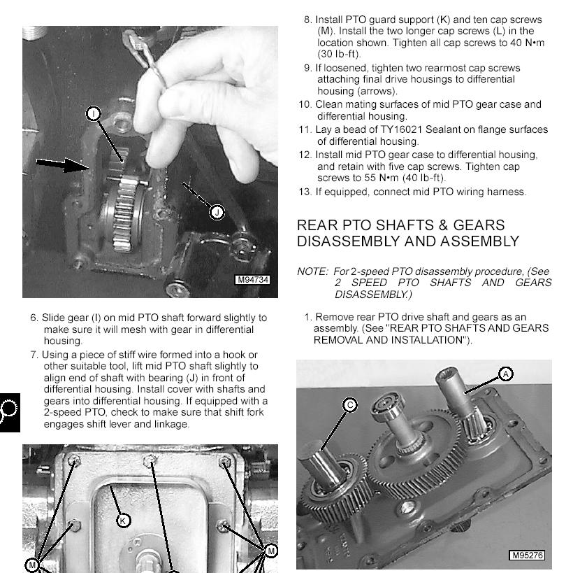

I looked at my CD tech manual, and reassembly indicated getting all the gears onto the cover, including the mid-PTO shaft (looks like you have that). Then removing the gear box of the mid-mount PTO before installing the cover (I am assuming because that front gear for the mid-mount PTO doesn't align easily with everything left in place.
(added a page from the manual)
If more detail from the tech manual is needed, I'll oblige.
Thanks a lot for the reply... I do not understand "removing the gear box of the mid mounted PTO",, is this just a cover?? Am actually going to take the whole thing apart now.. If possible please check if the shaft which I now assume is for the mid mounted PTO has any washers or anything.. It fell apart inside on me and i located the gear and got it back on. but just want to make sure nothing else fell apart...I looked at jdparts online but was not able to locate this.
ANy more info on this gear box of the mid mounted pto is apprecited.. I have rebuilt engines before and am mechanically inclined, but dont want to be messing with gears in a tranny or gear box...
   / JD 4300 hydraulic screen clogged over and over #44
Here is the additional page regards re-assembling the front gear (don't think anything drops off that shaft other than the gear) into the mid-PTO gear box (note the use of a bent wire to hold up the shaft as it is brought forward.

With the help of the manual (thanks beenthere) I was able to get the tractor back together. It took two people because once you line up the shaft someone else has to push in the cover. I DO NOT reccomend taking the cover off during a regular oil change if you have the mid PTO shaft. This was not easy to do because there isnt much room in getting the wire in the PTO gearbox housing and you have to work behind the tire (unless you take it off). Tracor is working excellent. As I said before it has new JD oil, New filter, New screen, and new oil filler cap. I am looking into places to get the old oil checked. It runs good now and hopefully will stay that way. Thanls to all for your reccomendations and help.
