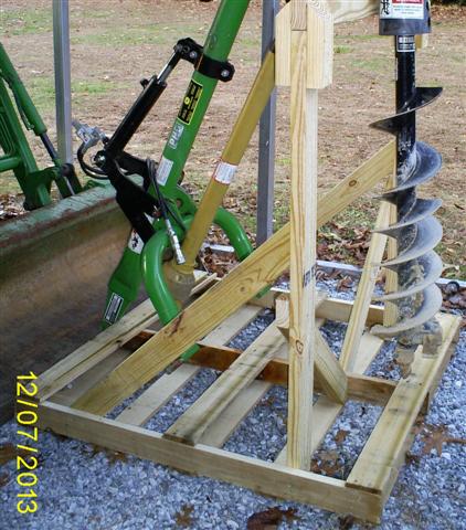

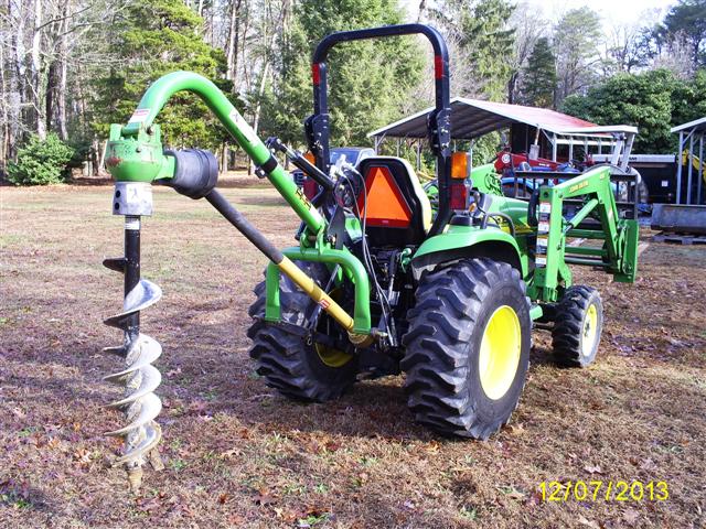

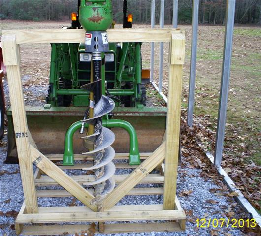

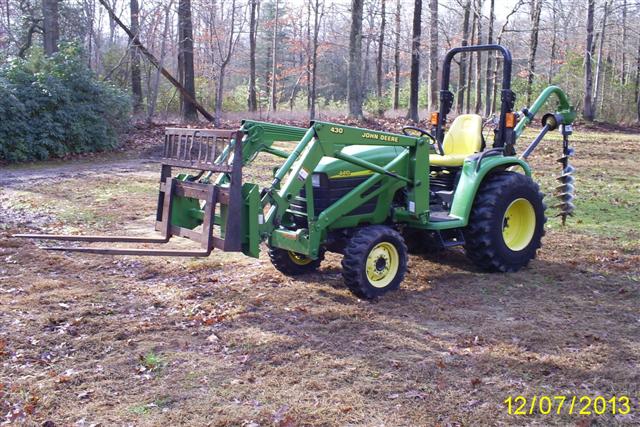

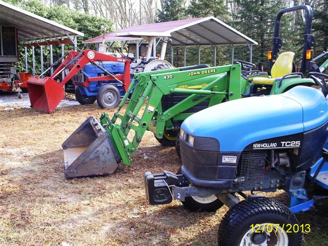

photos from today.
I built a quick PHD stand based on some examples I found here so I could get it off and mount the rear blade in case we get snow tomorrow. Need to add some support in the front for the drive shaft and yoke so I can just back up and unhook. I used a pallet so I can move it using the forks on the Bobcat or the tractor if I need to. The cross arm is loose and gets removed when backing the PHD in, then insert the cross arm and lower the PHD about an inch to put the loada on the stand.

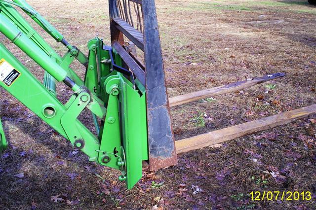

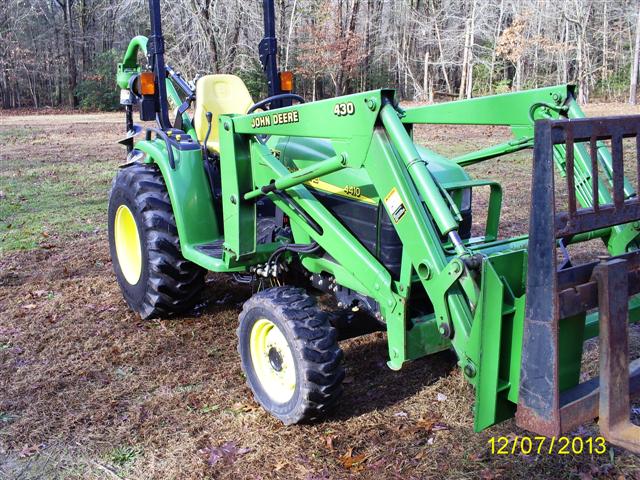

I put the Bobcat to JD quick attach adapter on and tried mounting the forks and also the Bobcat bucket, worked great. I don't see me using the Bobcat bucket on the tractor often just wanted to try it out.

Very nice!
Thanks for posting the pics!
