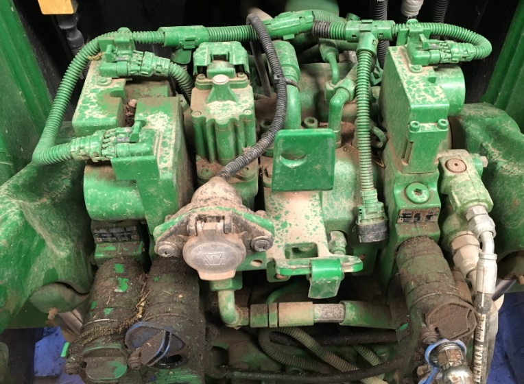

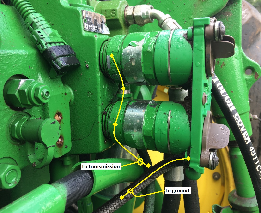

Are the hoses from the quick couplers? The ones I've seen had two per coupler, one at the end/dust cap that collected the oil to catch bottle, and the other from the body of the coupler and those hoses connected back to the transmission fill.
For the "drain down" I think you need to check/replace the check valves (two per SCV) parts 7,8, 9, & 10
Nice pics! Yes the hoses appear like those in your first pic, but mine dump on the ground - unless they are supposed to reconnect to the transmission. Tomorrow I will do some disassembly to see if those valves are made up like your pic. The actual valve appears to be a slight modification. eSCV.jpg

The op's parts person may have been referring to not much you can do with the couplers themselves beyond replacing the oring/bu ring in the coupler. There has been a plethora of substitutions since these couplers came out. If oring or oring/bu combo has been replaced and you continue to get excessive oil out of drain tubes you are probably looking at replacing the couplers as a whole. That might seem counterproductive but is substantially less expensive than the rebuild cost of the older style couplers like on soundgard vintage tractors. You do not have to go back in with couplers that have the drain tubes. If you stick with couplers that have drain tubes you just have to be careful to get the proper set. There are versions that have drain spots in different locations, some can be installed in top or bottom some have to be replaced in the proper spot. An example of a couple that does not have drains is AL200979 and will screw right into your tractor but be aware without drains it will dribble out the coupler when you unplug, etc. Excessive draining from the leak off makes me believe you need to start with new couplers, as far as cylinder operation has internal leakage on the implement been eliminated as a problem.
Got it. The JD parts person sounded very inexperienced. I have had the tractor for 7 years and nothing has been touched on the SCVs todate. It would not be surprising if all of the "soft" parts need and should be replaced. I will try to investigate more.

Are they only leaking when the hose is inserted? Or all the time?
If it's just when the hose is installed, look at the far right diagram Zebrafive posted, number 3 is what you need, it's a o-ring and a Teflon washer that fit in the back each coupler, you will need patience and a small (pick set helps) to replace them.
Don't worry about hurting them coming out, going back in with new ones is when you have to get them straight and not bend the Teflon washer.
It's really not hard, just tedious.
They come in a kit of ten or twenty I believe it is, so be prepared, you will need them all eventually anyway.
I go through them like candy it seems like, and yes they will allow a lot of fluid to pass when they are used/worn.
The Teflon washer goes in front of the o-ring as you can see in the diagram..

It does sound like you are having problems with the couplers and not the valves...
I think it is both.
... Your tractor probably has the deluxe couplers with dust covers and 2 different drains per coupler...
Yes and yes.
... All of the coupler versions are made to be able to connect and disconnect under pressure and all of them are around 100 bucks a piece. The feature in them that allows them to connect under pressure is what makes them leak down under load when they go bad...

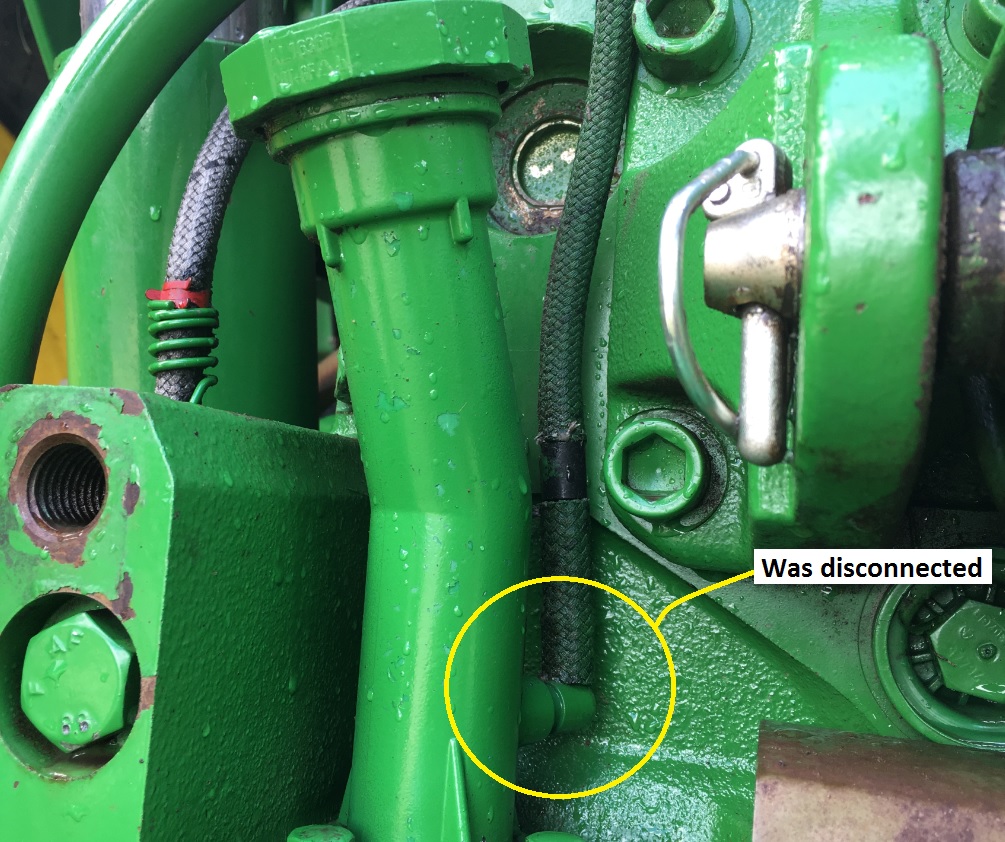

On my machine, the couplers simply have a plastic cap with rubber membrane that slips over whatever series or make of coupler you have. Barbs on the tops and bottom allow connections of hose to the coupler above and then using a Y ultimately to a stupid little bottle that I guess is supposed to save the planet.
   / JD 7130 e-SCV failure. Need rebuild. #20
The deluxe couplers have two lines and the inner line connects the trans fill
