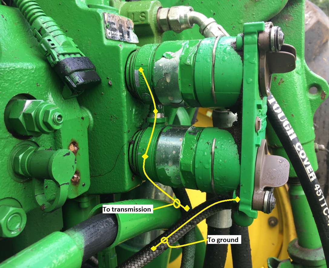

Speaking of tubes / hoses, I cleaned up the back end then started inspection. I found 2 hoses per SCV. Here is a pic:

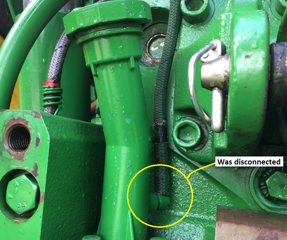

Then I tracked the hoses and found that the exterior (furthest away from cab) one went to ground, while the interior (closest to cab) hose was disconnected from the back of the hydraulic fill tube. I reconnected it:
No wonder I lost so much oil in so short a time! When I witnessed oil coming out of the "transmission" tube, it was really flowing. There are no clamps, which tells me that they are designed for very low quantities. Anyone care to guess what each type of tube does?

Then inner tube is supposed to be "clean" oil, so it is retuned to case. The rear tube is "possibly" dirty oil so it goes to the catch bottle, so as not to pollute.

The inner hose that connects to the transmission tube should have zero oil flowing after hose is connected and operating. If it flows oil when scv is engaged, then the coupler is bad and needs to be replaced/rebuilt. If the outer hose leaks oil when in operation, then most likely the oring in outer side where hose tip plugs in needs replacement or possibly hose tip could be damaged.
Hmm. The rear tube does not have a catch bottle and appears not to be designed to have one, for the end of the tube is pointing straight down at about hitch level.
