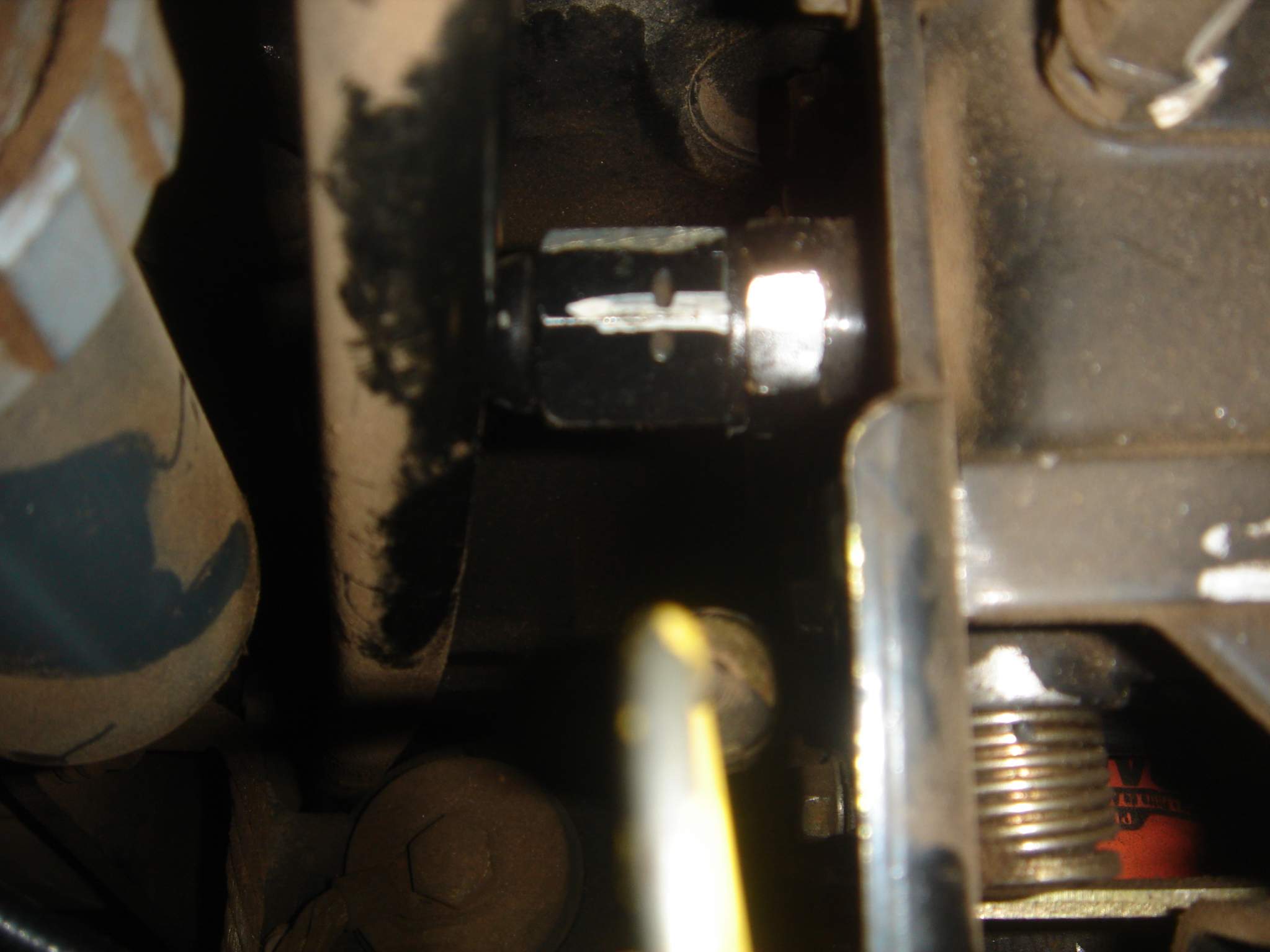

Is there a chance you could post a pic of the back of your pump? I know of the spring but need to confirm the adjustment. I wasn't aware it was a external adjustment.

Sure, here you go! To help get your bearings as to location, the dipstick handle is easily visible bottom center of pic, fuel filter to left. Also visible is the white "tamper" paint, and the small hole in the acorn nut to allow the use of safety wire? Pay attention to the gaskets on either side of the lock nut, and once the lock nut has been loosened initially, that shaft is free to turn with it, possibly causing you to loose track of the initial setting?

That's great, thanks a bunch.
