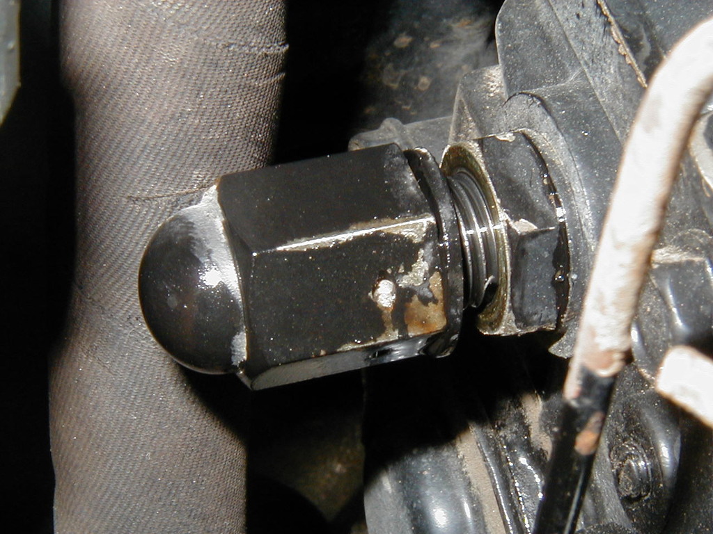

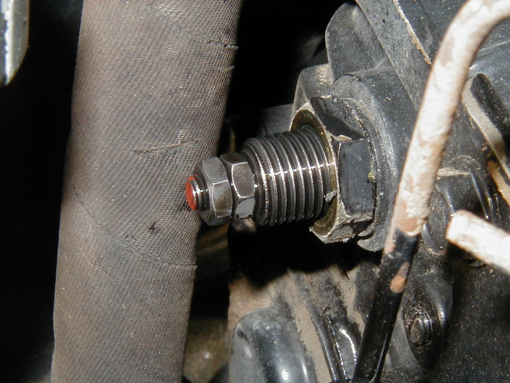

I'm having the problem and taking the advise here I removed the cap nut--1/2 off in pic.
I see a small bolt/threaded rod/shaft with 2 nuts on it.
It seems to move freely in that larger threaded piece. I didn't dare turn it but it does seem to pull out a bit and feels loose.
I'm confused as to what to do now.
Do I:
1. loosen the remaining large nut and turn the large threaded piece itself out one turn then lock that nut back and put the cap nut on while leaving the little rod and nuts alone?
2. loosen and back off the little nuts on that rod one turn?
I'd greatly appreciate replies from someone who's done this. Thanks!

Fred,,,,, do not mess with the small nuts connected to the little rod... Leave that alone,,, and yes the little rod does move about,,cand all of that is ok......
The process is like you said in choice 1,,,,,, loosen the big nut and turn the threaded "cylinder" (for no better word), out about 3/4 to one turn,,, then tighten the big lock nut,,, and put the outer cup back on...
The end result of this is the governor should kick in faster and also allow the pump to deliver more fuel..
You can tell if it worked right away with more power and overall behavior..
Let me know how it goes

I just now looked at the photos posted by Fred.. The big threaded piece shown in his photo is definitely screwed in too far. Based on what I'm seeing I think i would suggest maybe turning the big threaded piece out maybe 1 and 1/2 turns or possibly more.
It will be ok to trial and error this adjustment.. Back out and try,, then if needed or desired, back out some more.. If you get too much smoke at full power and start chocking out with too much fuel,, you know you went too far, and screw it back in some !
Because of work, I'm not near my tractor, but when I get home next week, I'll do an exposed thread count to see how far mine is backed out..

Thanks for all the help. I caught a few minutes this AM as it began misting and turned the barrel out 1 to 1-1/8 turns. I'd driven it down the road to pull a neighbor out a snowy ditch a few weeks back and it'd bog down going up hills and I'd throttle up and as I topped the hill and started down the other side it'd sound like it was going to run away. Today with the loader on for weight I put it at 3/4 throttle, full forward on the hydro in high range, and set the cruise control. Headed up the hill with almost no change in engine noise (no bogging, it really didn't act like it had encountered a load at all--no smoke or sound like it was working hard either). I also couldn't see where travel speed slowed any either. It might well be fixed--I'll need a bit more time in good weather with it and some real loads to test further. If real work causes it to bog I might unscrew it 1/4 more of a turn and try that.
