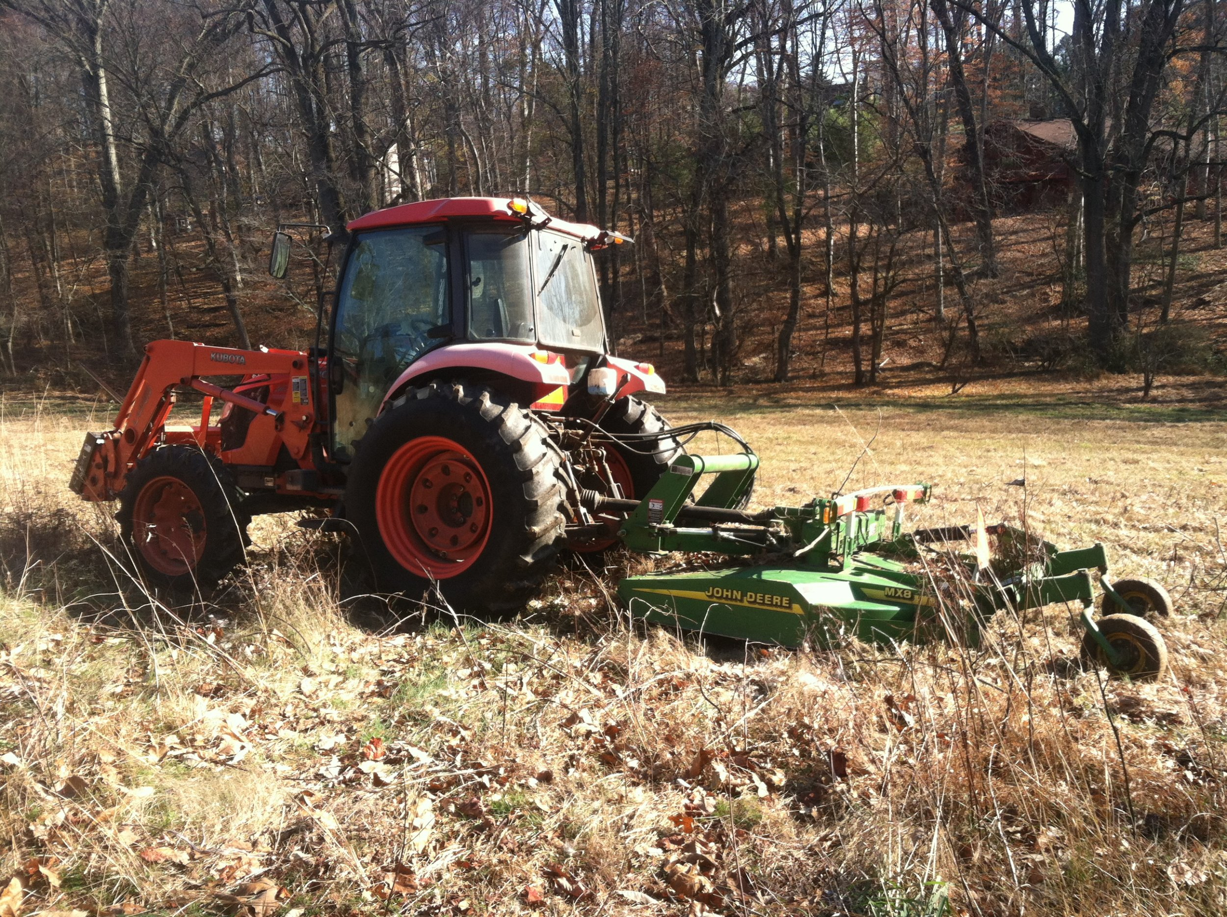

Some of the open areas I do are like your picture, but they let them grow up more before cutting. The ground is somewhat rough, so speed is limited. The 5 footer cuts with ease so my thought is maybe a 6 at the same speed will reduce total time some and still cut well.
Just on here discussing options for a decent 6 footer that may be workable in my situation.
I almost got a Woods but the HP requirements were higher and the guy at the dealer said in their experience it really needed 35-40 HP so I didn't go with it.
The JD and the Land Pride have lower ratings so maybe a better choice.

I like the Bush Hog squealer and Land Pride twin spindles (used) for your situation. Youd get a wider cut but HP requirements seem lower. Twin spindle mowers are really nice cutters. Something about 2 smaller bales doing a better job than one bigger blade
   / JD MX6 Brush Hog? Should I Go For It?
#36
Thank you, I am certainly going to research them more.
