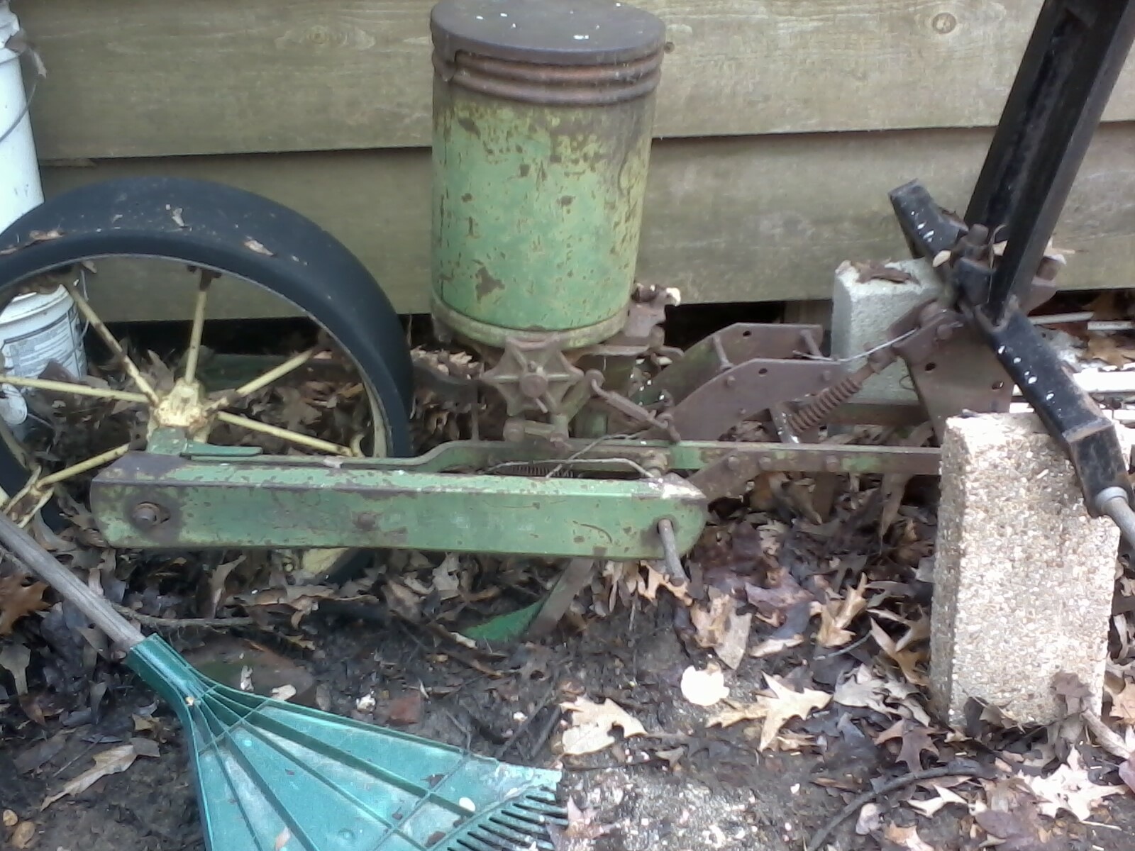

Friend and got this planter this weekend. Single row planter everything is in one piece with a couple of plates in side. Does anyone know anything about it by the picture. What model?? and does anyone know where I can get a manual or a parts list. There are a few broken springs but besides that it looks find and seems to work fine..
Any information on model, manual, parts or just general knowledge would be great. Never used a planter so have no idea how it works.

Sorry Picture didnt load here it is...

Go here to ID and for parts list John Deere - Parts Catalog . You can look at the different models to determine what model it is. I can't tell a lot about it, appears to be a 23 series unit planter http://jdpc.deere.com/jdpc/pdfs/PC0503.PDF. If it works ok, should be able to plant anything you can find a plate for. Lots of them on ebay. HTH Mark

If there was a model number on it where would it be?
I guess finding a manual would be difficult?

The first link I listed is JD parts and should have a box on the left side listing the various JD planters. The second link is the model 23 parts manual. On the first few pages of the 23 parts manual, are pictures of the variations of 23 planters. They look similar to yours, I just cant tell because of picture quality. Look at some of the major components of your planter unit. Should be stamped with a part number. Assuming it is a model 23 for example, the press wheel will be stamped with either 454,458, or 460 depending on the year manufactured and model. By looking through the JD parts link, you'll find units that match what you have. Compare the parts numbers on your unit with those on the JD parts page. That's the way I figured out how to identify the older stuff without the TOP SECRET decoder ring. :D I think most of the older units like yours had painted on model numbers. Have to figure out what you have to get the right manual. JD sells reprints of the manuals (kinda pricey) or you can find originals on ebay sometimes ( also kinda pricey). The older planters are pretty simple machines, and will plant reliably for those of us not needing several hundred bushel per acre production. HTH Mark
