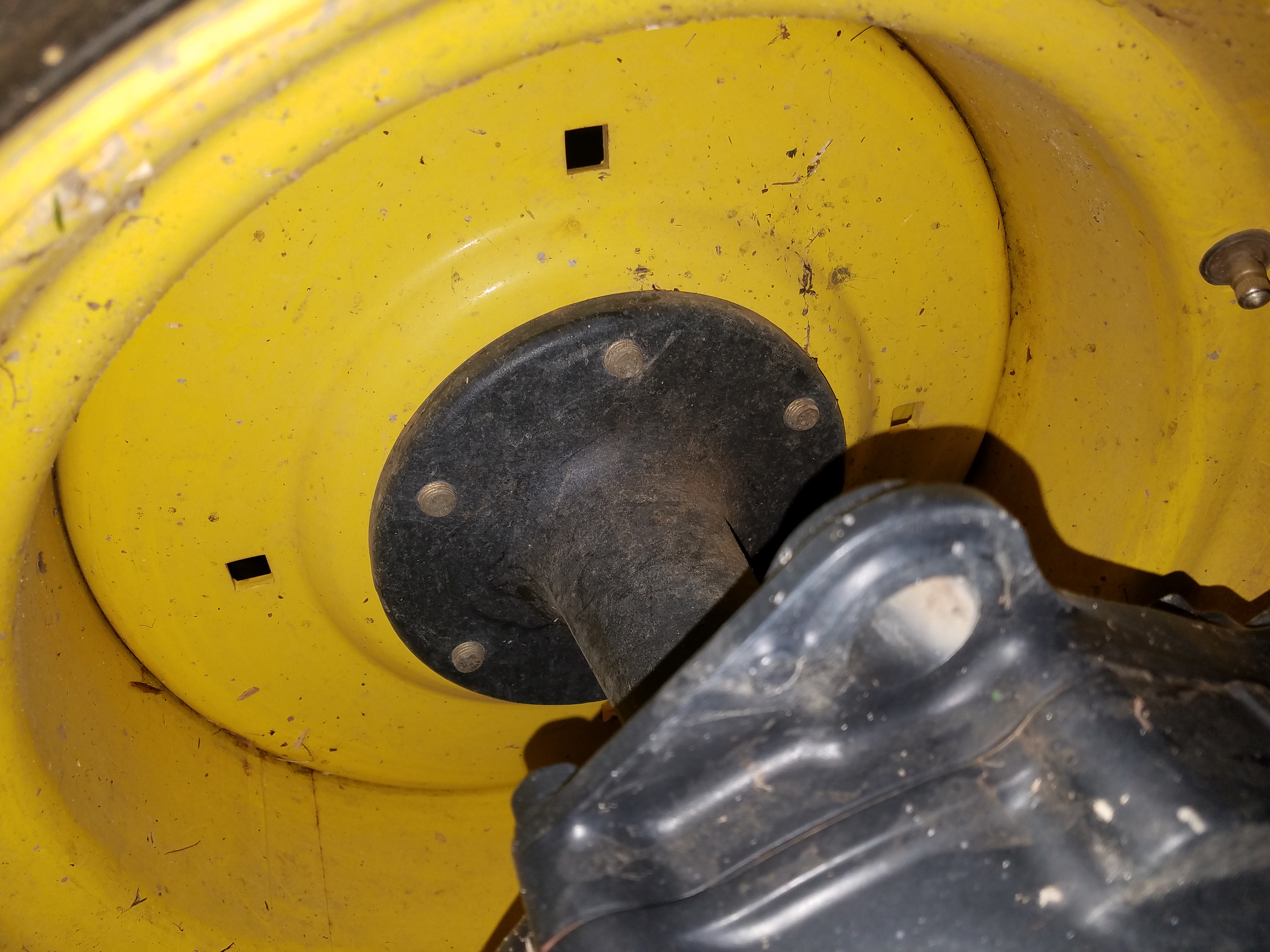

They came over today and they have an adapter that connects to the valve stem and it extends out over 6inches and needs to be hooked up with the fluid pump. So they cant do it in the current config as it hits the main hub assembly.

When trying to switch loaded wheels from side to side to gain width, my 3720 wheels could not be turned around because there were dimples that would not allow be to seat the wheels fully, I found out later. It did work for a while.
The valve stems were on the inside and I thought that didn't matter much anyway. That was until I was pulling dirt and brush with my box blade. Some sticks got jammed between the wheels and then tractor frame and as the wheels rotated it sheared a valve stem off, then the fun began.
To make the wheel stance wider I needed to put on spacers and leave the wheels on the same side of the tractor to keep stems on the outside. I still need to take care in heavy brush, but not as much.

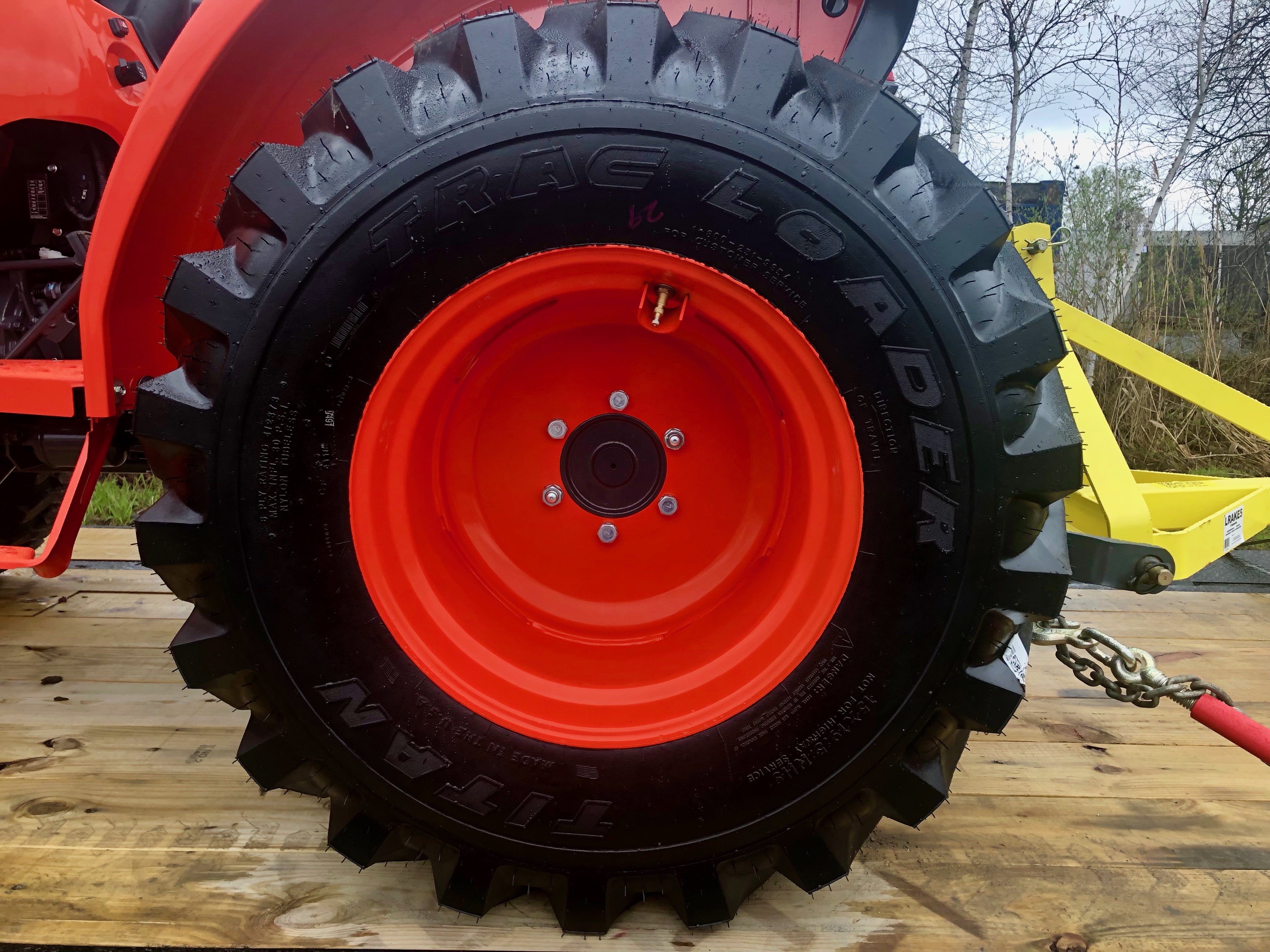

Kubota has a little half metal circle guard for the valve stems; does Deere do something similar? See pic. By the way, I love your signature. IMG_5216.jpeg
