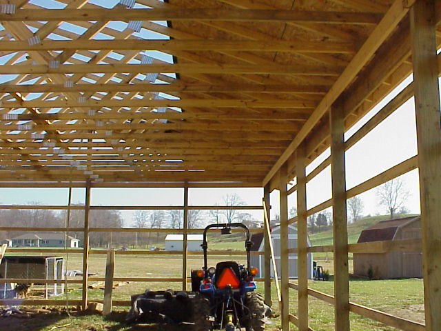

This is the progress on the north side.

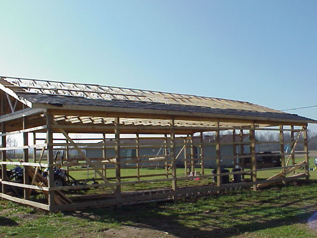

Trying to keep the tractor somewhat dry.

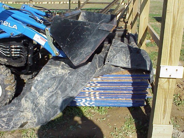

The daunting stack of OSB being dutifully guarded by the TC24D.

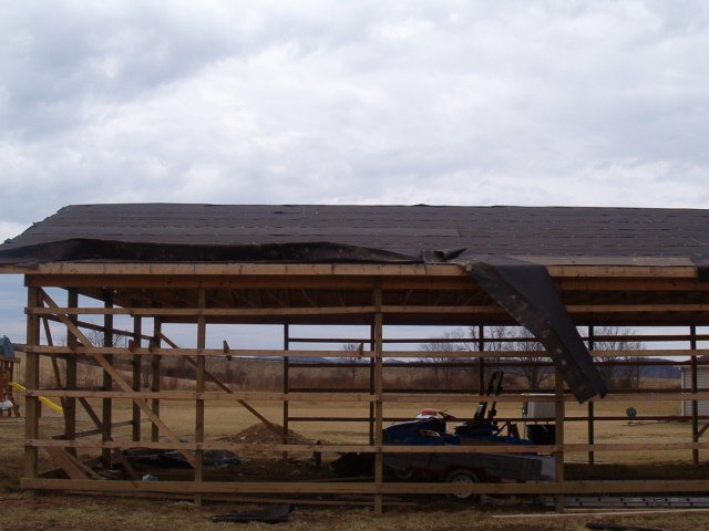

I bet you guys forgot about me didn't didn't you? or at the very least had given up hope. Here is a picture of the south side that we pretty much already had sheet on. I did get 4 of the little 12" pieces put on this side. Still have 2 more to do.

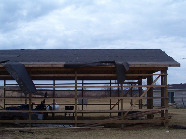

This is looking at the rear of the north side of the building. We were able to get all of the sheeting on this side of the buiding this weekend /forums/images/graemlins/smile.gif /forums/images/graemlins/cool.gif /forums/images/graemlins/laugh.gif. I'm going to go today and order the shingles. /forums/images/graemlins/laugh.gif

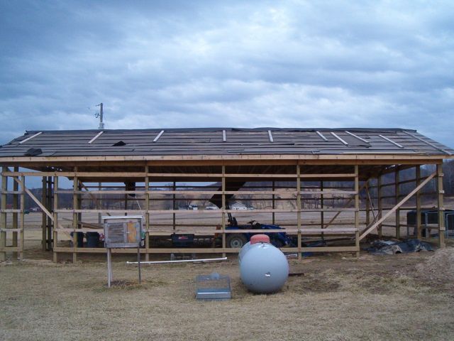

This is looking at the front of the north side.
