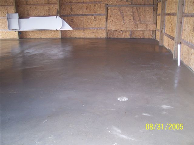

Re: Jim\'s Pole Barn Project - hopefully
Just finished eating lunch so now I can surf TBN and post pictures of my floor. Here is a shot looking through the left door. They used a power trowel to do the bulk of the work, but all edges were finished by hand and the final finish was done by hand. They asked what I wanted and I said smooth enough so that I could sweep it out, but not so smooth that it was slick. They said OK, we'll finish it "tight" and we won't "burn" it with the power trowel. The finish is what you see here. This is probably within about 15 minutes of them leaving. I did have them go ahead and put a sealer on it. I believe they called it Pex Seal, but don't remember for sure. They only charged my $25 to do that. I couldn't buy the materials and do it myself for that amount. That is why the floor is so shiny.

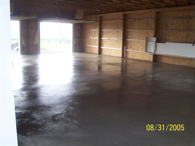

Another shot looking through the right front door. You can see the floor drain close to the middle of the picture. You can also see little tidbits of concrete left from the troweling processing. They came back last evening and did the saw cuts. They then swept the floor to get all of the dust out and swept these little particles out as well. They also asked me to power wash it to get all of the dust out of the saw cuts.

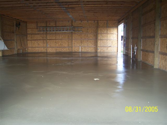

A shot looking through the tractor door. Again you can see the floor drain. They determined the proper height for these so that we could get decent fall. Once the drains were taken into account, there wasn't a whole lot of the floor that ended up being "flat." They did a good job at getting slope but not so much that it looks like it goes up hill.

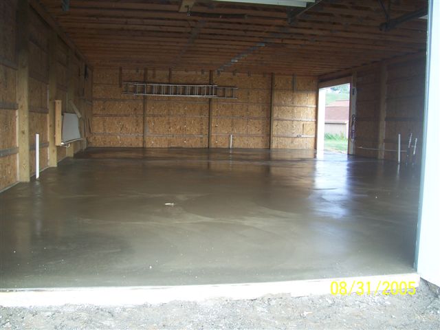

Another shot looking from the tractor door. This time looking forward to the front doors.
This is what I originally had formed for the aprons. We put a little pit of the last yard that was delivered into each of these to form a base and to keep from just wasting it. After talking with the concrete guys and my wife finally piping in we are going to take the concrete from corner to corner out about 6' feet dropping about 3" and also wrapping around the corner to pick up the man door. So a little or a lot more concrete involved depending on how you want to look at it. Tractor entrance will probably stay at the 2' foot apron. I'm getting close. I might start running some of the electrical wire this weekend. Something I can do fairly easily w/o a lot of tools having to be dragged in.
