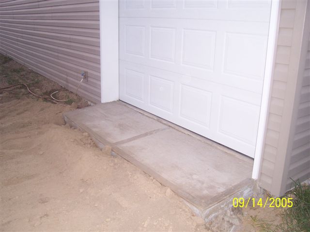

Time for some more updates. Really seems like this thing has taken shape in the last few weeks or so. If you remeber this picture Original Door Aprons you will remember that I was only going to have a 2X9 apron at each door. Well after the one cement guy and my wife got involved (not with each other /forums/images/graemlins/wink.gif) this is what turned out. Ended up using 4.5 yards of concrete.

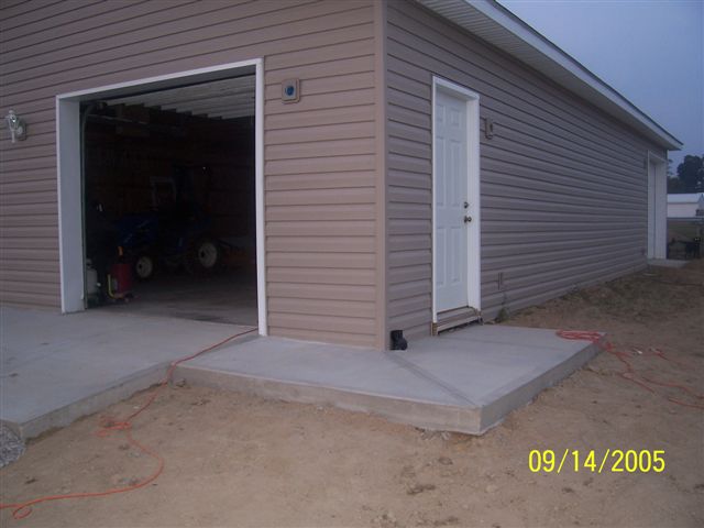

Re: Jim\'s Pole Barn Project - hopefully
Here is a shot of wrapping around to the man door. Two things I realized I had messed up on when I did this. I didn't think about the ground rod for the electric (did you catch that Jerry? We'll have to figure something out) and then the walked only ended up being 45" wide instead of 48." No matter how many times I squared it up and measured it. Just as we were pouring a figured out why. The side form was supposed to be 10'4". I only had a 10' board. I put it in and then the wife changed my plans. /forums/images/graemlins/frown.gif /forums/images/graemlins/confused.gif and I forgot to go back and put the 4" extension on. /forums/images/graemlins/blush.gif Really won't hurt anything, but did have me scratching my head for a day or so.

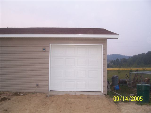

Here is the Wayne Dalton 9600 door that we purchased for the tractor. /forums/images/graemlins/grin.gif I really like how this door went up. The new ones are a breeze to tension. Put a 7/16" socket on a cordless drill and off you go. No metal pipes to whack you in the head or to slip and no springs to form a sling-shot.

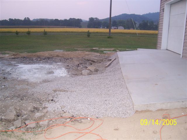

With the limestone that was left from the tractor apron I was able to place it in front of the cement in the front and form a little bit of an approach to be able to get the tractor, truck, and Trailblazer in and out of at least one door.

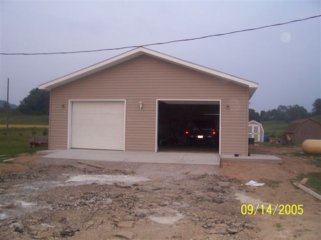

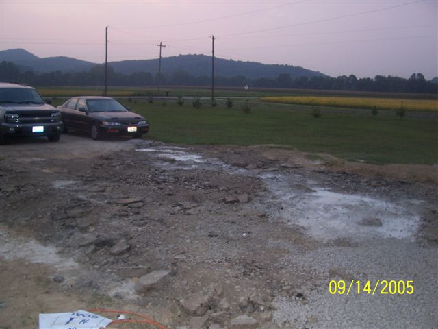

Since we spent some extra money on the cement in front (about $600 w/ the additional labor) and the extra money for the 1" foam board under the concrete. It might be a couple of weeks before we have more limestone hauled in to cover the crushed pavement that I have down for a base.
