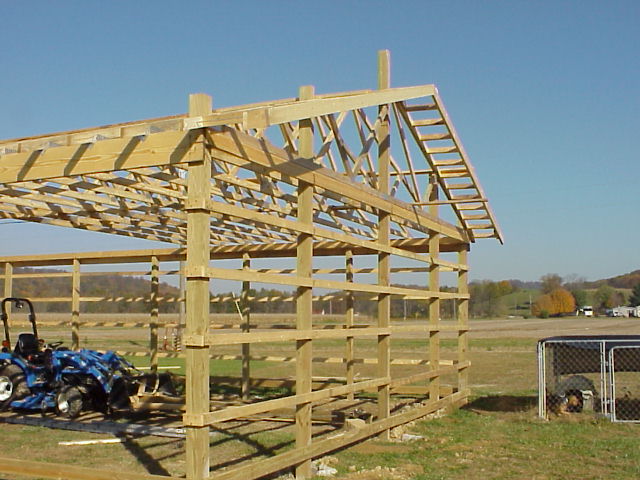

Re: Jim\'s Pole Barn Project - hopefully
Sorry, was still outside working yesterday. As Jerry said we got about half of the trusses set Saturday. I had Jerry (Inspector507), my cousin Richard (rsatter22), my Dad, my F-I-L, and my B-I-L here working. Here is the first picture looking from the right side up to the trusses.
Here is a shot from the back looking up at the trusses and the 24" overhang. Originally this was only going to be 12", glad I went with the 24 it is so much more proportion to the building. The little tractor with the boom pole attached did a great job lifting the trusses by themselves, but with these huge overhangs attached it was a little more than the tractor could muster. I could get it up about 3/4 of the way and then we had to "help" the tractor get it the rest of the way up. Insert your own joke here.....I know I've got mine.... /forums/images/graemlins/grin.gif

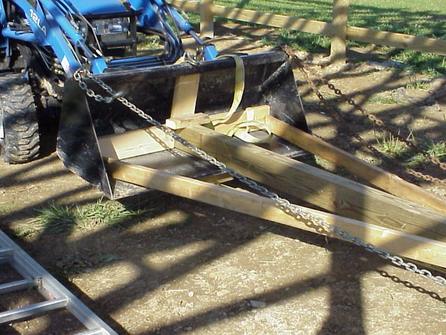

Here is how the boom pole was attached to the tractor. I can' t take credit for this design. It was Richard's (rsatter22) design. Worked really well. Only got scared one time and that was setting the 3rd truss (2nd inside truss) and it got loose from the guess up on top and it started swing. I believe it was Jerry that finally got it under control. Thanks Jerry.
   / Jim's Pole Barn Project - hopefully
#84

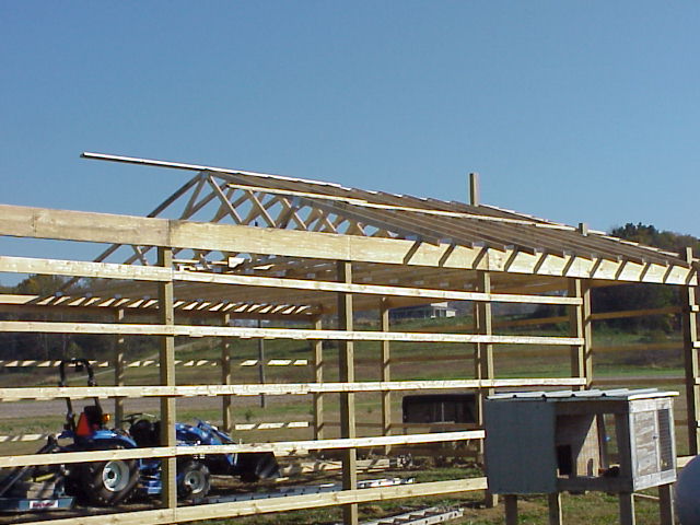

This is the other end of the boom pole where we used a chain to attach the trusses. I'll get another picture of it sometime, but I didn't have a key to the tractor and the camera together at the same time yesterday. Speaking of yesterday. Gotta get pictures of yesterday's progress as well. Didn't do near as well yesterday. Got the front overhang made, the rear poles cutoff to the proper height, a fascia board up on the right side, and about 5 or 6 sheets of OSB. Had trouble getting the first sheet to be square. The building was square, we just weren't getting it in the right spot. It would look OK, but by the time you'd put the second sheet on the 1/16" of an you were off was now 1/2". Took about 3 tries to get it right. Unfortunately one of those was with it completely nailed down. Took a while to get it back off.
