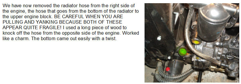

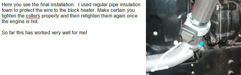

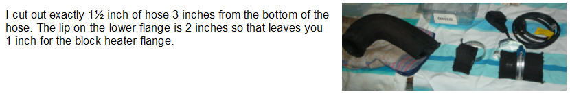

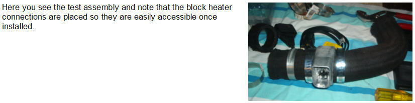

jinma 224 block heater
   / jinma 224 block heater #21
here is picture 2 of 5
   / jinma 224 block heater #22
here is picture 3 of 5
   / jinma 224 block heater #23
picture 4 of 5
   / jinma 224 block heater #24
picture 5 of 5
