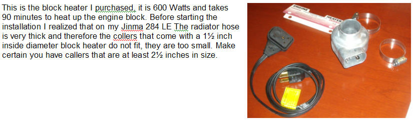

   / jinma 224 block heater #18
Just purchased one and installed it on my 284 LE, same installation on yours I beleive. See attachment for explanation. If it is too small to read just right click on it and copy it and then put it into a word processor page and blow it up. Block heater cost was $37.00 Cdn. Works like a charm.
