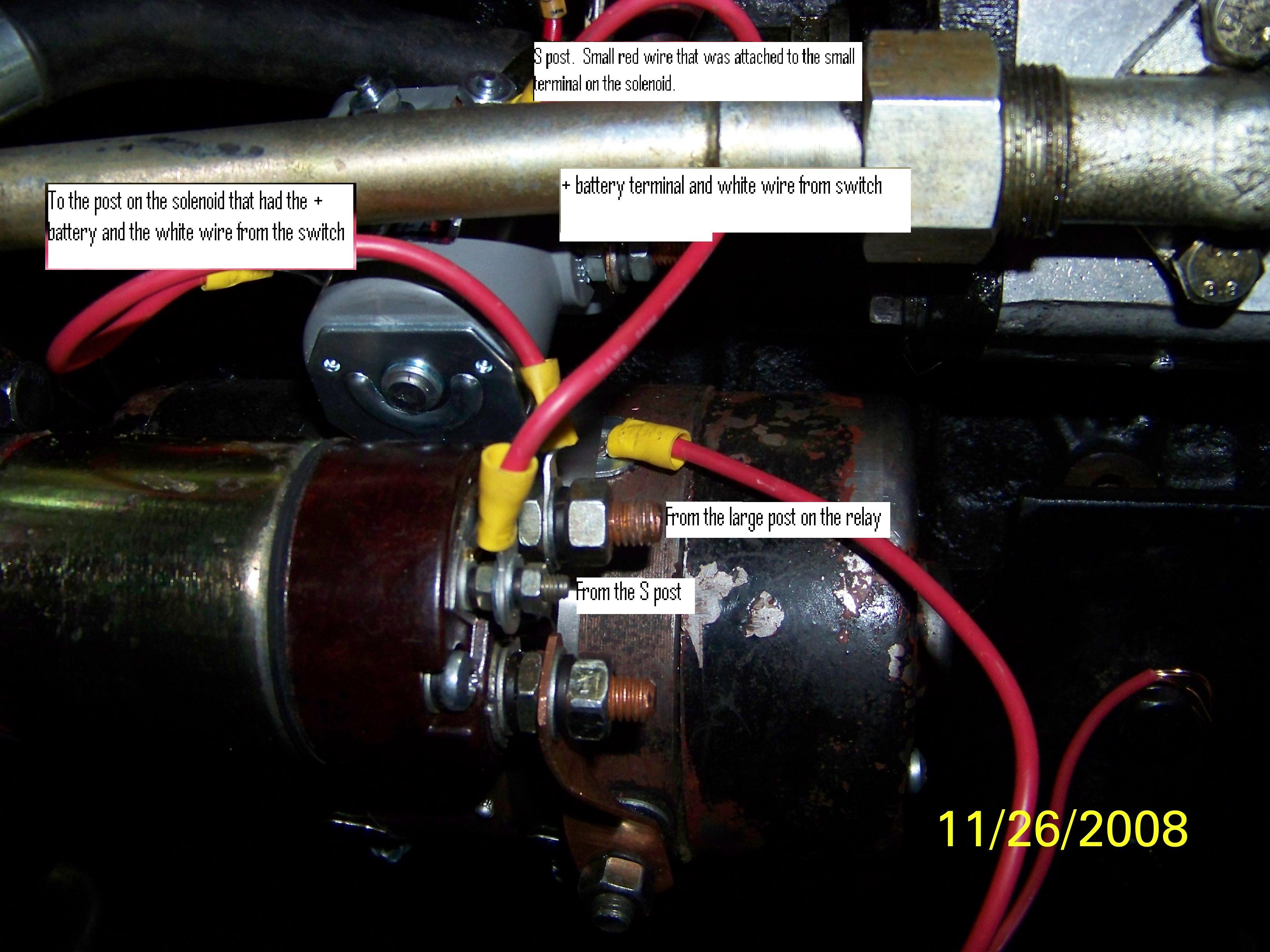

#69
Fix was premature. The starter will not engage every time and just spins. I put on the relay but I still only get 9-10 volts at the solenoid and relay is 10. It may have it hooked up wrong so I've enclosed a picture with the connections. And yes all connections are clean.
Mark H
   / Jinma 284LE won't turn over #70
Sorry - I responded to your IM before seeing this photo. It is in fact wired up incorrectly. Contact me via email please.
