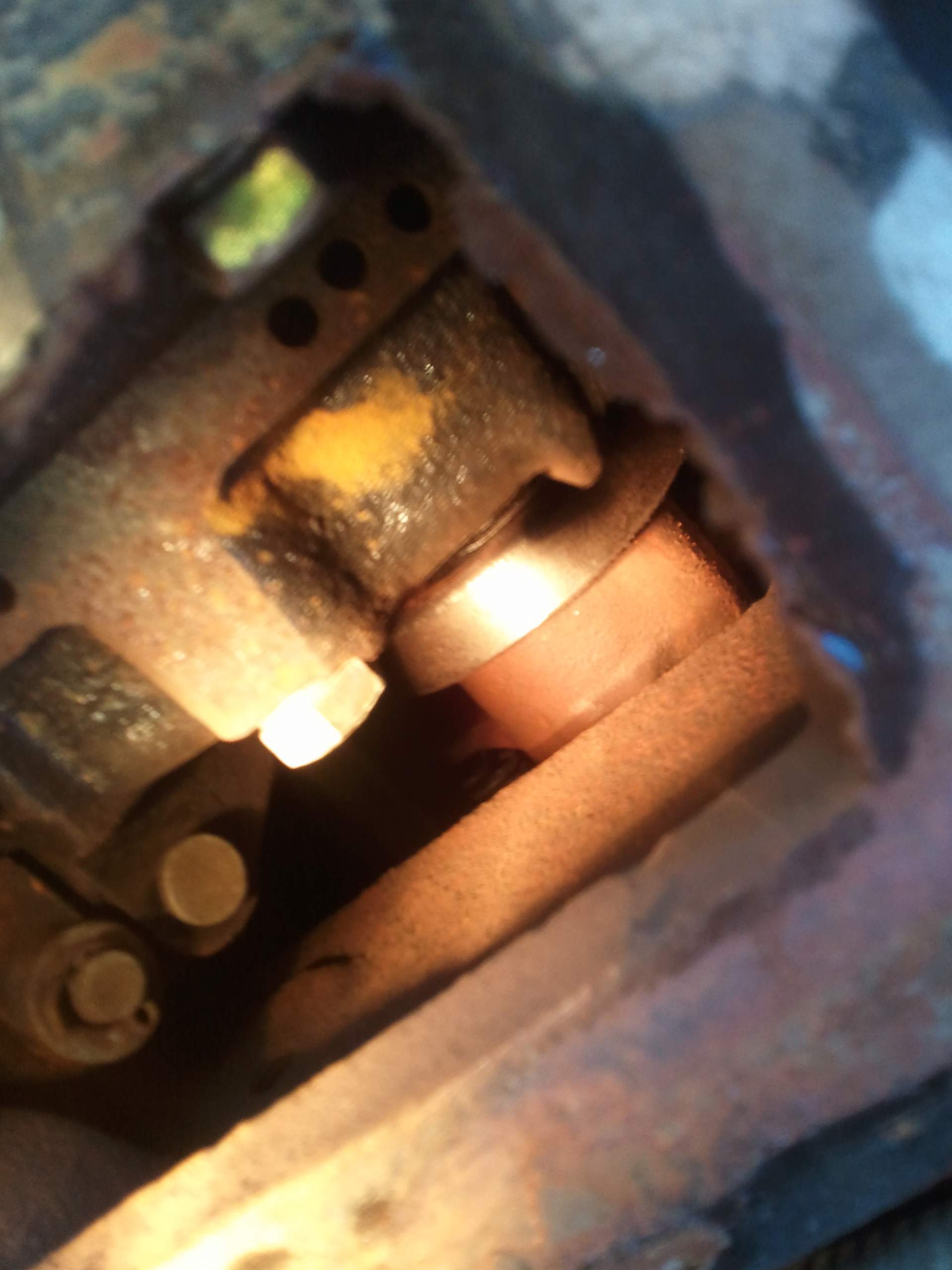

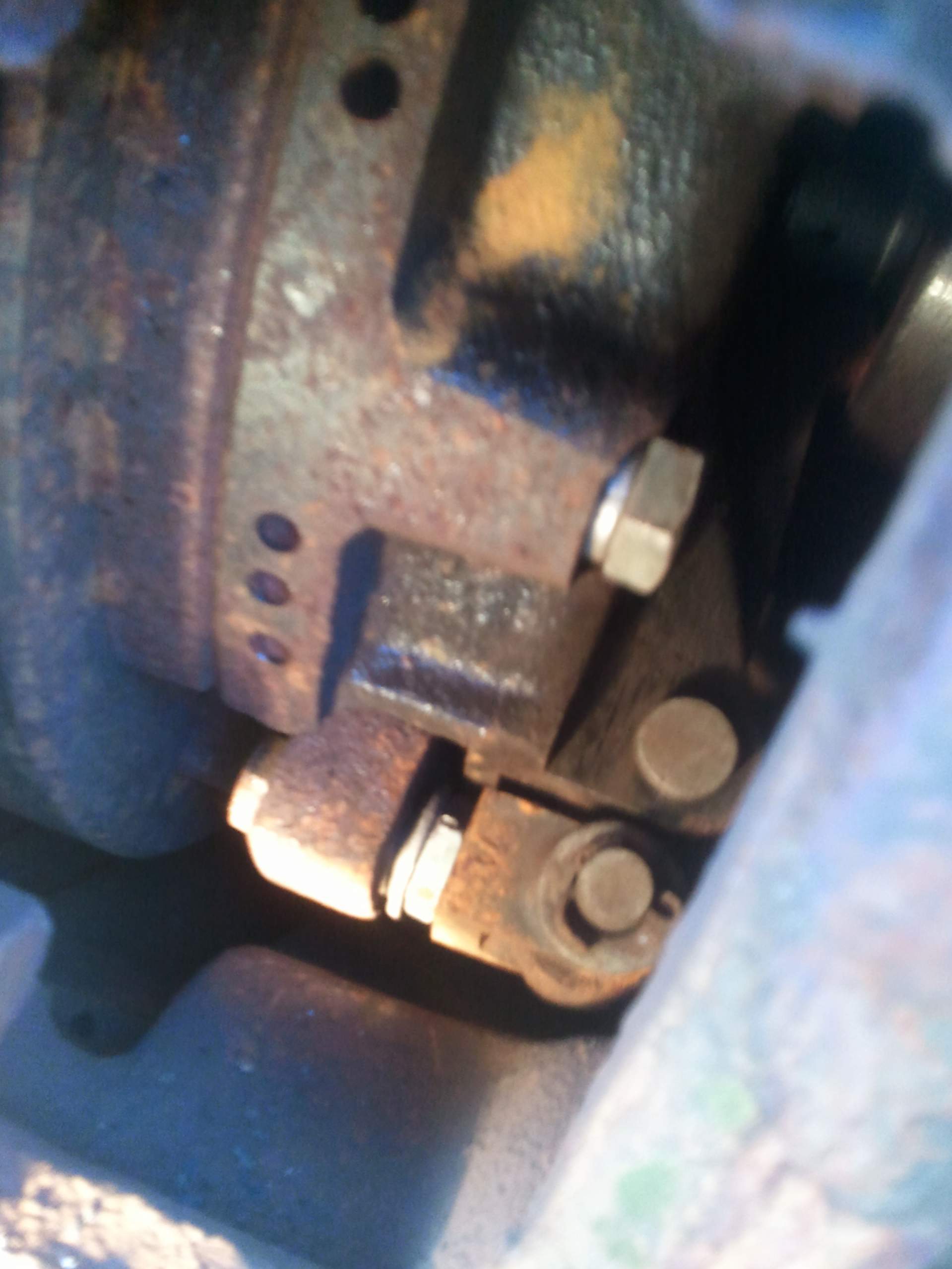

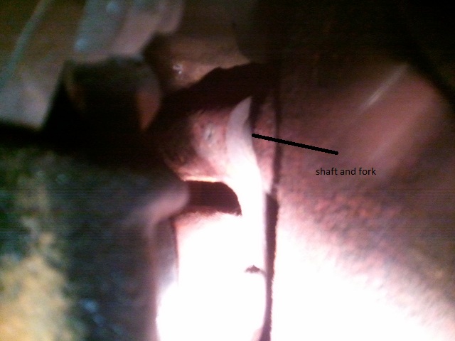

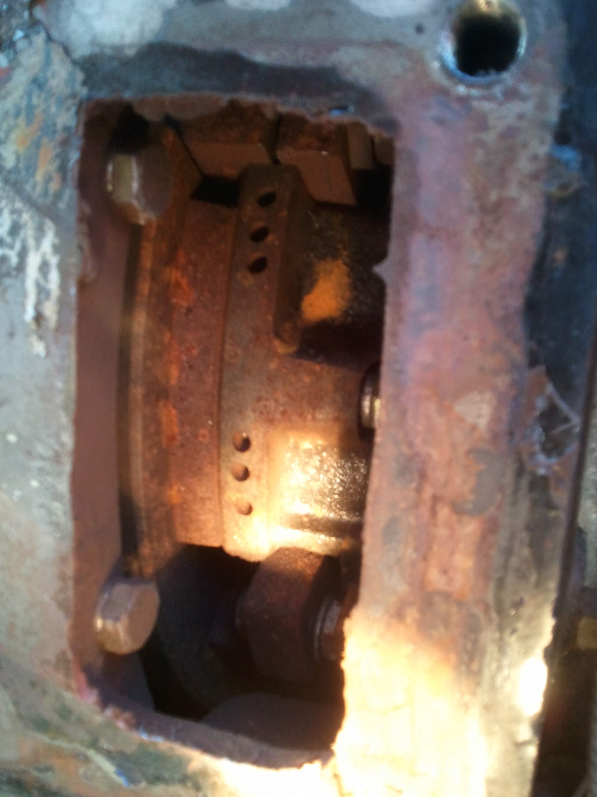

Ok, so the weather broke and I was able to drop one side of the loader to get a look inside. I hate to even type this out but my initial thought was "isn稚 there supposed to be some kind of lubrication in here?"
So nothing looks out of place or stood out as even looking like I could see a problem. There is a little bit of surface rust on things but the fork looks intact and yet that shaft will not rotate in the slightest. I will get some photos and post shortly. Looking for more ideas.
:confused2:

#19
Photos attached

Sorry for all the questions, but how can I tell if the roll pin at the fork is still good, looks like there may be two of them, is that possable?
