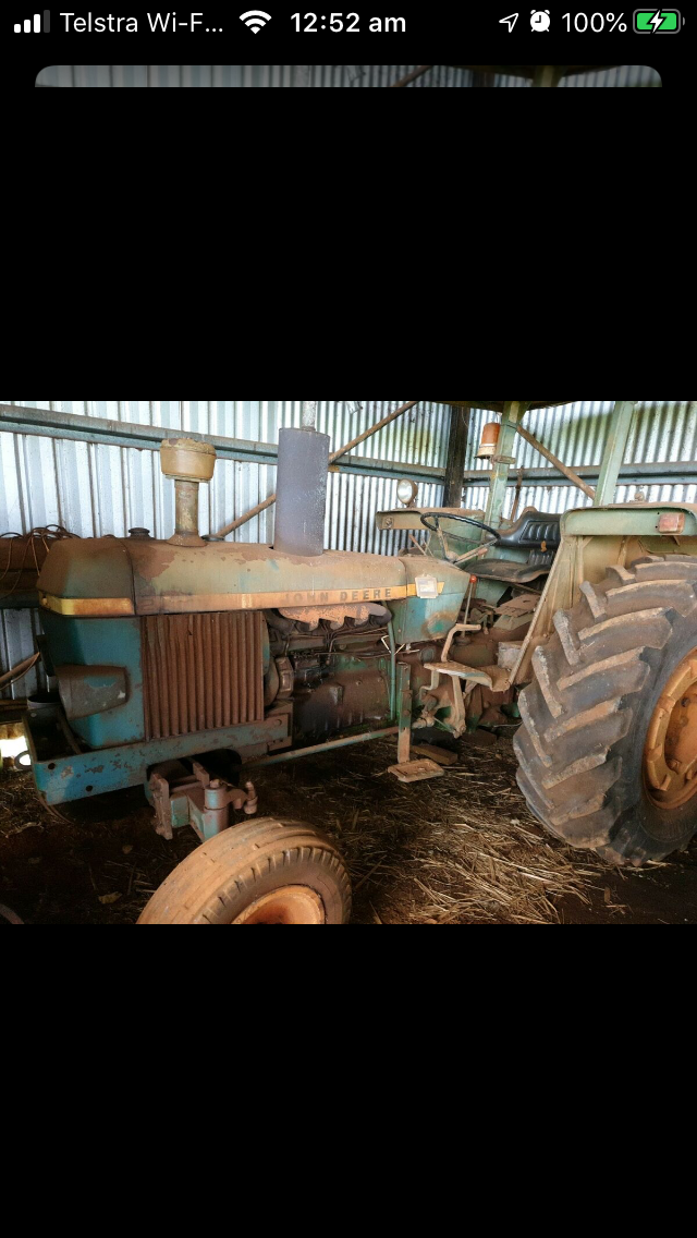

BAD841F0-BAE3-48C3-B248-B2D06917ED9F.pngUmm. Sorry to bother, but got an uneasy feeling. Have I been scammed buying my tractor??? Advertised as a 2140. Have spoken via phone and text all about the 2140. Have just noticed (during night shift) that the picture that I have has a different bonnet to all the 2140s I have ever been near. More rounded, and the decal up the side is black writing on a yellow background, not the other way around. Square rear guards so it is not a 2130, 4 cylinder so it is not a 2040. I am really starting to panic as I have paid the money, freight is organised, and it gets delivered Monday morning. Were there variants in the bonnet? Please tell me yes!!! I hope I have attached the picture properly.

Bonnet(hood) resembles hood for 2140 SN< 429999. Battery covers & door on this serial # tractor will be metal

Thanks Jim. It just looks so much like a 2130 the more pictures I looks at online. Maybe the early 2140s were still this shape then the later ones went to the square shape and different decals. It is doing my head in, literally looked at hundreds of pictures and it keeps resembling a 2130. I can ask for a serial number later today if that helps? Not sure when the 2140 numbers started and ended. Will try and find out. Thanks again.

Hi all. Advertised as a 2140, is really a 2130. Gutted. So was the seller when I spoke to him. Was an honest mistake so I can not be mad at him. So.... with 7hp less, still a reasonable machine? He is up for negotiations if I still want it, and I have the freight organised so I guess I will go ahead. Jim, are those filter numbers the same for the 30 series or will there be some different ones? Cheers all.

Sorry for my mistake. JD 30 series tractor built for sales in N America have a 1 piece steel hood similar to 4020 & 2130 was not sold new where I live.
