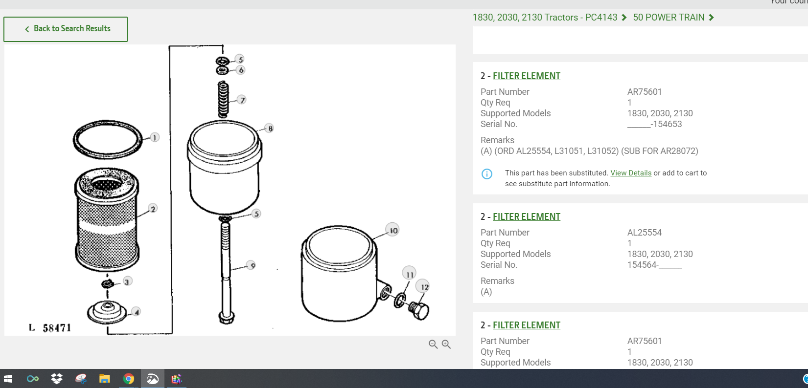

Hey Jim quick one, is there two types of transmission filters for a 2130? One for tractors with hi/lo and one for ones without? I got an AR75603?
   / John Deere 2140 #37
AR75603 fits most JD tractor models built from '61-'92 for sales in N America.
Tractors built for European sales can have different filter part #s which are AR75601 which subs to AL25554. My knowledge of these tractors is sketchy at best.
According to my JD parts cart AL25554 costs 2X what the AR75603
