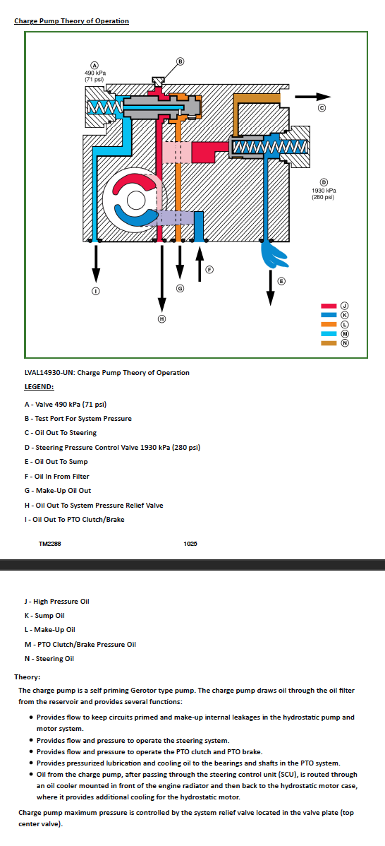

Yes, the charge pump does supply the PTO clutch/brake system. The PTO systems have no pressure either. The charge pump circuit draws oil from the spin-on filter, pressurizes in the pump then supplies oil to the PTO clutch/brake, hydrostatic drive system, and the steering system all independently. Attached is a diagram of the flow going through the charge pump.
So it looks like the test port at B is directly connected to the output of the charge pump itself. Seems like you need a pressure gauge reading here. You could differentiate between low pressure from the pump versus sucking air which would mean almost zero pressure. No pressure output from the pump means you don't compress either one of those springs which means you don't get any pressure to the steering or PTO.
Also I wonder if there was a chance that something got assembled incorrectly in the charge pump when you had it apart
It is possible something was assembled incorrectly. The rotor and idler each have a small arrow on their face that was facing to the rear of the tractor when I originally disassembled it. These arrows don't seem to line up with anything and it wouldn't matter anyhow since the rotor and idler spin and change position in relation to each constantly while in motion.
The charge pump is definitely moving liquid, but I haven't taken another pressure reading since I put it back together this last time (it was previously 0). If I remove the test port plug or the steering system pressure regulator, oil shoots out. It just doesn't seem to be building enough pressure to open any of the pressure regulating valves. It's moving liquid and its going somewhere, just not under pressure through any of the pressure regulator valves.
The last charge pump seal I removed was deformed and blown out the bottom of the housing despite me verifying for sure that it was properly seated when assembling which leads me to believe that the pump housing may be warped from the tractor breaking in half. We will see when I get it apart again.
