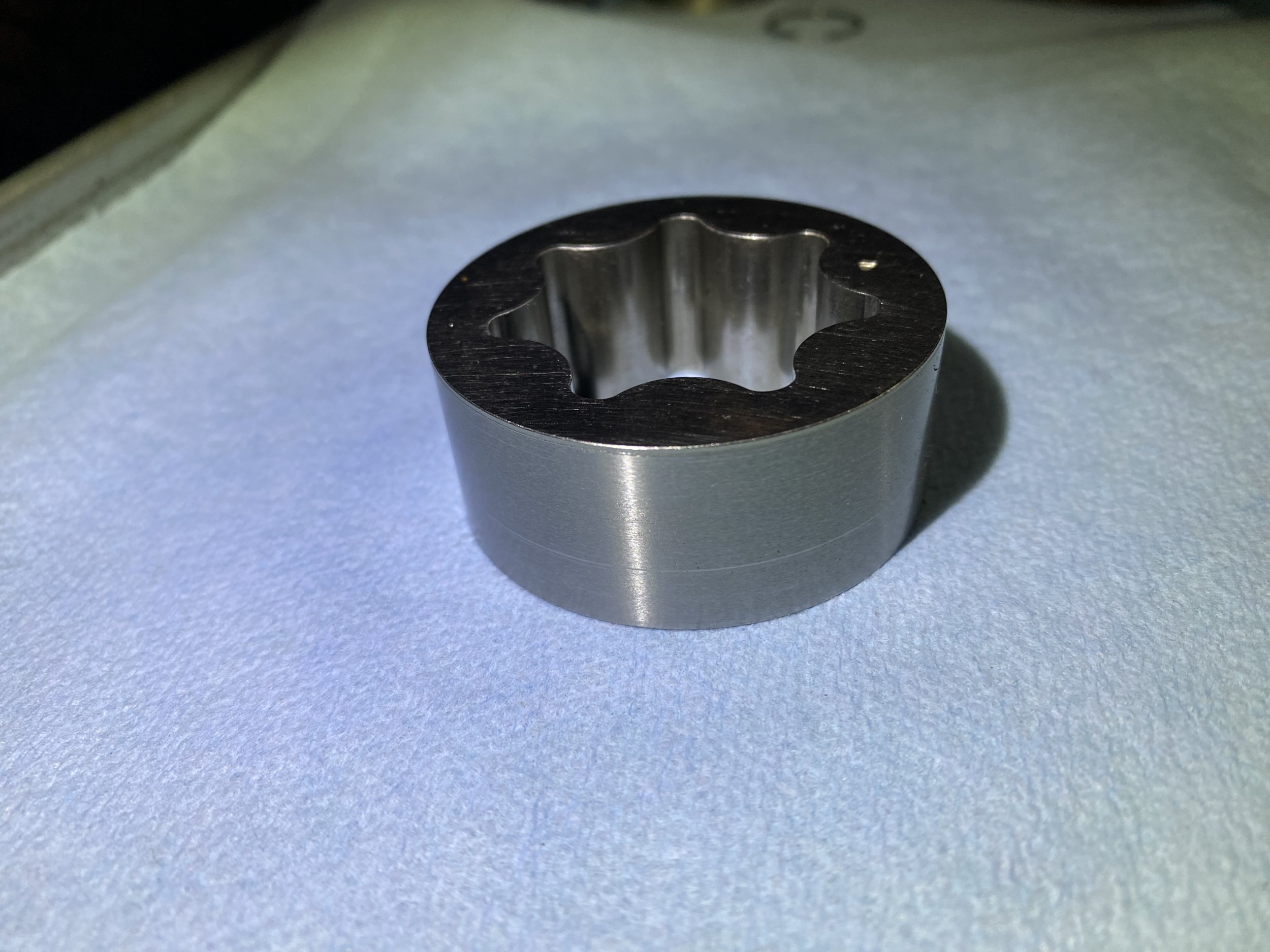

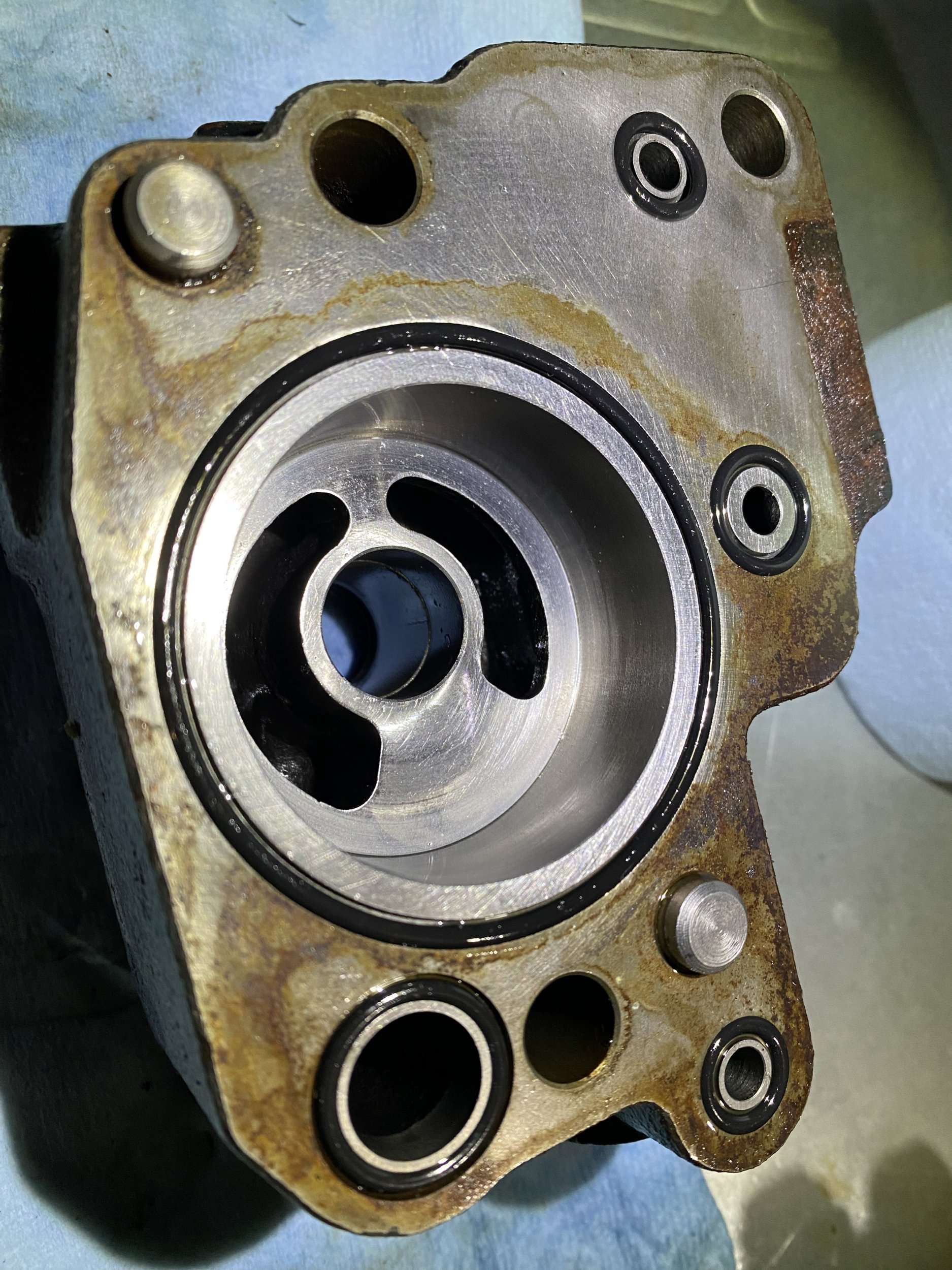

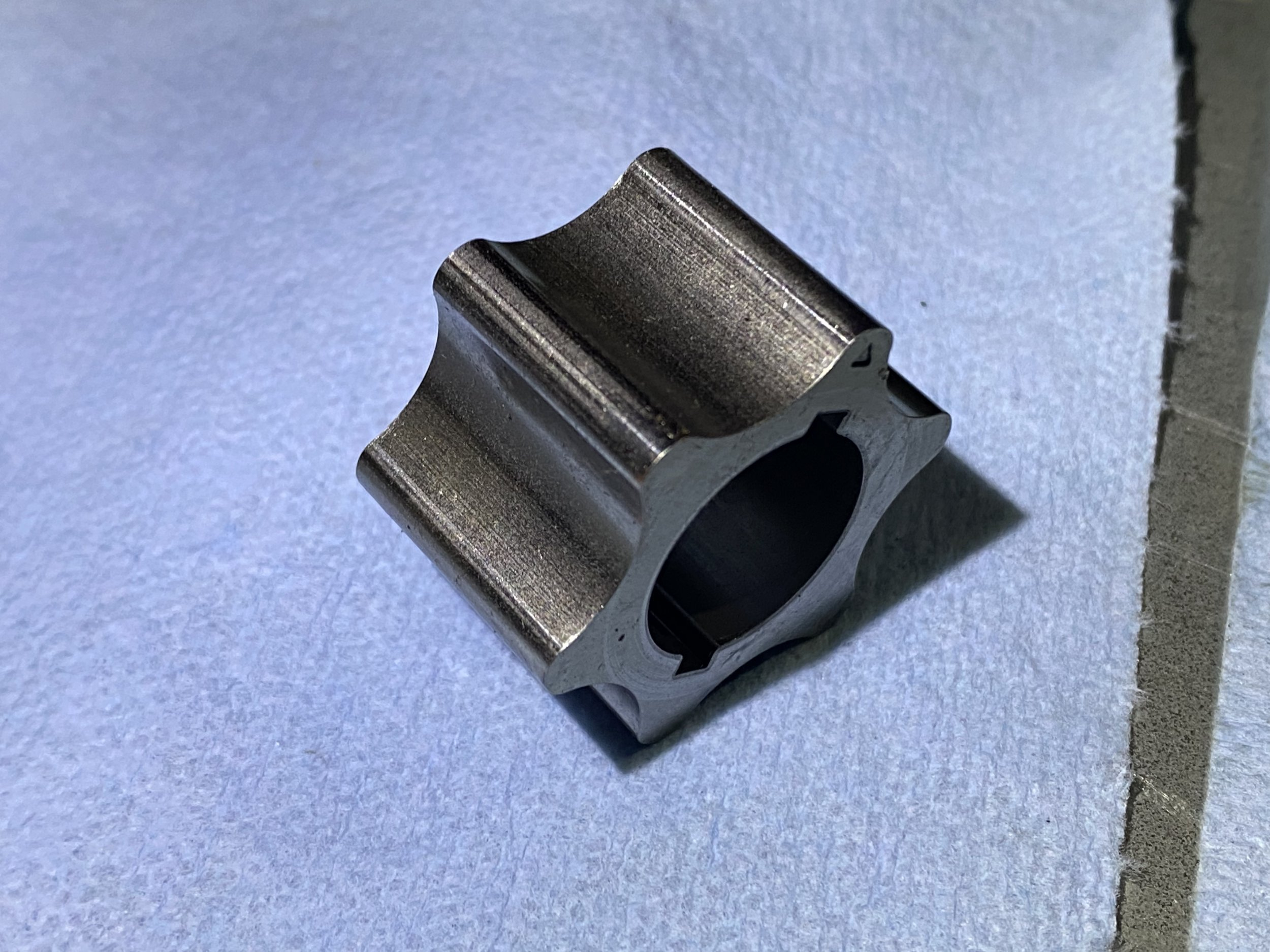

I split the tractor and removed and disassembled the entire hydrostatic drive. The charge pump components all measure well within specs. There’s a little wear on the parts, but nothing you could even feel with your fingernail. All seals were intact. I also removed all the valves and everything was pristine. I used compressed air to make sure the charge pump pressure regulator doesn’t leak. None of the blocks or housings are cracked or warped. I’m stumped as to why the charge pump still won’t create pressure. I guess the next step is just buy a new pump assembly.
