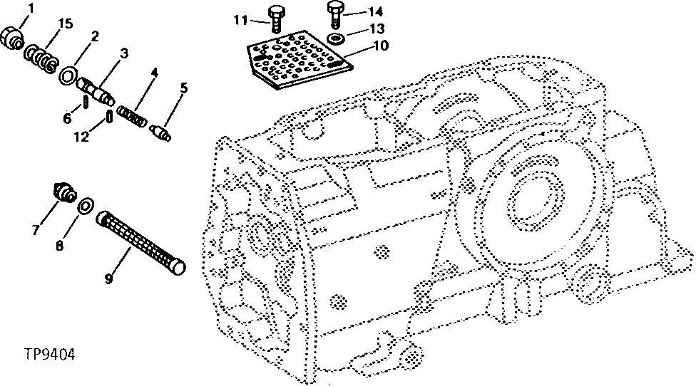

Since the pump has been recently replaced I doubt the drive coupler is the culprit. A high % of pumps are unnecessarily replaced. If sump screen(parts key #9) hasn't been cleaned lately I'd highly recommend it. Filter relief valve(parts key #3) could also not be seating. Have you tried checking stand-by psi?

   / John Deere 310 A hydraulics quit! #32
No I haven't checked any pressures yet. The machine is in the woods while we were digging a hole it died with the bucket in the hole and it getting cold up so I think we're going to have to wait for spring.we got it all covered up for the winter

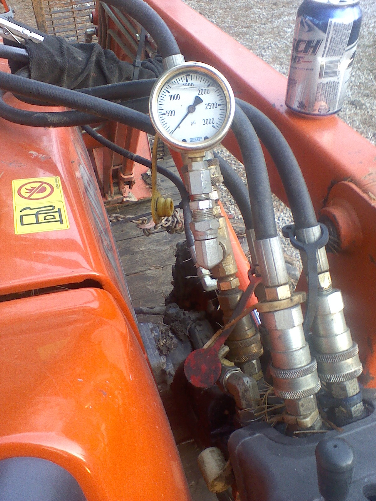

What kind of Gages and fitting would I need to do this pressure test. I could locate them over the winter.
   / John Deere 310 A hydraulics quit! #34
You'll need a 3000 & 300 psi gauges available from Surplus Center for under $25.

Make up something like these and for a permanent installation, just install the hyd gage in a tee in the IN port of the first valve and mount where you can see it. Then use it for monitoring and troubleshoting.
