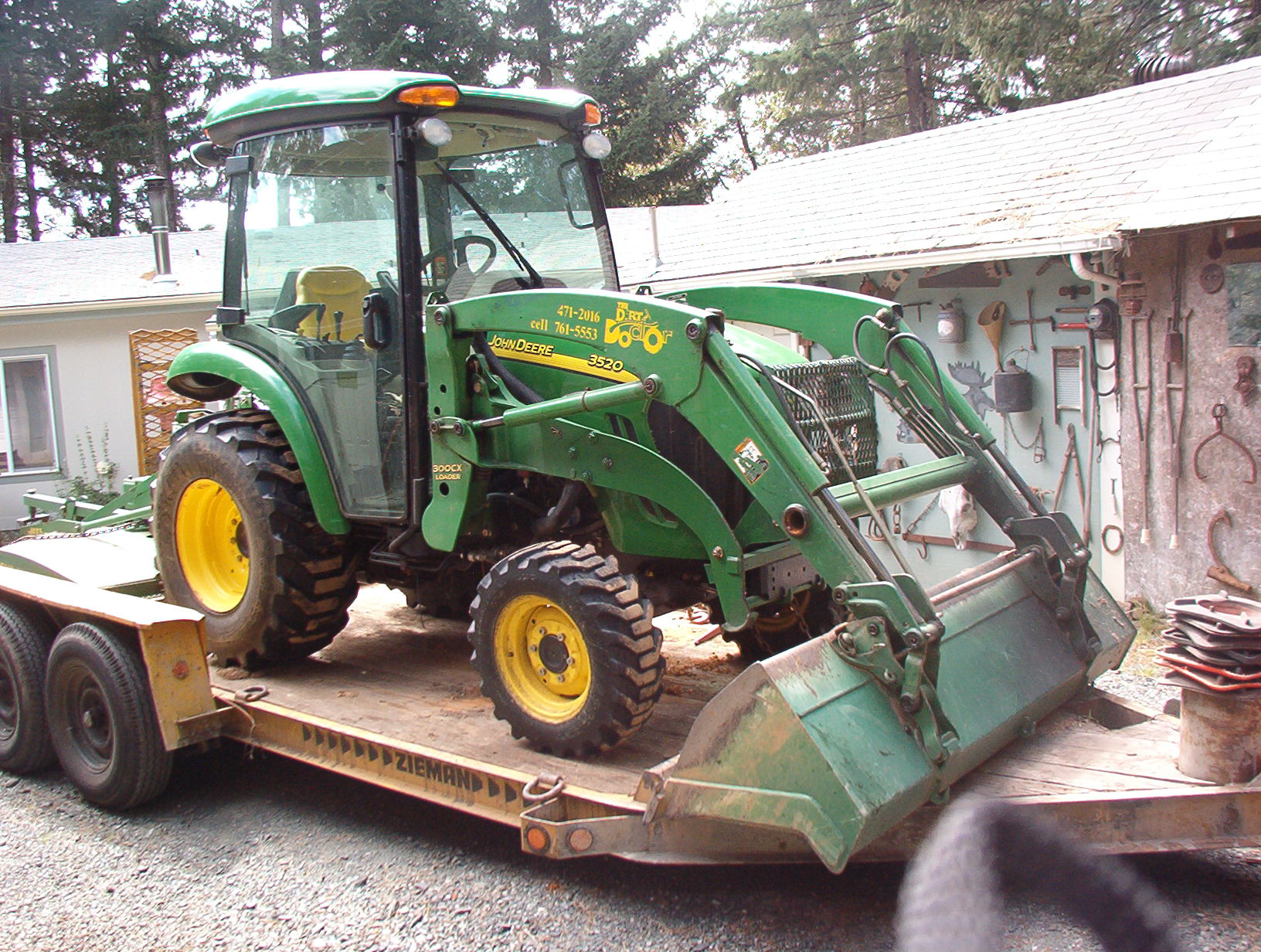

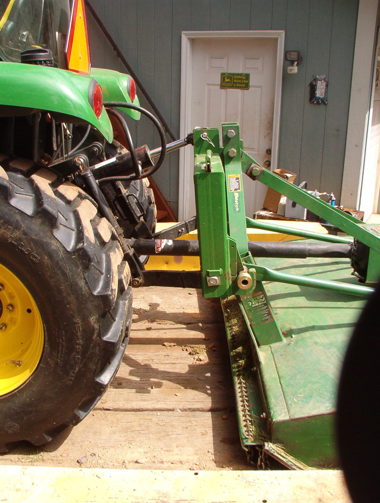

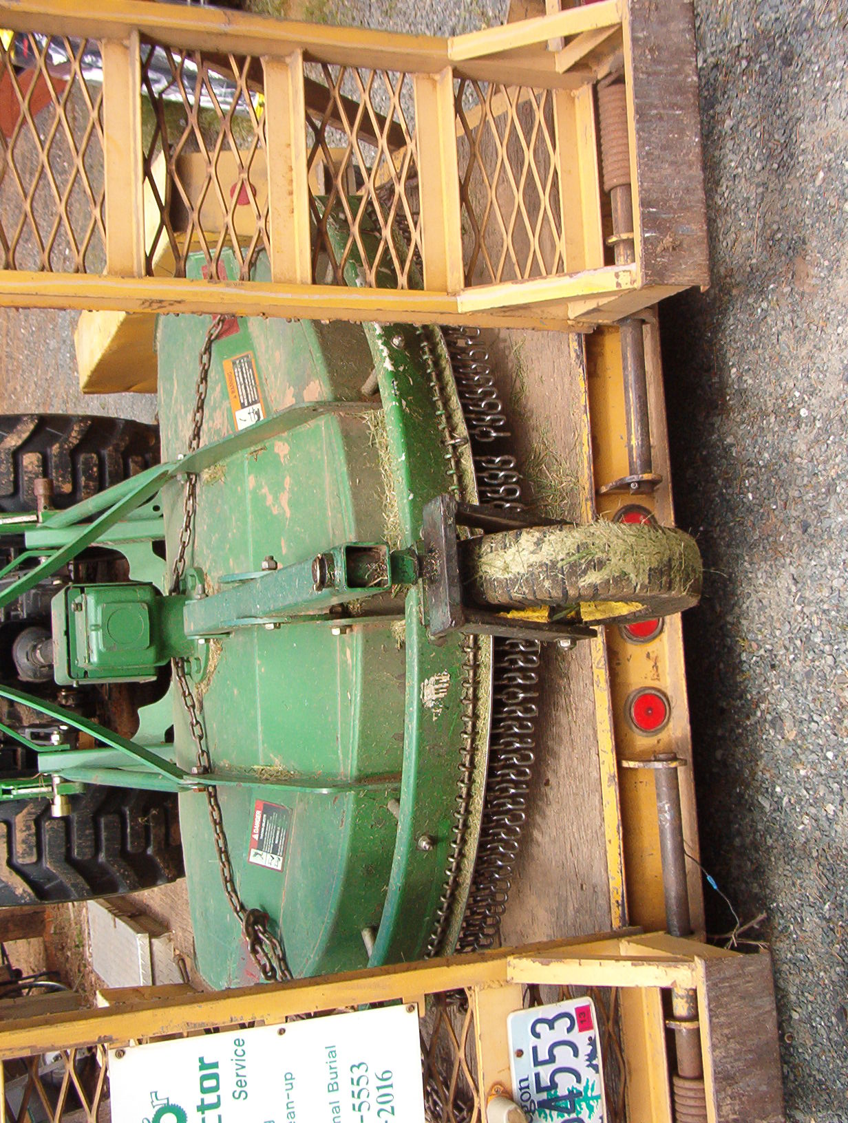

The 60" is a good size for the 3520. I have mowed fields 4'+ and have had no problems. Here in oregon, we have blackberry bushes that love fencelines. I have found my MX5 John Deere mower can handle heavy brush equally as well. The safety chains are the way to go since they do not lay the grass down and protects the driver from flying debris.
As for the slip clutch, I have replaced only one disc on a large Gearmor tiller, otherwise have never had a problem. No need for adjustment unless you find the mower not working properly, then you adust the clutch according to manufacturer's specifications (invest small torque wrench and that's it).
I believe the commercial mowers all come with the slip clutch however I could be wrong. Here are a couple of pictures of my set up.

Nice set up Bluebuck. I like the pictures. I measured my tires to make sure 60" would be wide enough. Looks like from your pictures it will be plenty wide. I got some more prices on Rotary cutters.
