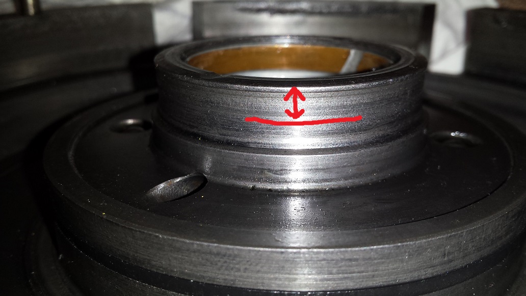

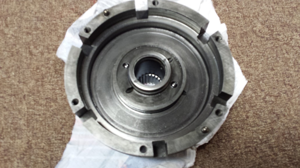

My forward clutch drum outer shaft is worn down some because the snap ring broke for whatever reason and the clutch pads are no good so I have to get new clutch pads and plates and I’m going to see if I can get my drum welded back up and machine down to the right size again and I was just wondering if anyone would know how far down the shaft the snap ring grove is supposed to be because it’s wore off and I’m not quite sure of the measurements from the end of the shaft to wear the grove is supposed to be. Does anyone happen to know?
Thanks, Jack
PS: The drum is a R39113 or SUB for that is a RE61163
   / john deere 410 backhoe barely moves forward but moves in reverse ok #23
I looked on JD parts and spec's weren't listed for the drum. Have you considered getting a drum from salvage yard?

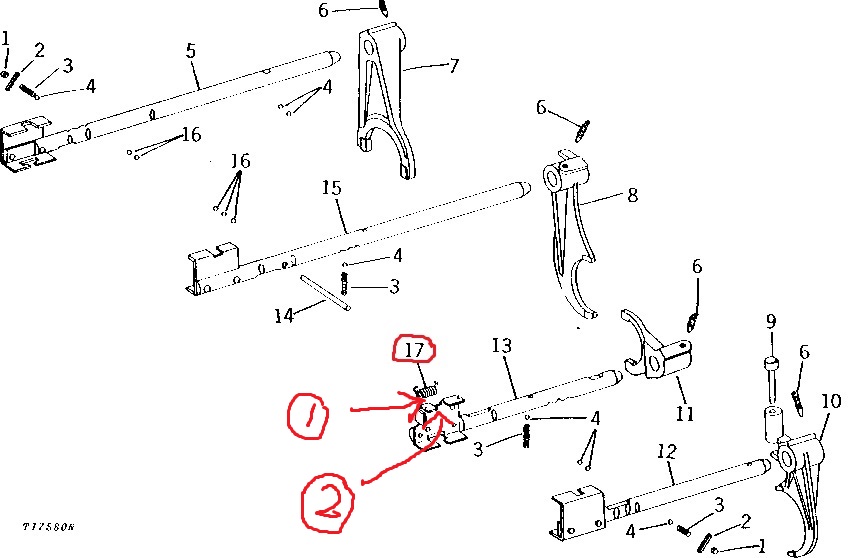

Hi Guys I'm back with another question,
I'm ready to put my backhoe back together now but I'm not sure where # 17 spring come from because it was in the bottom of the transmission.
The end of the shaft # 13 the corner of the plate was broke off at the end so I welded it back on and it has a couple groves in it so I think it clips in there but not sure if it clips on top where I have marked #1 or under neath where I have marked #2' Could anyone tell me where this spring goes for sure.
Thanks
PS: I tried the spring on top and it did not look right so I put the spring under neath to try it and it blocks the square slot where the shifter come down threw so I知 not sure.
   / john deere 410 backhoe barely moves forward but moves in reverse ok #26
Spring(parts key 17) goes on shifter plate & IIRC it attaches on the top of plate.
#27
Hi Jim
Thanks for replying so quick and your saying IIRC what is that something else the spring attaches to or it just attaches to the plate from one side to the other in the groves on top.
Thanks again
   / john deere 410 backhoe barely moves forward but moves in reverse ok #28
IIRC=if I remember correctly
#29
O ok
I tried it under neath but it didn't look right so it's on top now and I hope that is where it goes thanks
