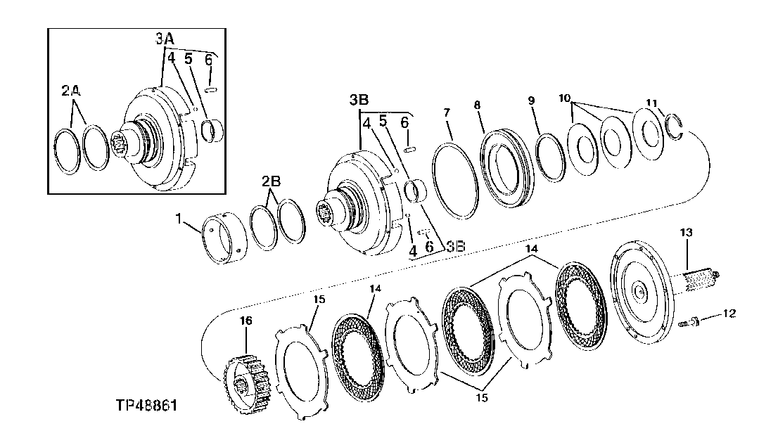

I haven't been on this thread for a while, so I scanned back through the posts. After seeing the picture of the worn clutch drum, I wonder what your piston looked like. Are you sure it wasn't worn and causing leakage from the seals? Also, did you replace the metal sealing rings on the back of the drum where it fits into the clutch housing? The bushing/sleeve that the sealing rings seal against often gets worn and needs to be replaced. New sealing rings won't seat on an irregular surface. REference items 1 & 2a or 2b in diagram. Also be sure to check the forward/reverse linkage to be sure it is shifting fully into forward.
   / john deere 410 backhoe barely moves forward but moves in reverse ok #50
The sealing rings in the forward clutch housing were rubber on my 410. But that snap ring groove wear looks bad. I would test clutch lockup with air. I bet it needs a new housing. I bet it's under 300 to buy. Better than scrapping it.
