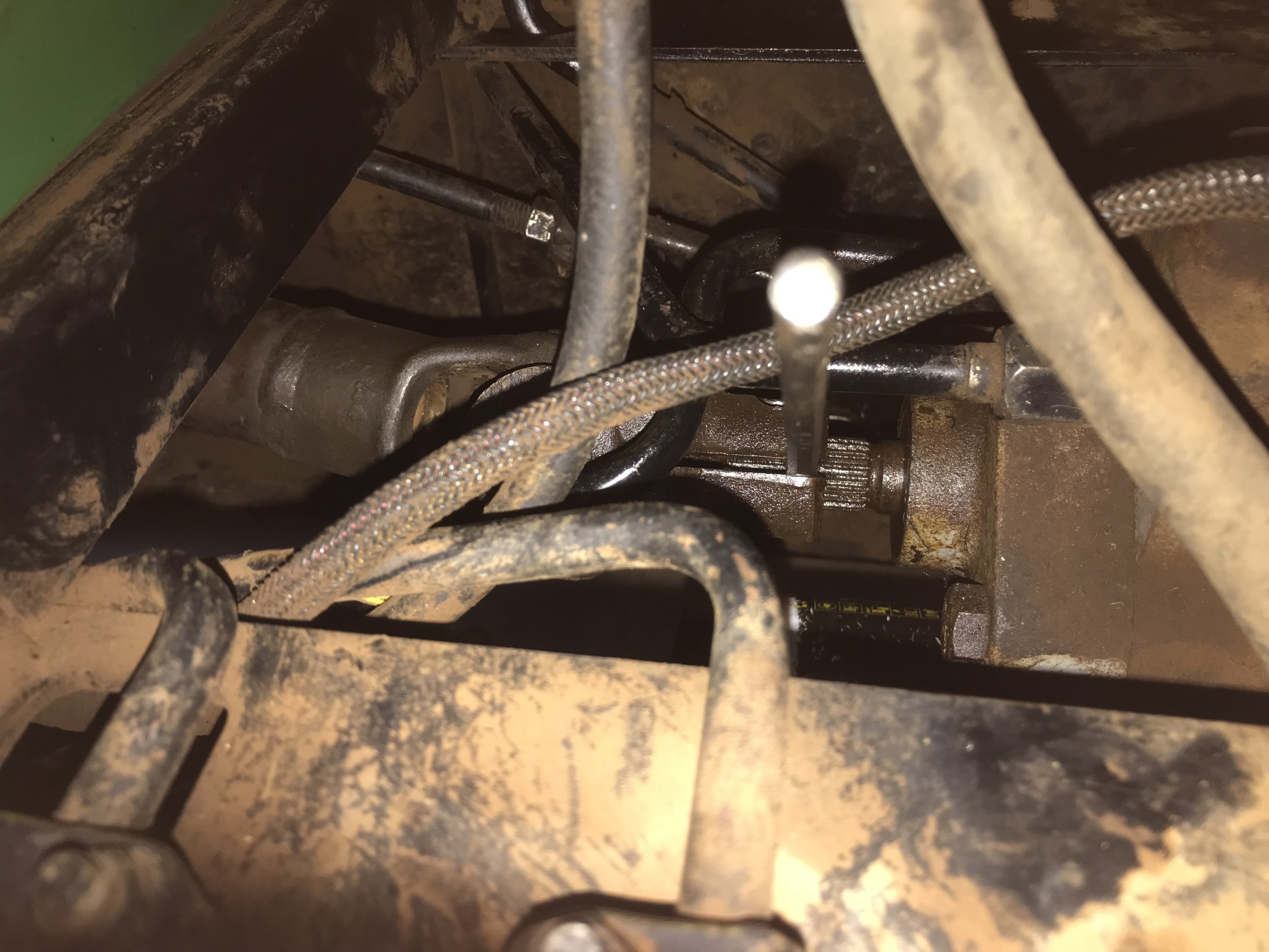

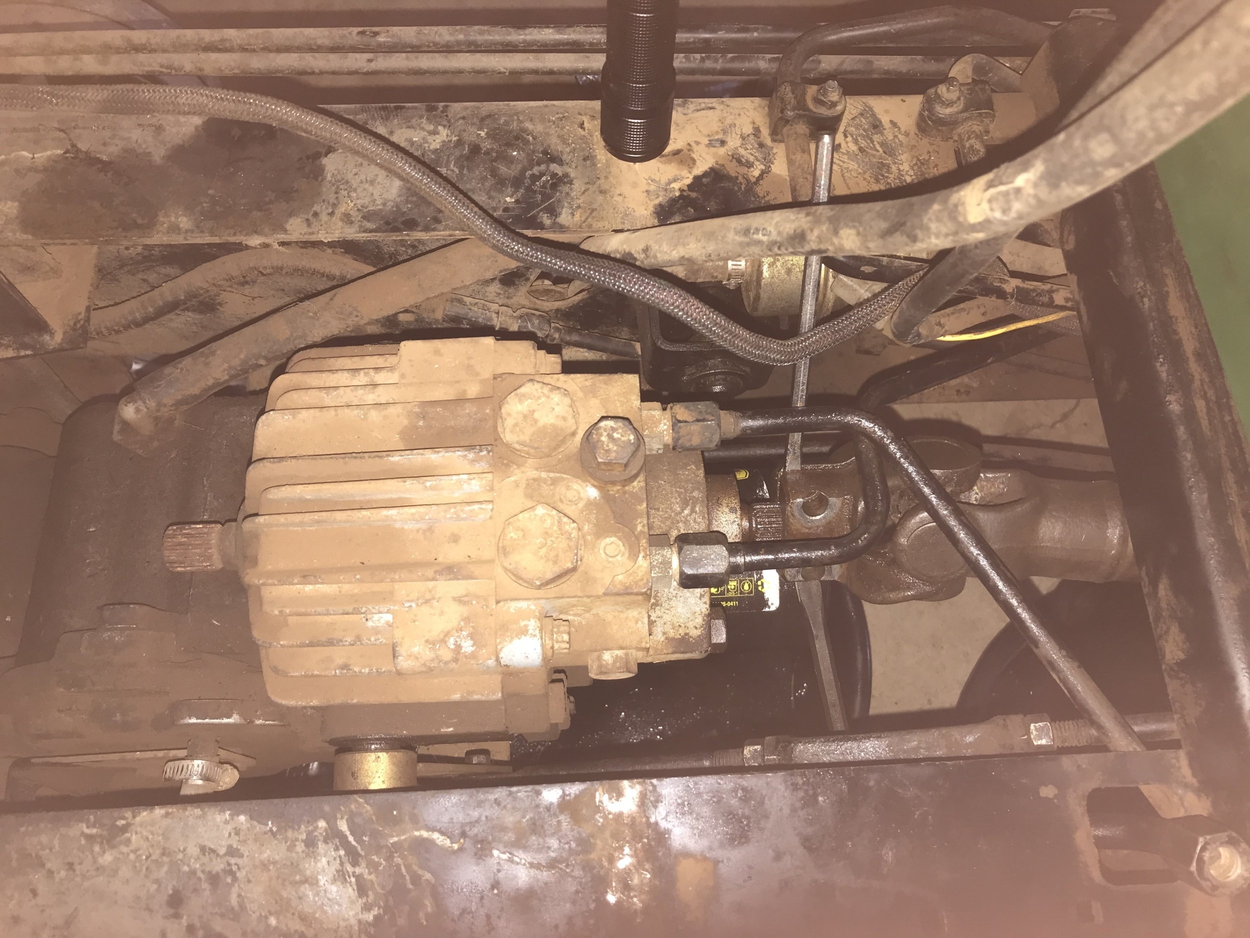

Update:
The driveshaft yoke was rusted solid onto hydro input shaft, but it did slide out pretty easy after soaking it with ATF & acetone mix for few days, as suggested earlier in post #15 by 5030
The chisels helped to get the penetrating fluid in the right place for sure, but they need to be removed before trying to slide out the yoke - otherwise they will make the yoke to bind on!

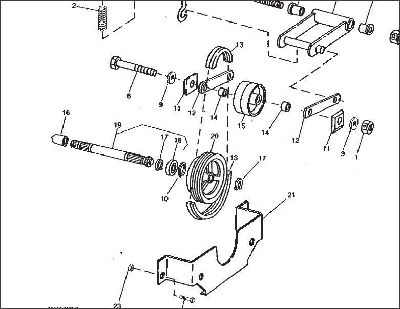

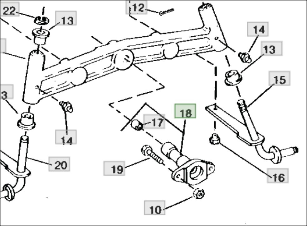

The JD430 is now tentatively back together, but I plan on revisiting the front axle and mower PTO setup bearings after having done little more test driving etc.

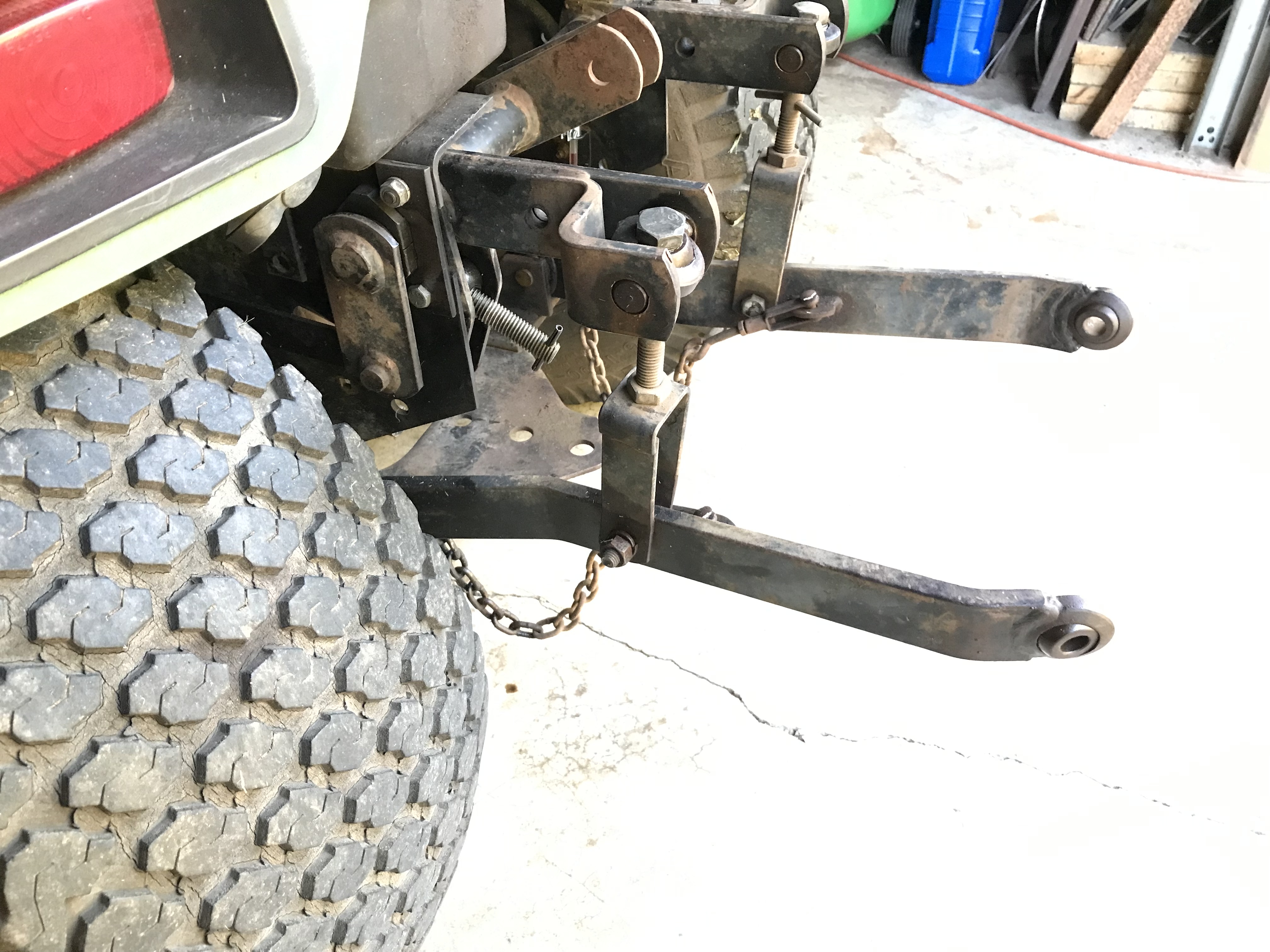

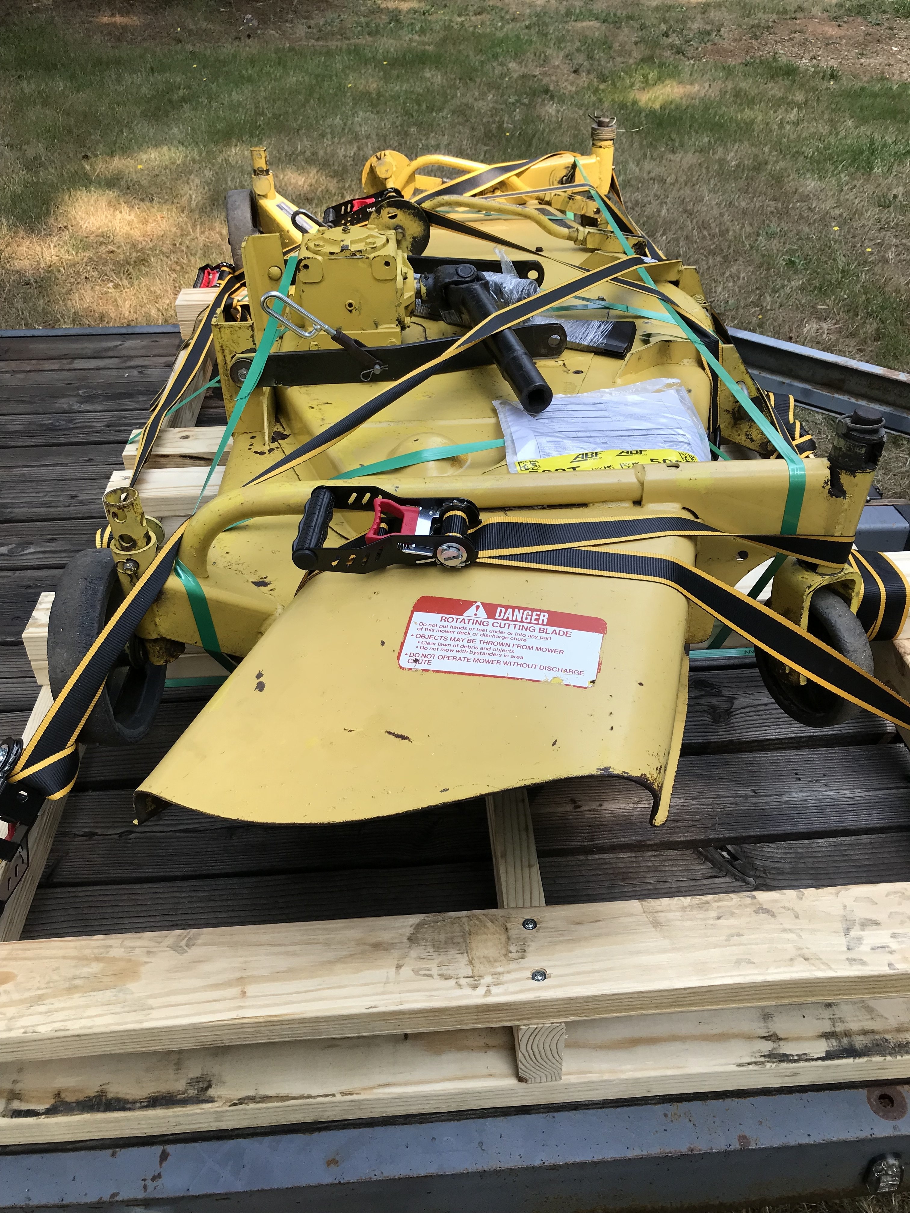

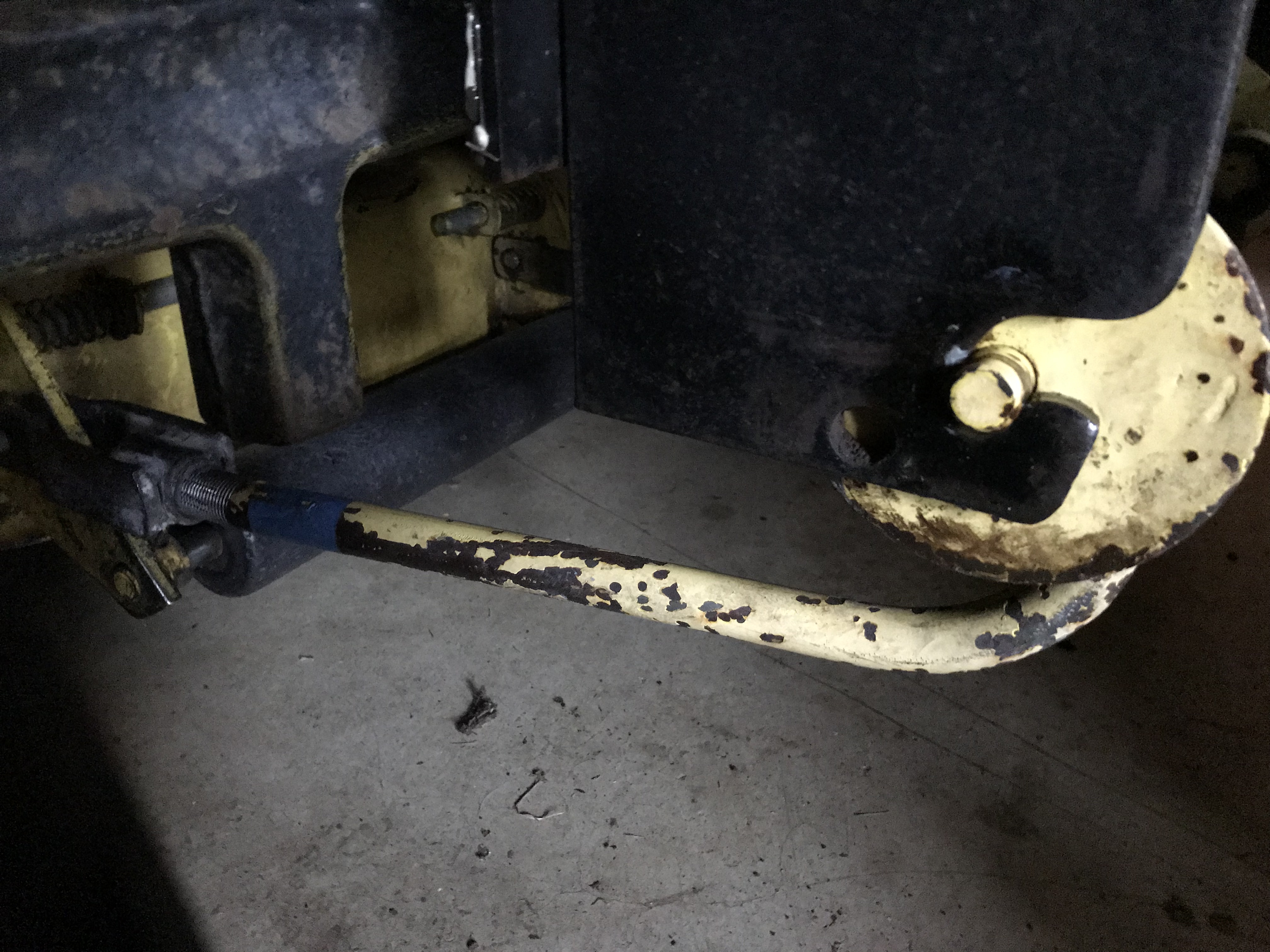

The tractor came with 50" mower deck and I purchased a used 60" JD400 deck and am in process of fitting it to JD430 which seems like a not bad fit, but required some fiddling with the front draft arms and pivot shaft.
The deck fits and the draft arms are now good fit:

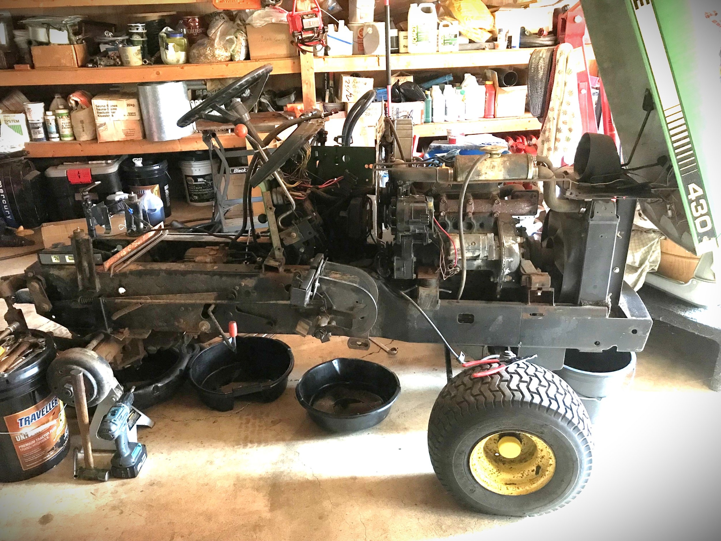

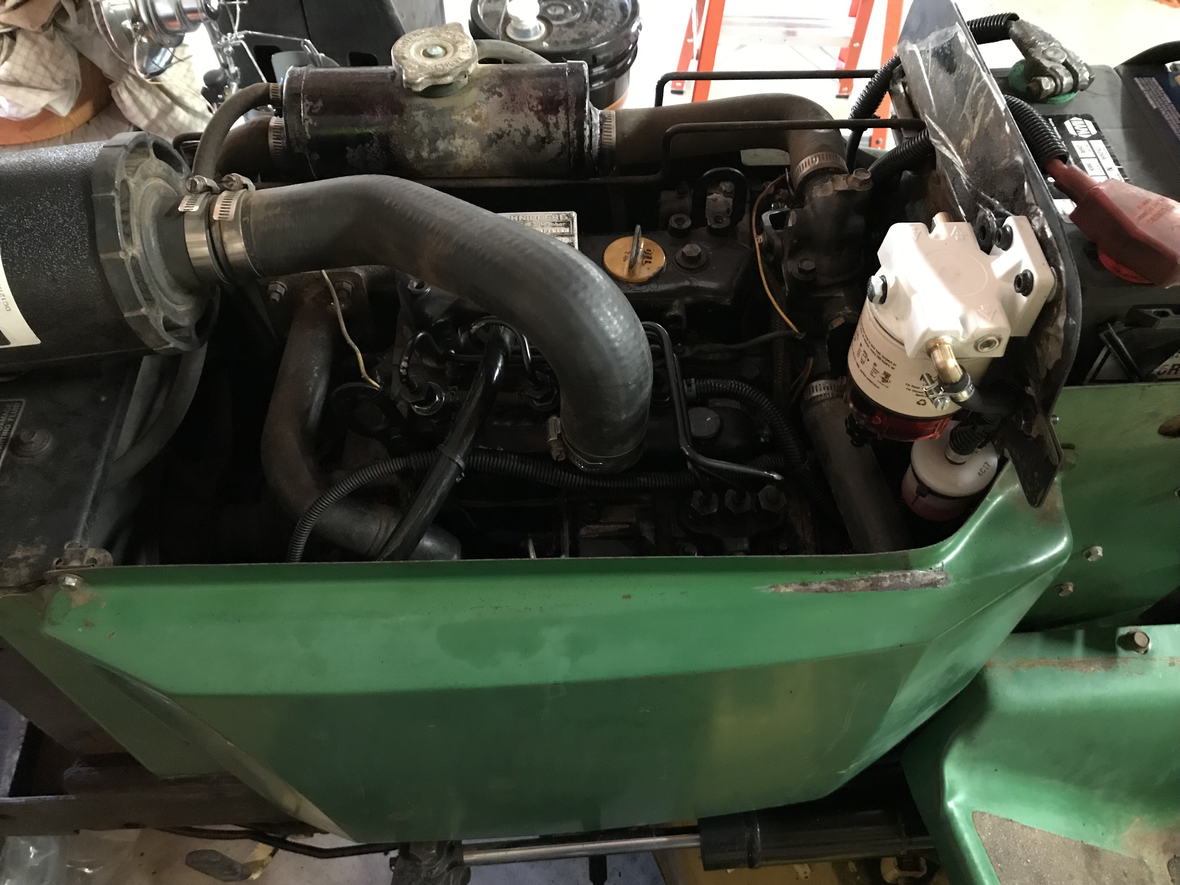

Update:

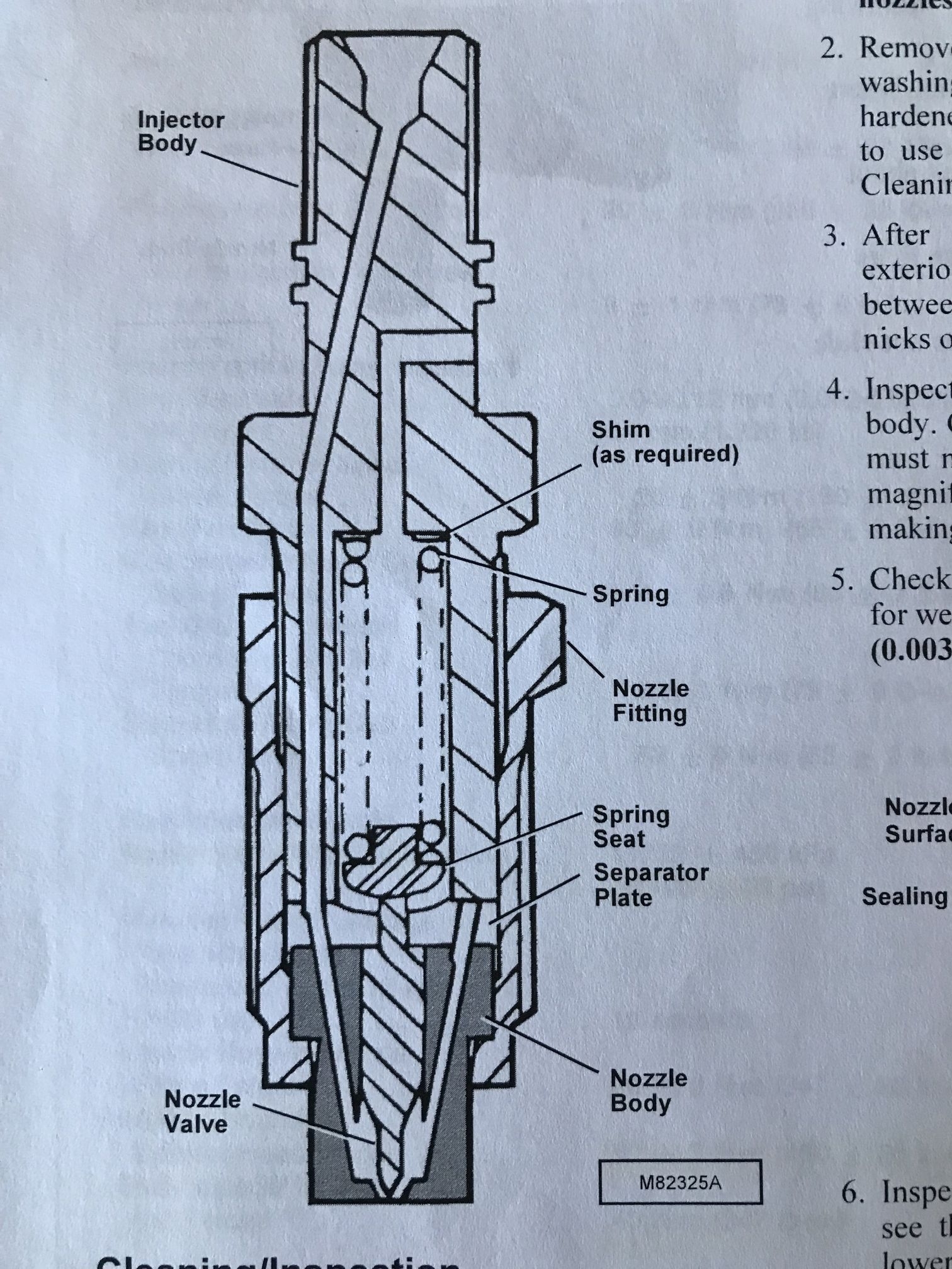

After putting the engine to work for awhile I began to notice little uneven idle, unlike earlier so decided to do engine compression test which gave excellent on-speck results - no big surprise with only about 780 hours on the meter.
Next test was a quick fuel injector spray pattern, which turned out to be pretty poor on two out of three!
Took them to a local Diesel shop for rebuild.
Apparently the spare part nozzle body and nozzle valve on these have been updated so hopefully these will last little longer.

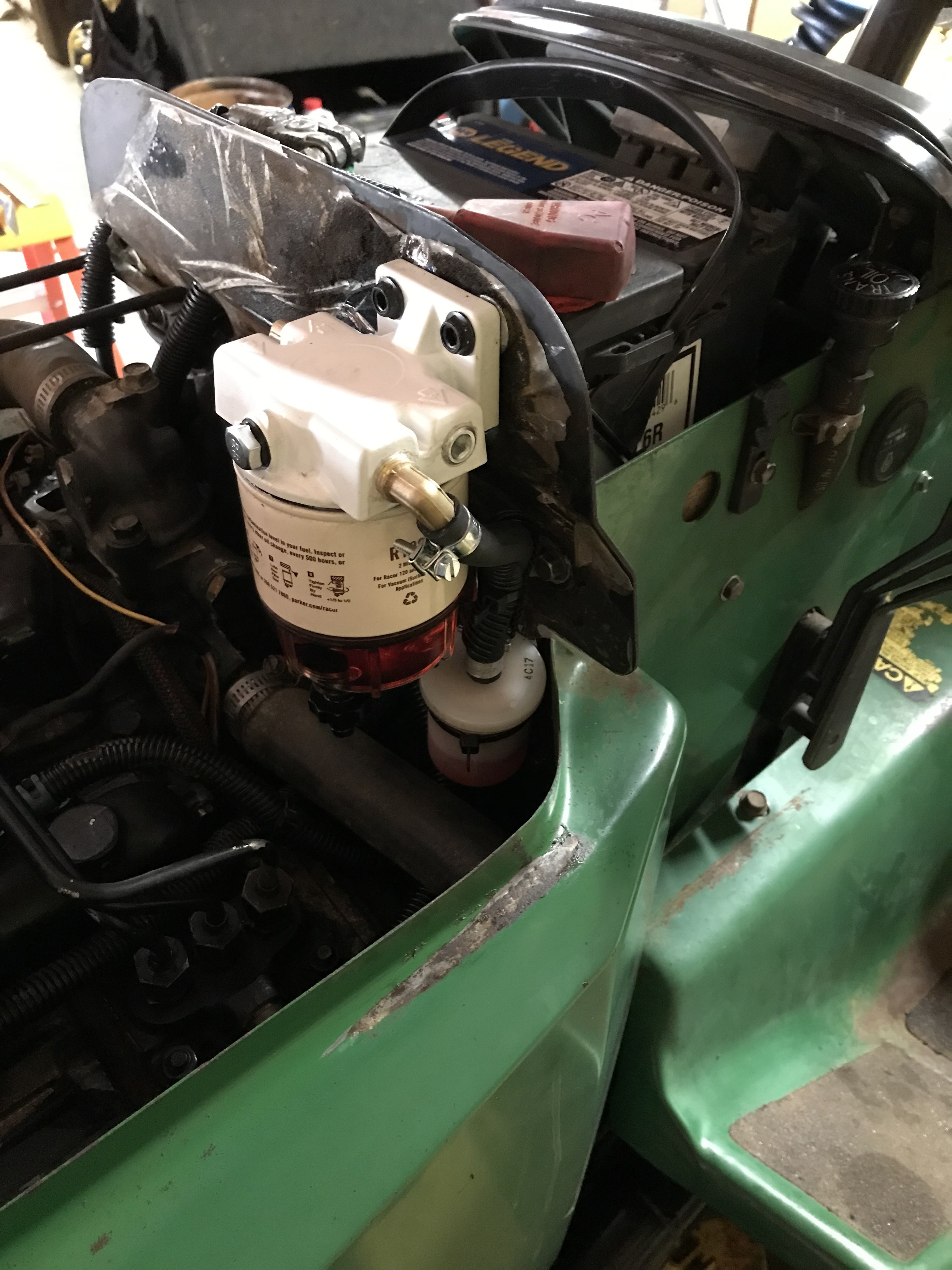

Due to (prematurely) worn fuel injectors I also decided to change the original single Stanadyne 10 micron fuel filter to a setup with a 50 micron primary filter, followed by 2 micron secondary filter.
Runs smooth now (that is smooth for a tractor engine).

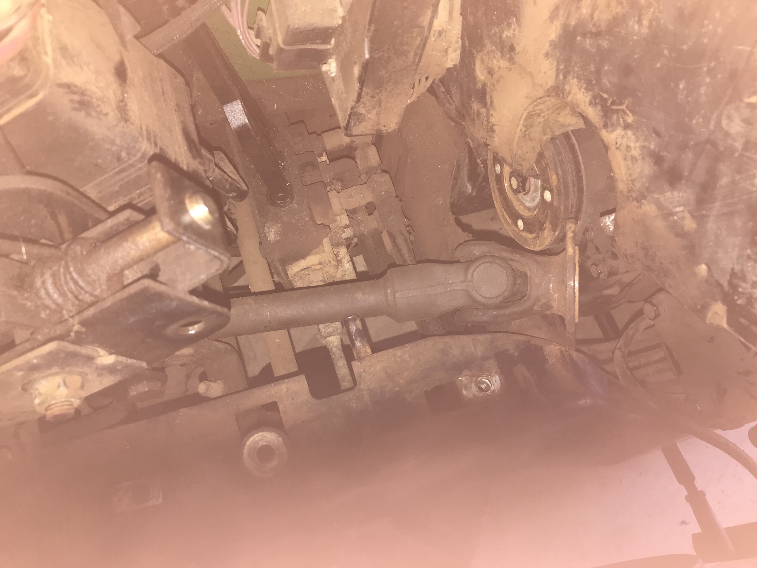

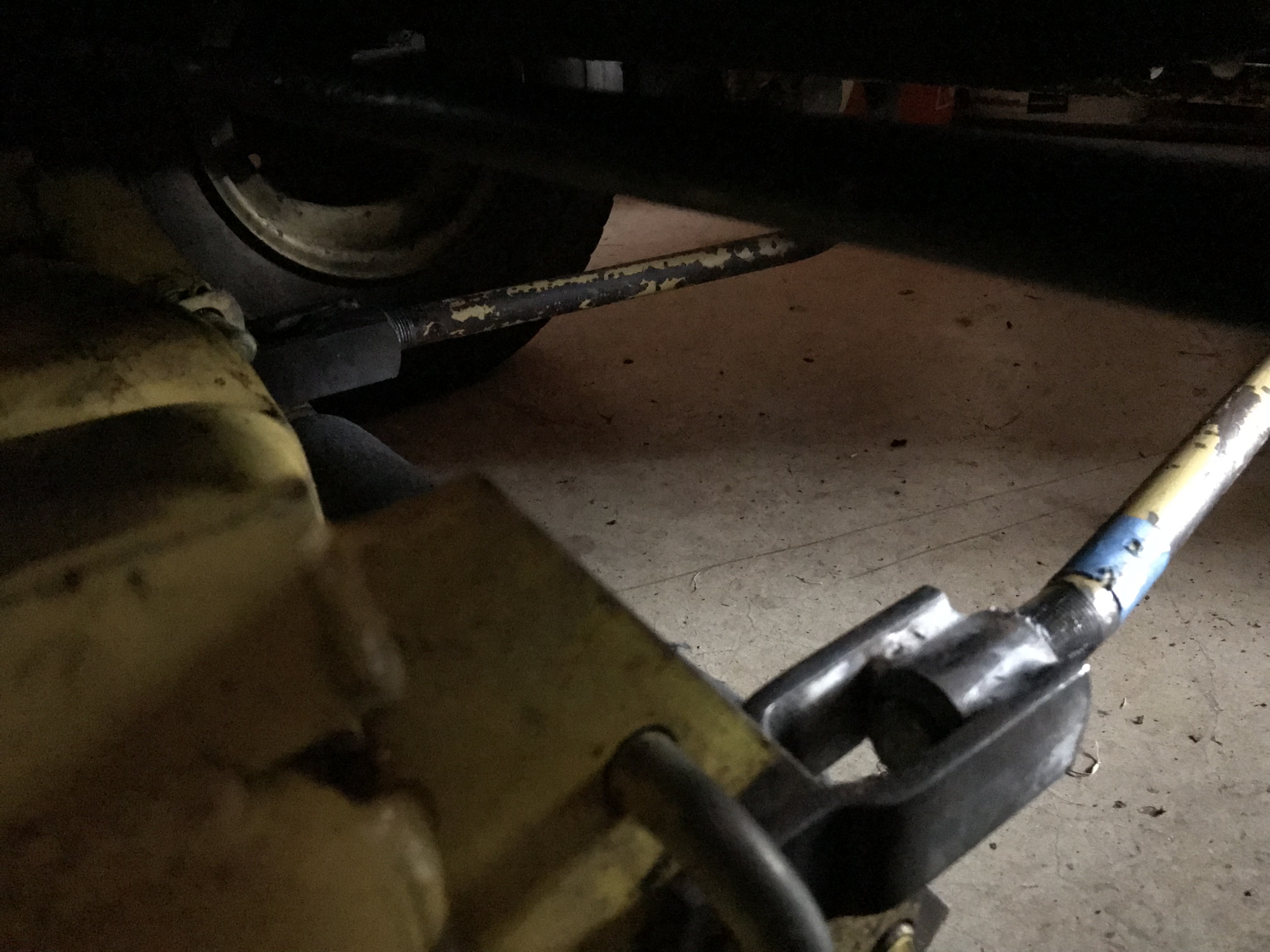

Update
My plan all along was to service & dismantle my "new" 87 JD 430 enough to be able to inspect hydraulics, drive train, belts, drive shafts etc. in order to repair or replace whatever is needed, in order to make this into a long term use reliable garden tractor.
I have ran into a little difficulty when trying to remove the drive shaft rear yoke from the hydrostatic pump shaft!
It looks like it has never been removed previously, and has gotten stuck in the shaft (IE. rusted in place over 37 years). The front end is already loose and has cleared the engine V-belt pulley so that's not holding it.
I've been spraying WD40 over two or three days and trying to removed it gently, without hammering chisels in too hard in order to loosen the yoke.
Hammering chisels in too hard could easily damage the hydro pump outboard bearing & shaft surface.
Anyone else here who has had to deal with the same issue?
Panels removed for better access:
Two chisels, one on each side of the yoke split:
Lots of WD40, but so far it has not budged:
Switch to PBlaster Arto. PBlaster and a bit of heat from a propane torch and it will come loose. Needs a bath underneath and some JD yellow paint on the wheels but I know you are a resourceful operator. You are like me, we hate grime and dirt. Actually, I use PBlaster every time I attach or detach any PTO coupling. It's an excellent rust release agent and provides lubrication to sli8ding surfaces. I use it all the time. I have a gallon of WD in the shop I never opened.
