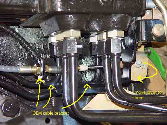

Here is a link showing the hydraulic kit installation I did, which illustrates the fender mounted levers. Picasa Web Albums - Matt - Hydraulics Up...# My gripe with the cable is that it is a 1:1 motion with the valve spool, while the Quadra-Stat (brand name) lever assembly has lots of motion available to it. The 1:1 motion makes it tough to feather the valve, which is why I'd like to come up with a mechanical linkage arrangement to take advantage of the lever's range of motion, while operating the spool within its parameters.
Very nice pix, Matt!
I went back and looked at them closely. I have scribbled on one of them
to show what I am doing. The 3rd SCV cable bracket and the PTO lever
bracket that goes on top of the valve are visible in your pix, which is more
than I can say for the manual. I bought (rather than made) the PTO lever
bracket cuz I did not know precisely where it went as my bracket and
lever were missing. These brackets often run $60 or so, so I make them
myself if I have enough info.
I will make my version of the "OEM cable bracket" and I will drill a new
pivot hole in the 3rd SCV "bellcrank". Is the original pivot hole what gives
you the 1:1 motion you are talking about? It is true that the moment
arm ratio between the pivot and the spool is about 1:1; I am increasing that
to about 1.5:1 with a new pivot. My cable has plenty of stroke and the
spool has a very strong internal spring.

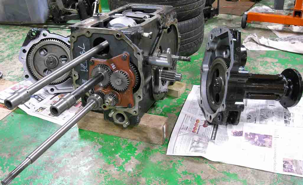

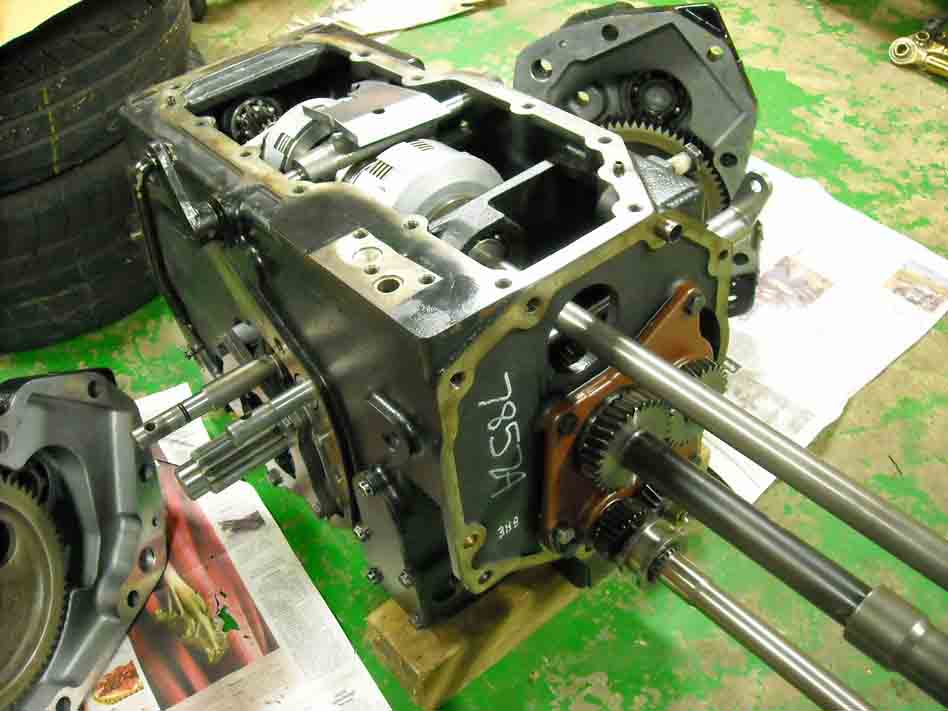

OK, here comes the final assembly.
First is my rear end and gearbox. Getting those axle housings on is not
easy....you have to line up the splines of the brake system and get all
the shafts thru the right holes before the silicone gets tacky. But
they are not heavy anyway.....that's the only reason I am glad they are
aluminum.
I am going to try to do these in order, so stay tuned.
You are right that all your cables and hoses make quite a rat's nest! As
you found out, even the factory setup causes some interference.
I hadn't thought about adding a hole to the bellcrank like you are planning on doing. What I've been thinking about doing is replacing the cable with some sort of 'Rube Goldberg' series of levers and rods to allow near full movement at the operator's lever, which is probably a 60-degree arc; but step down the total movement when it reaches the spool. Right now it's not a high priority item, so I just dabble with it in my mind.
