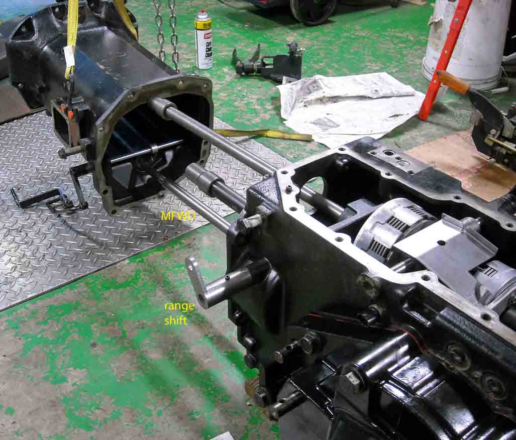

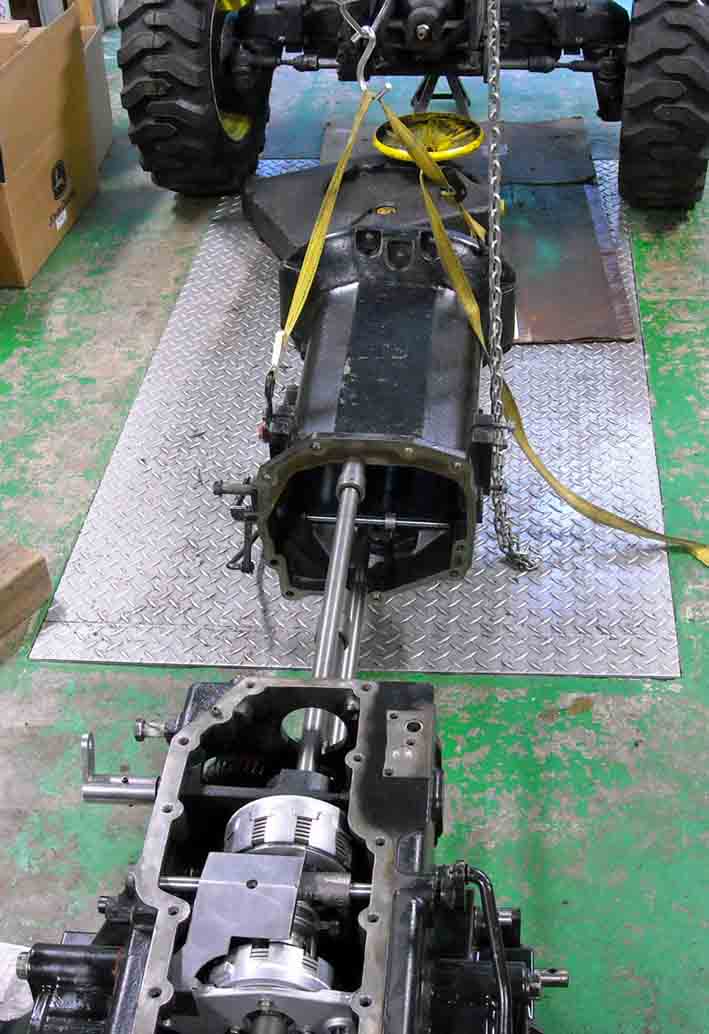

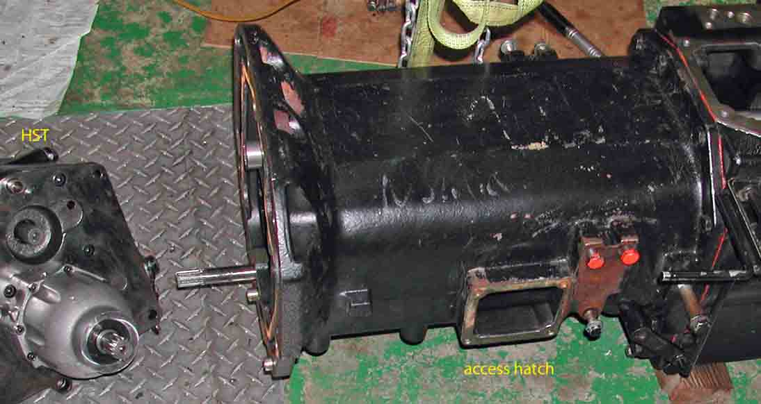

Here I am installing the tunnel section onto the gearbox. When I took
these sections apart, I was outside and I used my loader to lift and
separate. That was pretty crude and imprecise.
To put them together, I am using an overhead hoist and trolley....the
tunnel weighs about 200# and the MFWD drive shaft has to be accurately
guided into its bearing and seal. To add complications, the 4WD shifter
fork has to be guided onto the shift collar inside the tunnel. That is what
the access hatch is for. You have to stick your hand in there about
10 inches or so and wiggle the whole tunnel and fork to get them to
mesh properly. (I couldn't do this if I had my dad's gargantuan hands.)
Still, it was disconcerting to have your hand in there, wedged between
sharp-cornered chunks of steel in a massive moving structure.

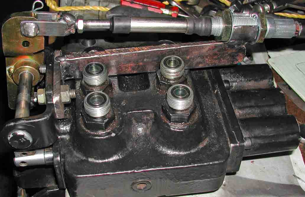

I hadn't thought about adding a hole to the bellcrank like you are planning on doing. What I've been thinking about doing is replacing the cable with some sort of 'Rube Goldberg' series of levers and rods to allow near full movement at the operator's lever, which is probably a 60-degree arc; but step down the total movement when it reaches the spool. Right now it's not a high priority item, so I just dabble with it in my mind.

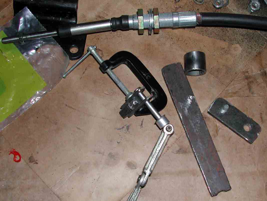

I just made these parts last night. The new hole in the bellcrank will give
my cable more leverage, while assuring full travel of the spool. I noticed
my bellcrank hits the factory mount when actuated in one direction, limiting
the spool travel. I fixed that by grinding the bellcrank a bit. My cable
came from SurplusCenter for $18, BTW.
My push-pull cable shown here allows more than an inch of travel in each
direction. If your hand lever restricts the cable travel, maybe you can
relocate the pivot hole on that lever? Could be tough. How do you like the
friction action of the levers?

I don't care for the friction action of the cable on the levers. I'd rather the spring in the valve spool return the lever to center and the cable's natural friction prevents that. Of course if one needs the valve to stay open on its own, then the friction fit is probably a good thing.

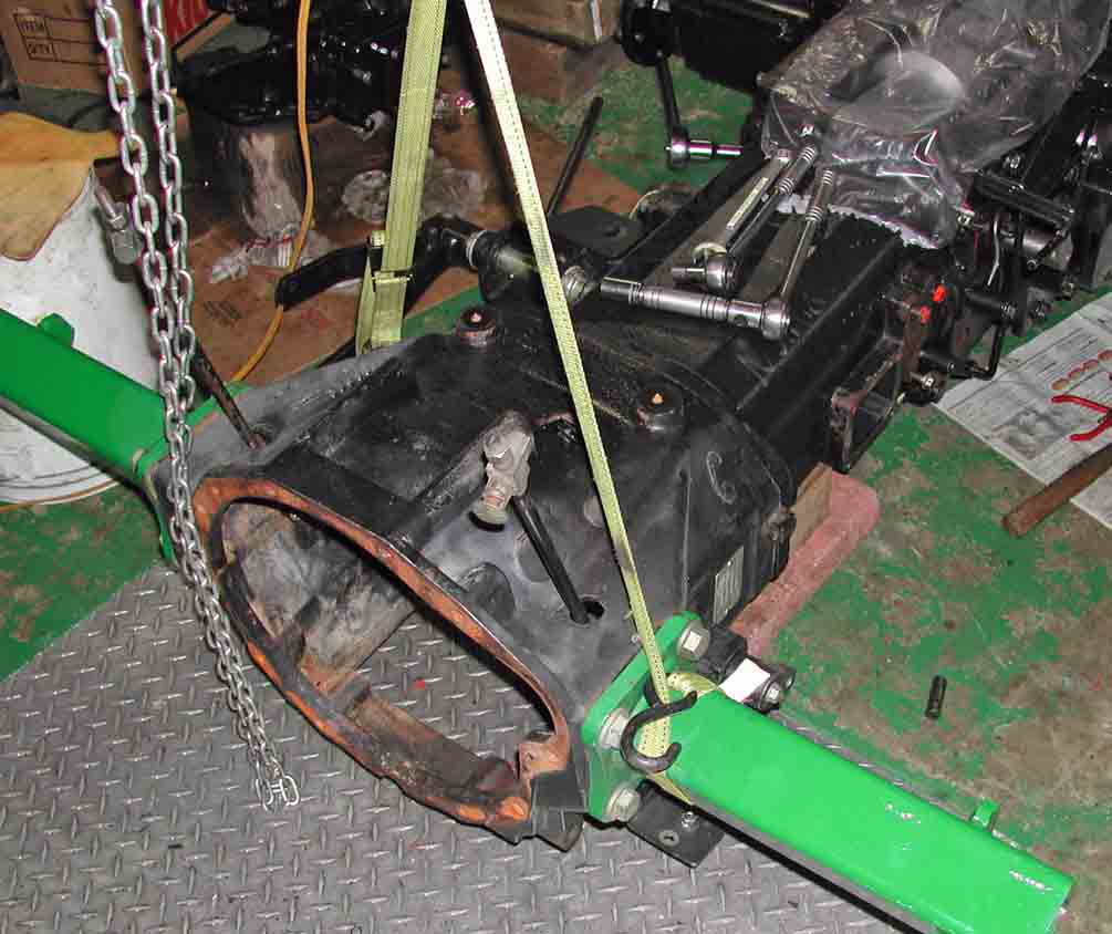

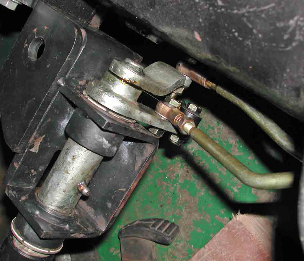

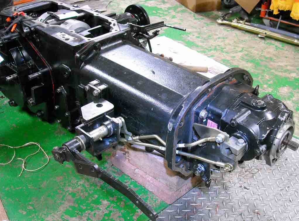

Here I have mounted the HST to the tunnel. Since I have to align
two shafts (main and PTO) to their spline couplers, I needed to make
use of the access hole in the tunnel again.
I spent a lot of time adjusting my two new controller tie rods to get
them just right. I am sure this is easier than after the bell housing
covers up the forward half of these shafts. After the bell housing goes
on, you have to make those adjustments through the bottom access hole.
I took apart the main pedal pivot shaft, but it seems OK.
I do not get why they use friction levers....I have never seen one before,
on any tractor or hyd equipment. The proper approach is a detented valve.
The spring action on the 3rd SCV spool is very strong....a friction lever
would make feathering harder, I would think. Why not disable the friction
brake on one lever and try that?

The Quadra-stat lever assembly moves quite nicely, it's the blasted cables themselves that introduce all the friction. I think Deere went with cables for cost savings since it's easier to route a cable then come up with a linkage design to go from the right fender to the SCV valves. As I recall, Deere wants $80 or more just for the cable, so your Surplus Center cable is a bargain.
I think the SCV ports may be SAE instead of metric. I don't recall finding any metric fittings in the kits based on the I.D. system Deere printed in their instruction.

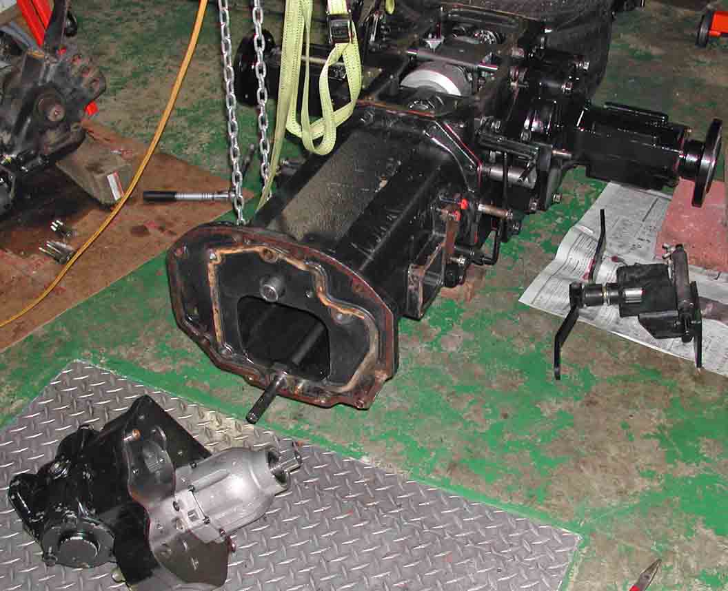

Now the bellhousing. This was quite easy, as this is a clutch-free HST
tractor. The only hard part was installing the HST pedal spring into its
guide after the housing was on.
Next, the engine.
