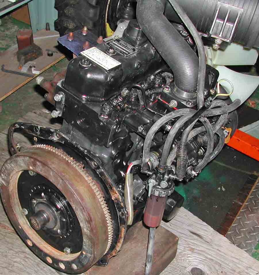

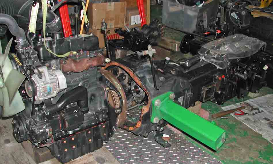

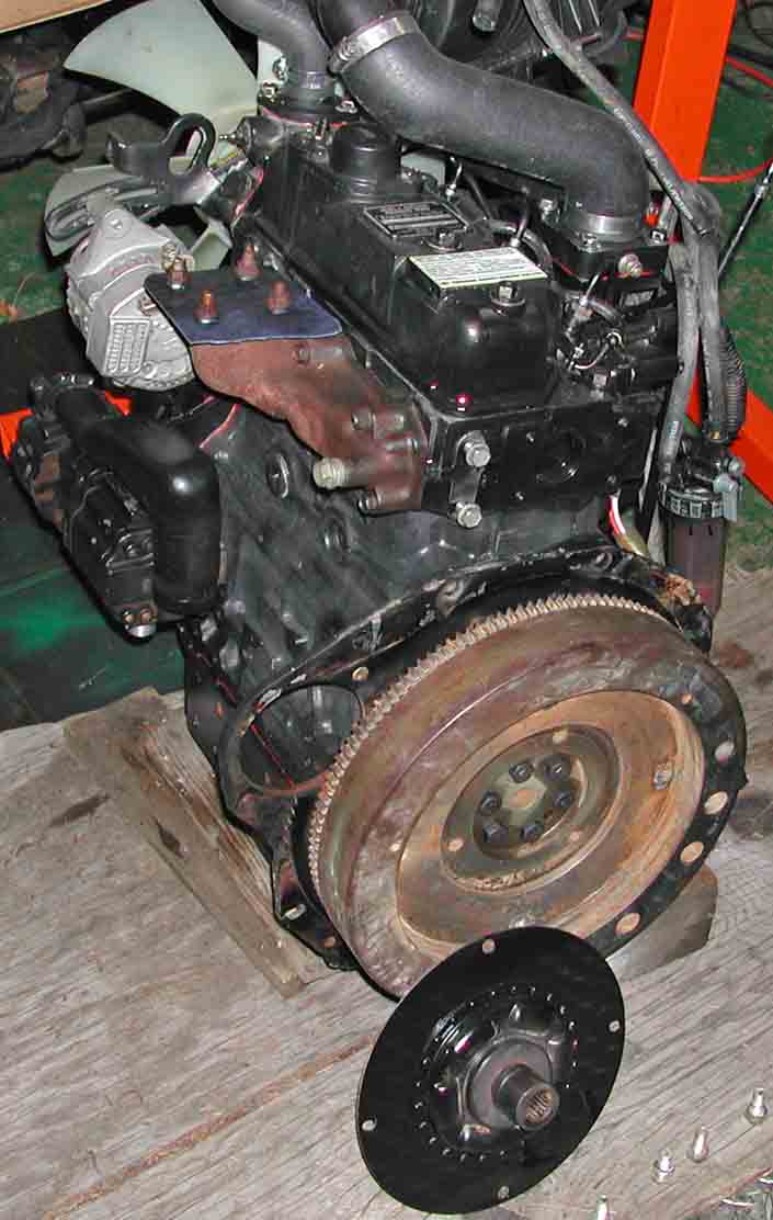

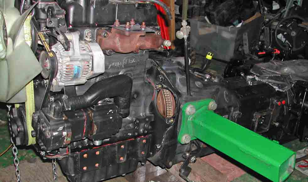

Now to install the engine onto the bellhousing.
Rather than mounting the engine first to the front subframe, I will use my
overhead hoist to lift and guide the engine onto the HST input shaft. I
think I can get finer control this way.
First I set up the engine by lifting it off the stand and mounting the flywheel
and flex plate (pix 1 and 2). The infamous flexplate has been replaced
under warranty when these tractors were young. Apparently, the rivets
failed. The flex plate is easy to see on a working tractor thru the open
bottom of the bellhousing. You JD owners, keep an eye on yours!
Next you can see me guiding the engine toward the visible HST spline shaft.
Murphy's Law says the splines will not line up perfectly, so I just brought
them together with the slightest force, then rotated the crankshaft using
the crank pulley bolt. At the slightest turn, it went right in. Easy.

What do you mean keep an eye on the flexplate? Also the inline filter for your power beyond looks like mine was it the older style? I have been listning to you and I have rerouted the fuel return hose, I could see where it was rubbing on the intake hose. Thats an easy mod to prevent future problems.
Several of the flex plates on these rental tractors failed early in their
service life. They are made like a sandwich of rubber and steel, and it
looks like springs. There are a bunch of rivets that failed, according to
reports. I never saw it. Look up inside your underside opening and you
will see what I mean.
My inline filter in the PB circuit is the first generation, as far as I know.
I also have the early style power steering cylinder and tie rods.

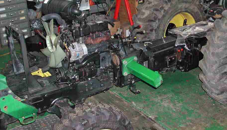

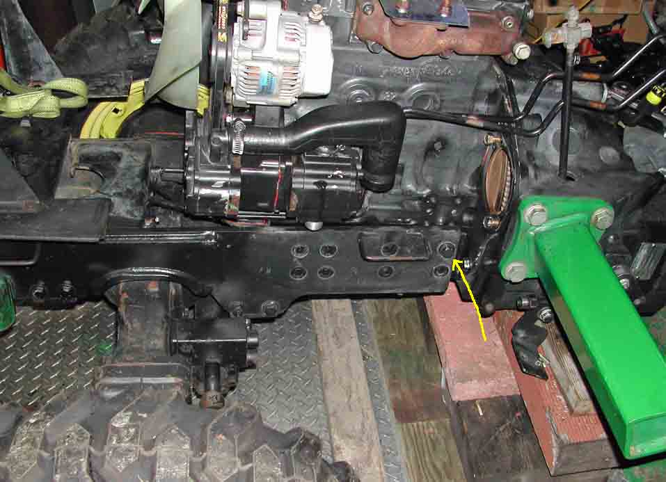

In these 2 pix, I am now up to a rolling chassis.
To connect up the front axle subframe, I manually rolled it up to the engine,
which was elevated to about a foot off the floor. It is easy to balance the
subframe over the axle and tilt it as needed to line up with only the rear
upper bolt hole on the engine oil pan. Once I got those 2 bolts to line up,
I snugged them up and lowered the engine to line up all the others. Easy.
