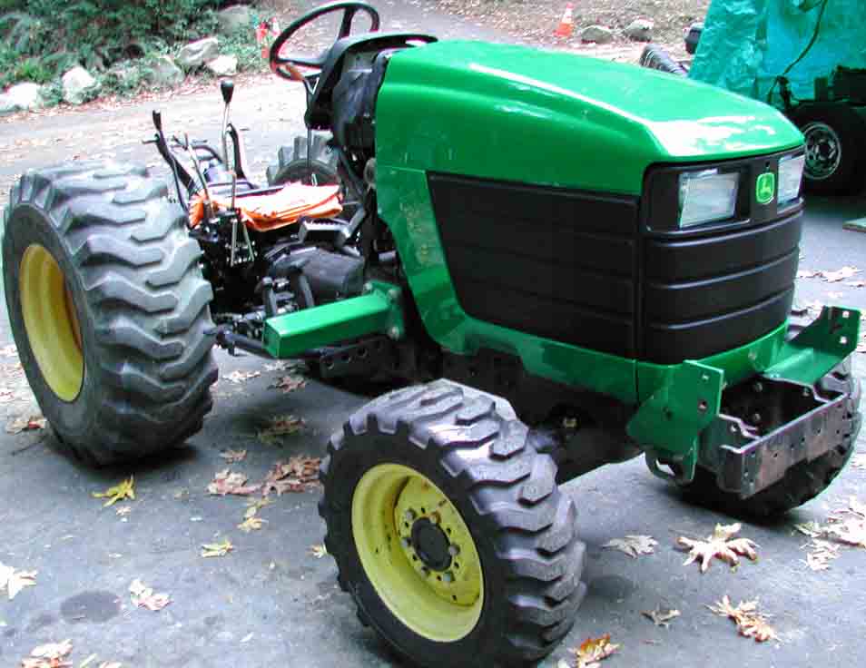

This photo is from my test drive yesterday. I still have to do a bit
more tweaking to get the hood, grille, and side panels to fit well, not
to mention putting new stickers on them.
Anyway, the engine starts super-easy...the starter engages for only
a second...and no manifold heat at 49 degrees in my workshop. I
drove it around a bit to see if I needed to adjust the HST controls...nope.
Got it right the first time (amazing). The range shift lever worked backwards
so I had to reinstall the shifter bellcrank in the correct orientation. (It was
a 50-50 guess, and I got that wrong.)
I have not been able to get my LCD hour meter working after taking the
instrument panel apart again, so I am thinking of adding an aftermarket
mechanical hour meter. That keeps me from putting the cowl back
together for a while. The rear fenders and seat will have to wait until
I complete the changes I am making to the hydraulic system.

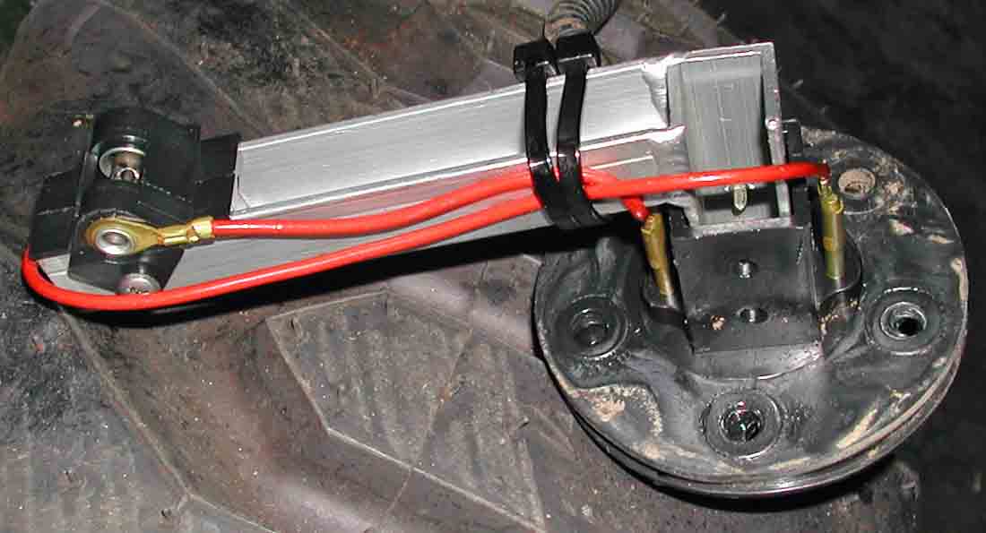

I also discovered the float and arm are missing from my fuel level sending
unit.

   / John Deere 4300 complete rebuild #326
It's sure looking good! Nothing like it did when you brought it home.
Any plans to show the rental yard what it looks like when it's done?

Oh, you bet! My main contact there has seen an interim photo, but I
will send him a more complete shot with all those shiny green panels
installed.
BTW, they are now in the process of replacing their 4300s with Bobcat
CT335s, and they just had the first two delivered last week. (Plastic body
panels, foot clutches, and aluminum rear end castings are incompatible with
rental operation.)
