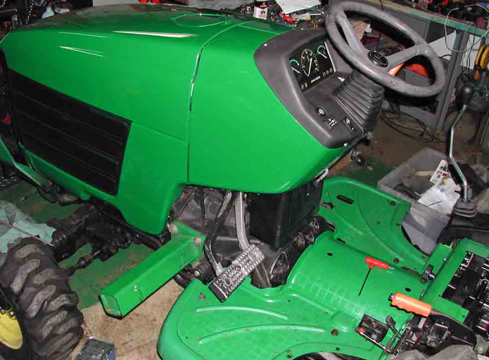

Well I got all my new plastic body panels installed. It has certainly taken
some serious adjustment to get them fitting well. They look very sharp.
The rear fenders are original, so they won't be as shiney. The only
original plastic panel forward of the seat is the right cowl and the instrument
panel.
I will show the right side tommorrow.
   / John Deere 4300 complete rebuild #349
panel.
What a difference from the hulk you brought home! Any idea what your costs have been so far?

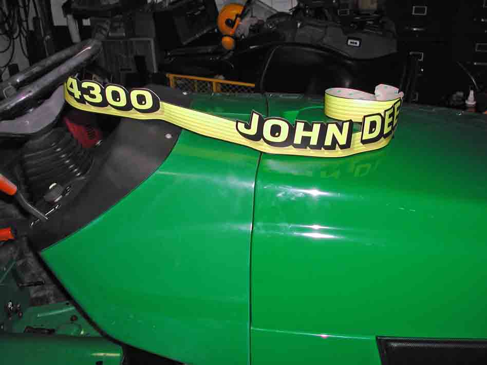

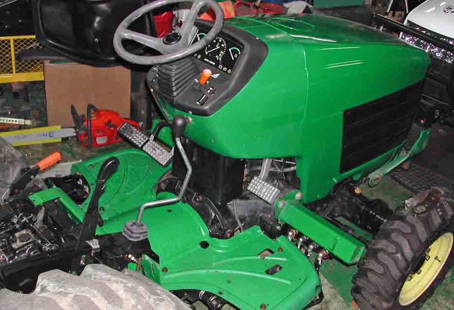

Here is the right side as it is now. The cowl panel is the only original
green plastic panel in the forward area. It looks much better now, but
you can see that it is not quite the same shade of green as the hood
and side panel. I tried polishing compound and a rag, then I tried my
buffing wheel with rouge polish. Glue from the old labels, I removed with
lacquer thinner. If anyone tries this, the thinner will dissolve the plastic.
If a power buffer is used, it is easy to embed the polish in the surface,
causing a stain. I removed the stains carefully with the thinner. It
looks OK, and will look even better when I put the new label on.
The second photo shows the label. I won't put it on until I can warm
the panel up a bit. It is in the 40s in my shop and I am concerned about
how well the plastic labels will adhere if mounted when the temps are
too low.
Meanwhile, I will have to remove and reinstall the floor due to interference
with the go pedals at full swing. I am probably close to $5000 into this
build, with no anticipated significant expenses left.
