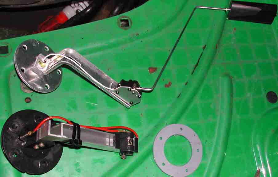

OK, it's been more than a week, and I have had tree issues to deal with.
I did order a new fuel level sender, and installed it ($55 total cost). It
is certainly different from my early dead unit, which looks like a prototype.
I tested the new one before I put it in.

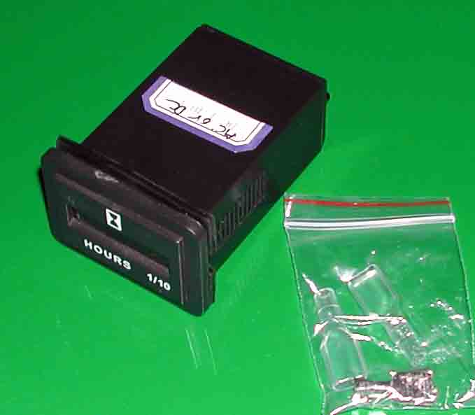

I went analog on the hour meter, now installed ($15). I could have bought
a used panel for $75, but the hours would be wrong. Better to start this
tractor's rebirth at 0 hours.
