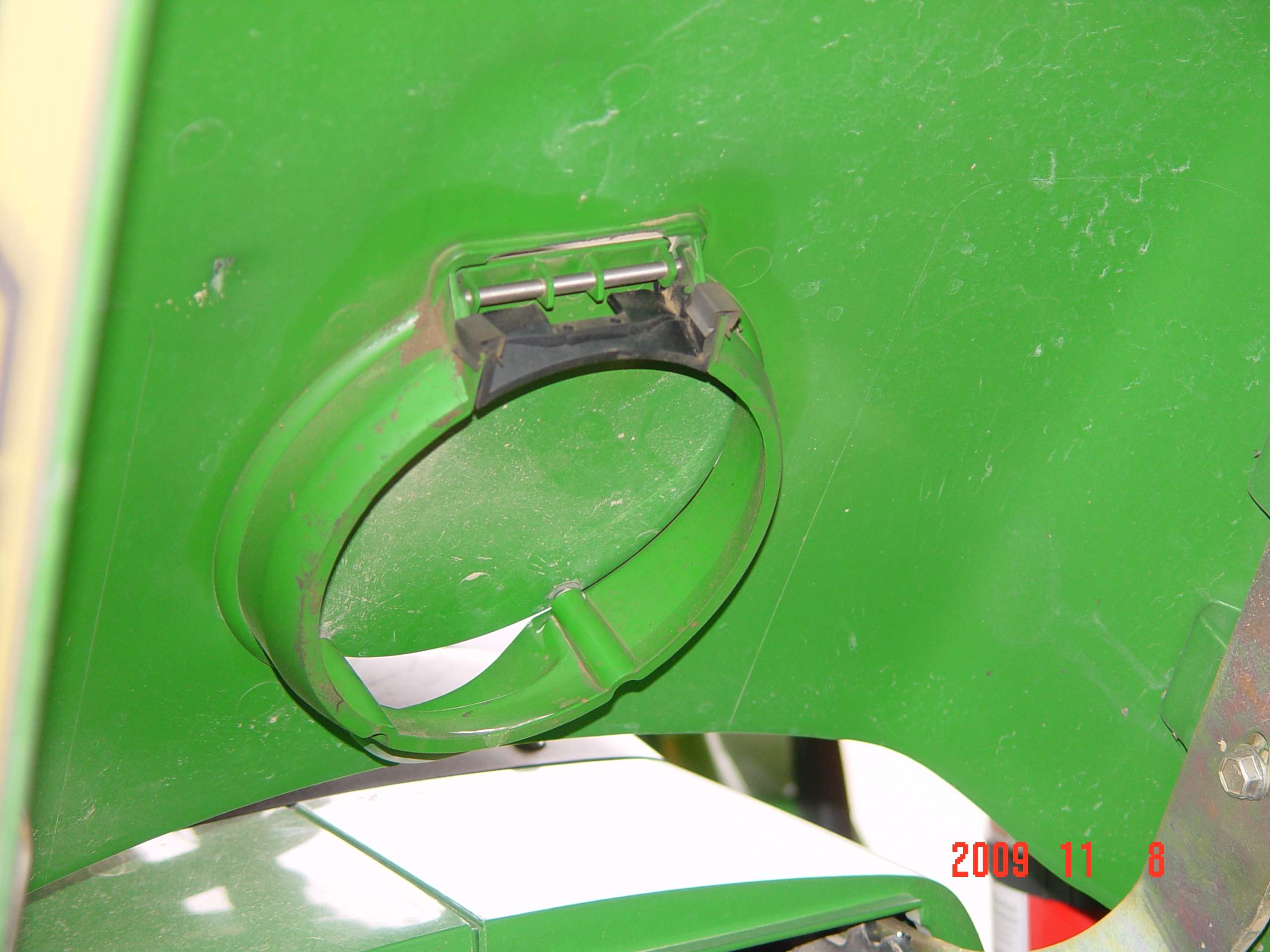

I've got two clips that go in from the bottom which hold everything in place.
Very interesting, Wayne. I see how yours works to hold the door by its
hinge pin. But that leaves no place for spring(s) to hold it closed, like
Kenny has. And if you use Kenny's setup, there is no way to fit that
black plastic clip. I see the plastic clip in my parts book (19B), but I had
no idea that I needed it. I suspect the dual springs approach may be a
newer attempt at a solution to hold the door closed and not rattle. I
imagine that yours rattles like Matt's does. So I wonder why my latest
model hood can work with only one spring....
I guess I will make something that works like your black plastic piece, but
with a hole so the spring can be used, too.
Thanks for the pix....they were quite helpful.

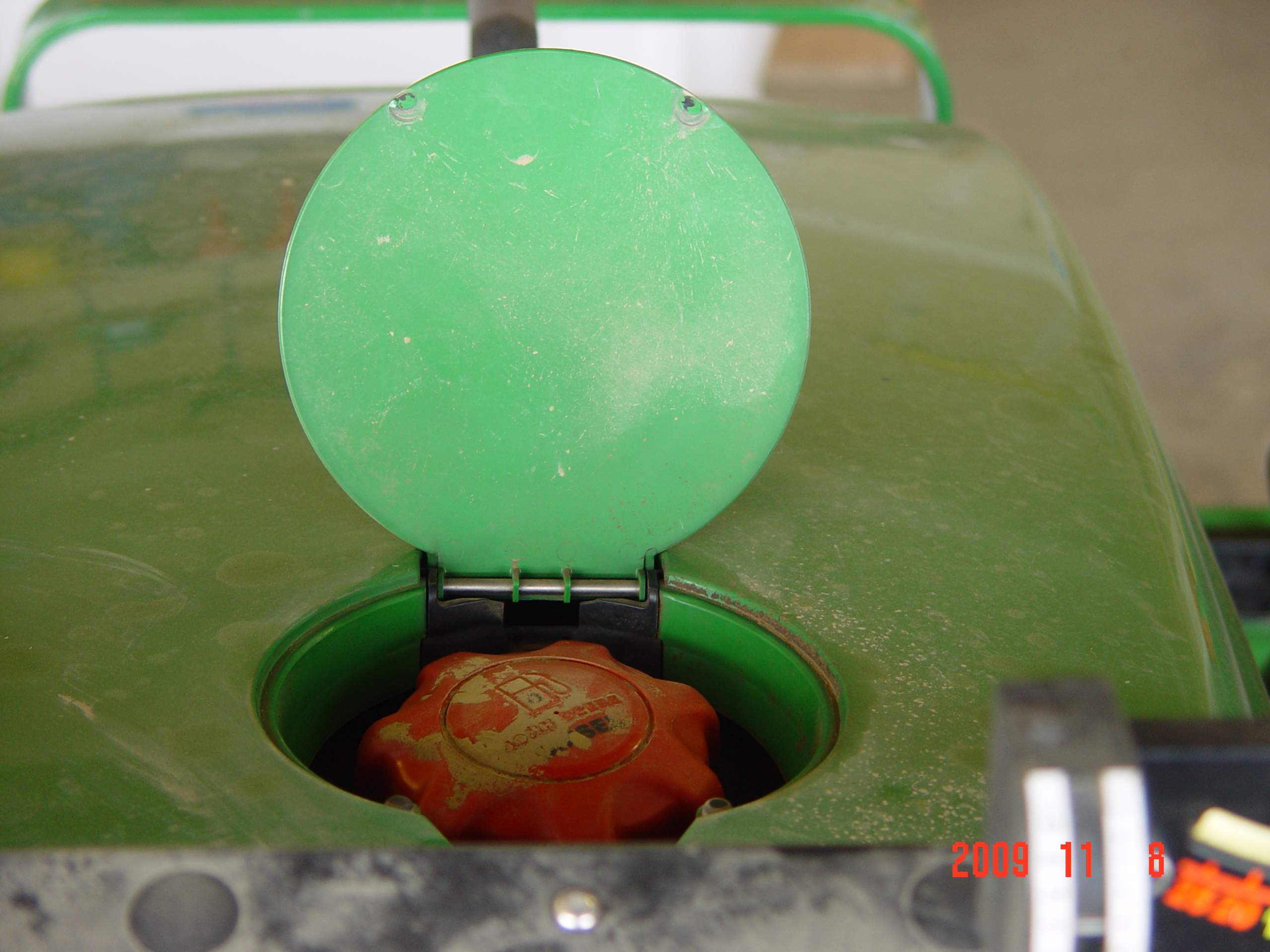

Yea, my fuel lid hinge does not rattle at all, although only gravity is holding it in place. I'd think the springs would be something else to break. The only time I've seen my fuel lid lifted is when I trailered it.
Good luck
Waynd
   / John Deere 4300 complete rebuild #308
WayneH beat me to the punch with the fuel door photos. His is the same setup as mine. Gravity holds the door closed and the two rubber bumpers keep it from rattling. I've had it blow open if a strong wind catches it just right.
I'll post the photos since I shot them this afternoon; but Wayne's fuel cap is cleaner than mine.

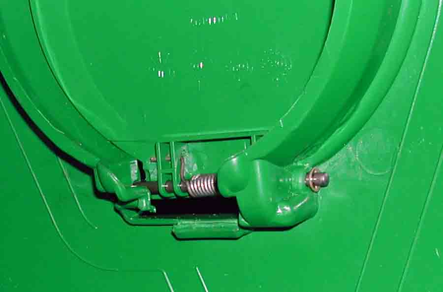

#310
...Wayne's fuel cap is cleaner than mine.
Well, tractors are made to get dirty. Thx for posting. Here is my
solution. I am not using the clips or spring, and I am certainly not going
to order that last plastic bit. I tossed the hinge pin, and dug up a longer
piece of 3/16 rod. I drilled thru the hood to accommodate a longer hinge
pin....this kept the door secure. Then I dug up a torsion spring (I have a
lot of crap around here, some of it useful) and re-bent the ends (with
heat) so they fit into the existing spring holes. Works great!
