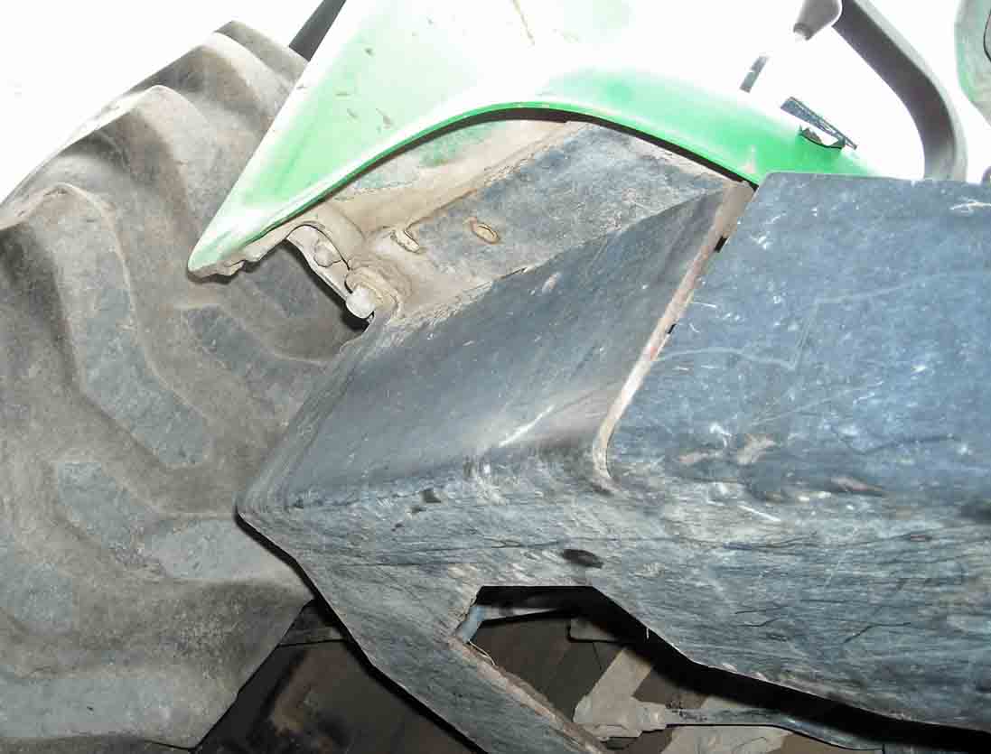

I went to look at some of the rental 4300s yesterday. I was wondering
why the mounting position of my floor pan keeps my GO pedals from
completely articulating. It sure seems that the pan needs another 1/2"
or so of height off the mounting points...at least on the right side.
Well, look at this: it looks like another rental tractor option from JD.
Under-floor armor to protect the hyd hardlines. My tractor has endured
some impacts there.
BTW, this tractor has 2709 hours on it!

JD did in fact have a "rental upgrade kit" for those machines...
Yes, we talked about it when I posted pix of the hood armor. I wonder:
does one rental upgrade option include all the bits and pieces? In addition
to the hood armor, I discovered some rental options to the range
shifter mechanism. There are probably others.
The under-floor armor looks very desirable.

Good question...to my knowledge it's the hood armor, C-range lockout, and the stuff under the machine.
